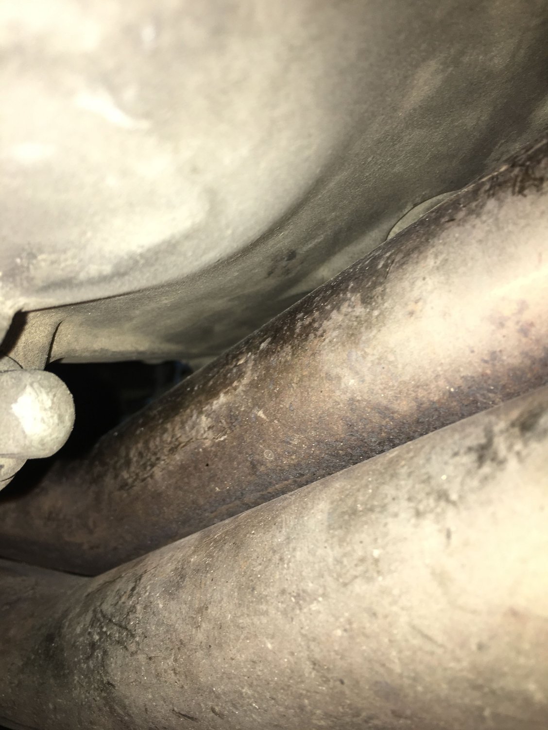

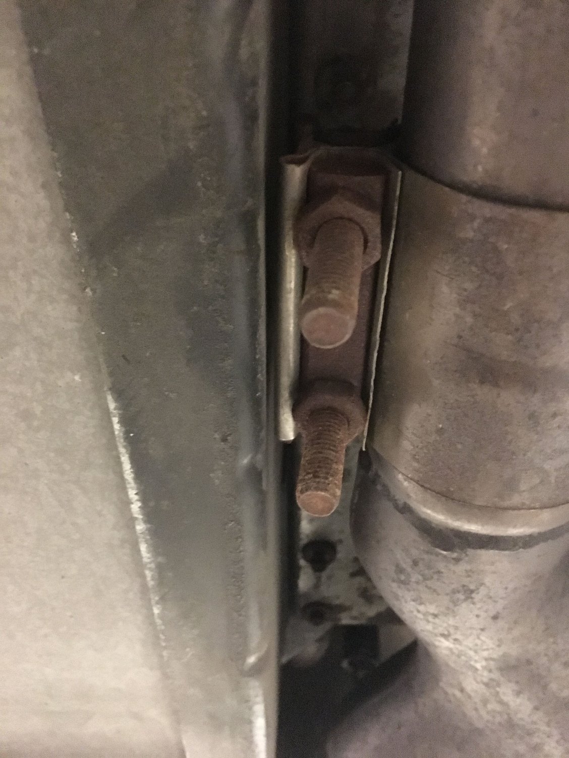

Ok. When I did the engine swap I didn't drop the drivetrain. I just pulled the engine off the TT. I only unbolted the bellhousing at the engine.
I got the car up on lift now. The exhaust isn't moving much when I pull down on it. It is close to one side of frame though. Maybe rubbing. Driver side headers also seem reall close to bellhousing. See pics.

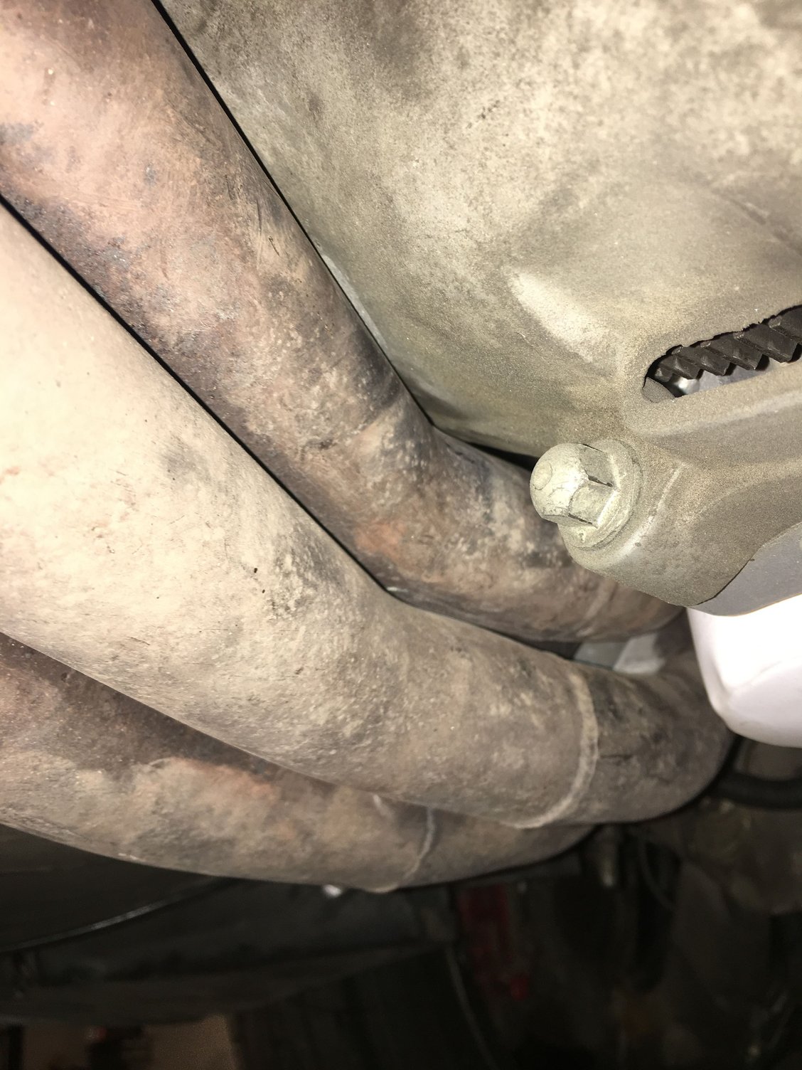

This is the other side. A lot of space. Hoping this is it. They are not even.

That is very possible. Hopefully others will see this and comment as well. Better yet, see if you can correct it and take it for a drive. If vibes are gone, you're good!

Yeah I'm gonna try and adjust it in the morning and drive it. I can't even get an index card through the gap.

Yeah. I think I had an exhausts leaks that was causing the exhaust to vibrate. I took it apart and put it back together with new gaskets and tightened everything really good and I don't feel any vibration except the usual stick shift vibration. On vacation this week but next Monday taking it back to tuner. Will let u know how it goes. Thanks
