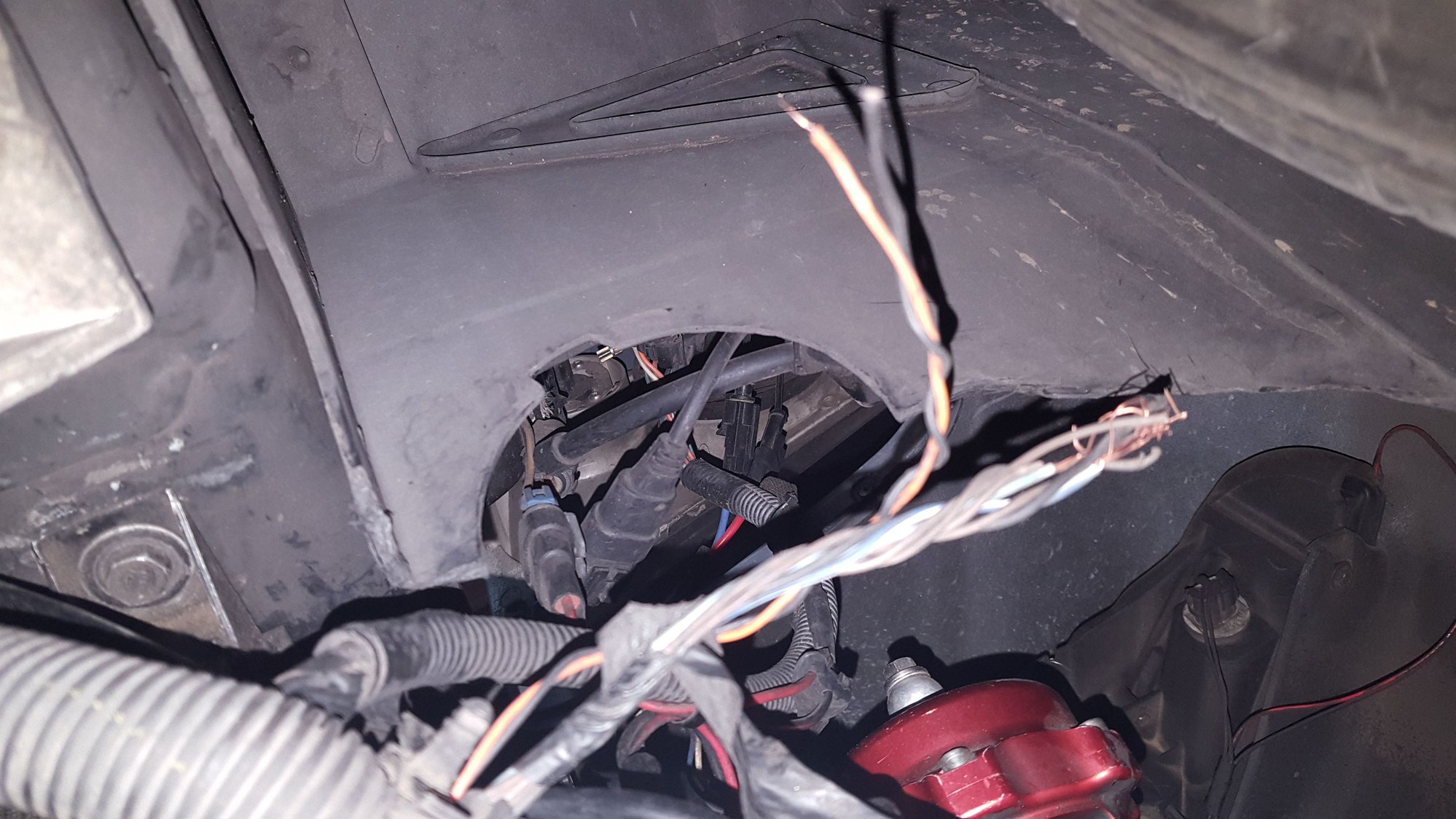

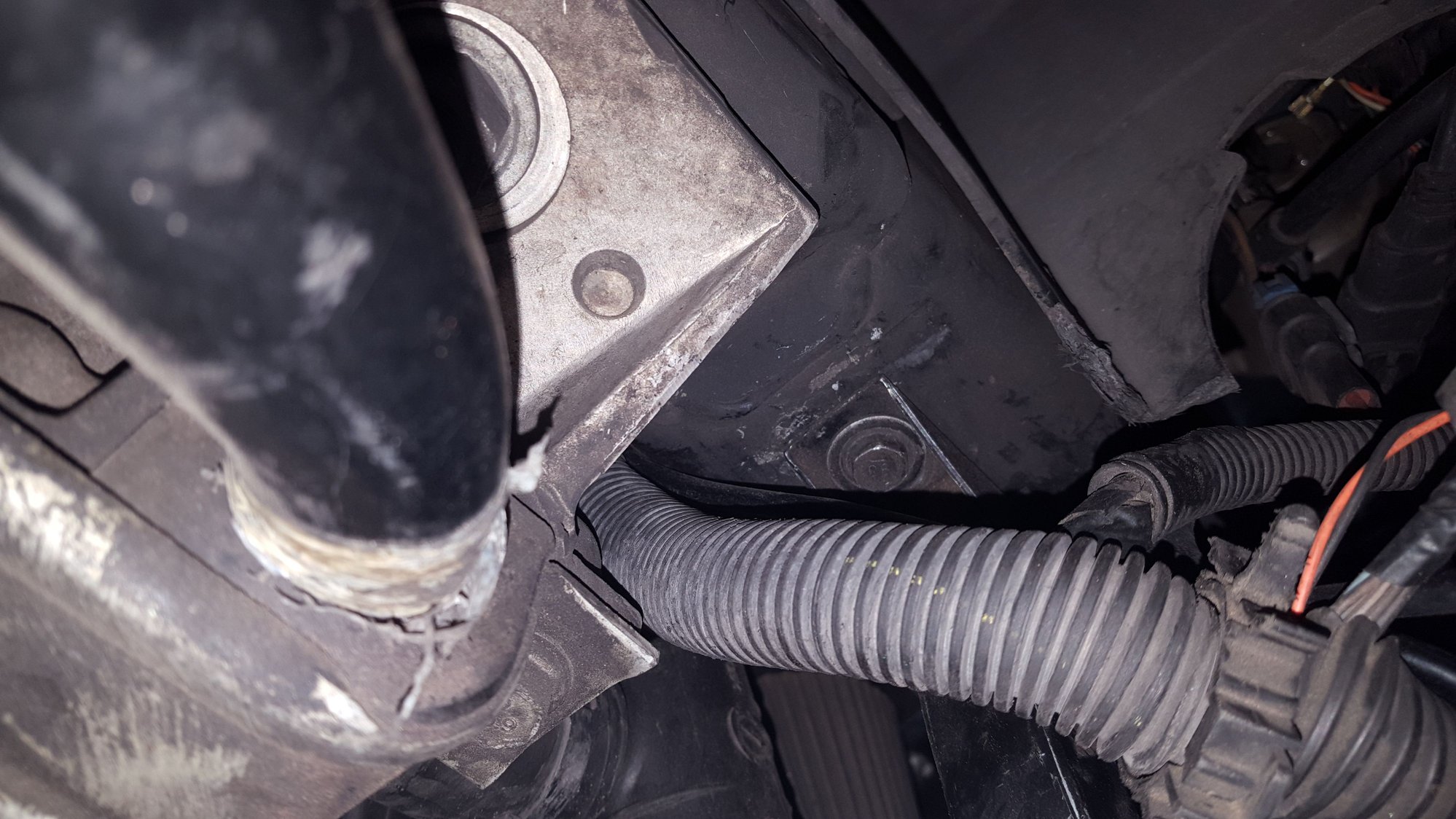

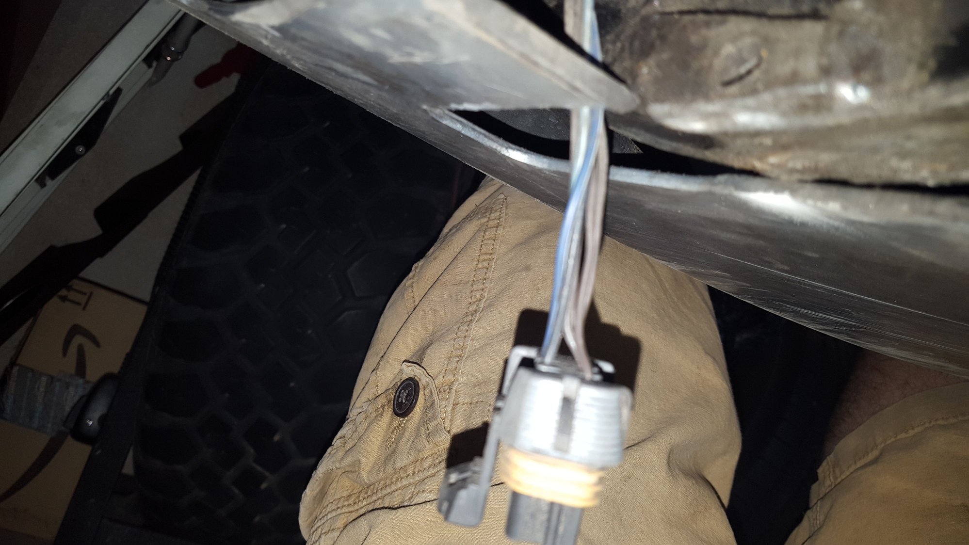

Lets get this out of the way first This was operator error. I was in such a hurry to drive it after God knows how long I forgot to route the wires correctly and jacked them up. There's 2 sets of wires coming out of the harness.I know one set is for the turn signals and drl. So what connectors do i need? The 7 wires that are stripped and bundled definitely go to that plug pictured. But where does the brown and orange get plugged into? I know the 7 stripped wires for the drl/turn signal because A the plug that is intact goes to them and B I have no signals or anything in the front. I cant figure out where the brown and orange(it looks yellow as you view this nut its orange i promise you that) go or what plug it is. I dont want to buy a harness. Alao the harness where the wires are coming out is right above the lower radiator hose. All help and fun making is appreciated.excuse the typos im typing and taking pics on my from under the car

I found the male connector or I should say I emailed Mouser electronics with the plug above and they gave me the correct p/n for the other side. For those of you that ever need it here it is.
Connector=829-12047931-B
Terminal Pins=829-15344866-L
Seals=829-15324981

I still need to know where the black/orange wire go to please.

Still need to know where that orange/black wire goes..anyone?

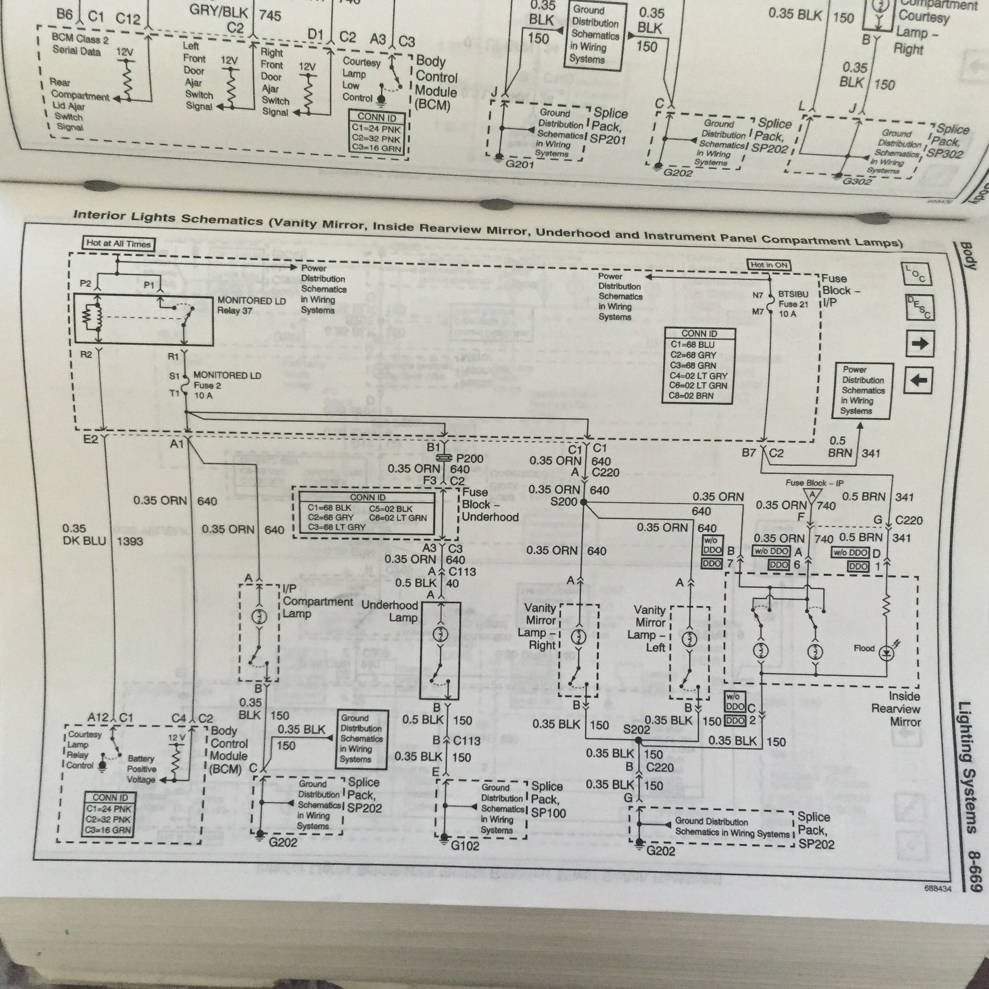

is it the under hood lamp?... looking at the wiring diagrams that's the only thing I can find with 2 pin orange/black wires in that area

I think that's it!!!!!! I have a different hood so who knows where I tucked it.. thats gotta be it!!! It comes out right by the radiator and I literally stripped all the other harnesses looking for it. The diagrams I was looking at were the wrong ones I kept seeing turn signal indicators and other things. THANK YOU SOOOOO MUCH!!!!

Yup that's it..I wasn't even remotely on the right page when I looked

Just an update everything is fixed. The only issue I had was the rubber seals are to big but I just sealed it up with liquid tape then wrapped it in electrical tape. All lights are working again
