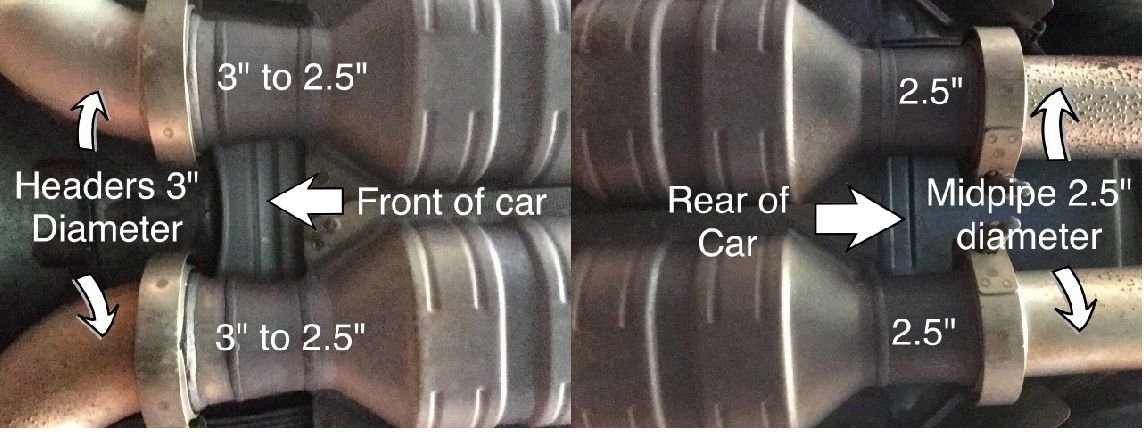

Just to make sure I make this easy. I need high flow cats with a 2.5" opening on both sides right? (they don't appear to make 3" inlet w 2.5" outlet) Here is what it looks like now with current measurements.
Catalytic converter measurements
Those don't look like factory units to me ... the video I questioned it, pretty sure now that I've never seen stock units like this. Regardless, looks like you're right. Do you have verniers to confirm diameters?

No I do not have that type of measuring tool. I simply wrapped a vinyl tape measure around for circumference to get the diameter. I'm probably just going to remove my front spoiler and take it by my muffler shop and let them see it to make sure I order the right size. They may find it easier to have a 3" inlet lined up to the headers then neck the outlet down to 2.5" to the midpipe. We'll see.
