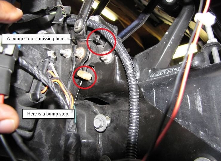

Just purchased my first Corvette. 2002 Coup-drove it 400 miles home and the only 2 issues I had was:
1) Clutch Pedal did not return to up position twice. Placed toe under pedal and pulled and it poped right up. Has only done it one other time. Slave cylinder is not leaking and full of fluid. Could the pedal spring be weak or out of line?
2) Driver Headlight will go up and down. When it goes down the motor runs an additional 3 seconds. Can this be adjusted?
thanks for any help.

Sounds like the gear in the headlight motor needs changing....not a bad job to do.

2) The headlight gears do not have a "limiter" inside of the motors themselves; there's a worm gear and the gear for the motor and they just turn as power is applied. The only thing that limits their travel is the power that is applied to the motor and physically small little bumpers on the headlight motor housing. I would check the headlight bumpers first. What happens is that over time the bumpers, being molded plastic, get indented which makes the gear travel further. They could also be missing, which is common as they sometimes fall off.
Even despite this there is a high likelihood that the gear in the motor is worn out. I recently rebuilt my driver's side headlight motor and have a thread on it (with you having a 2002 there will be some alternative steps involved);
https://www.corvetteforum.com/forums...ick-guide.html

Default Pictures
Sorry to be so late posting.
