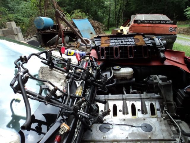

It's not really all that hard to remove the inake manifold.
Plus you'll get the opportunity to clean stuff up a bunch..
No regular shop will do the "little things" like you would to your own car.
Good Luck

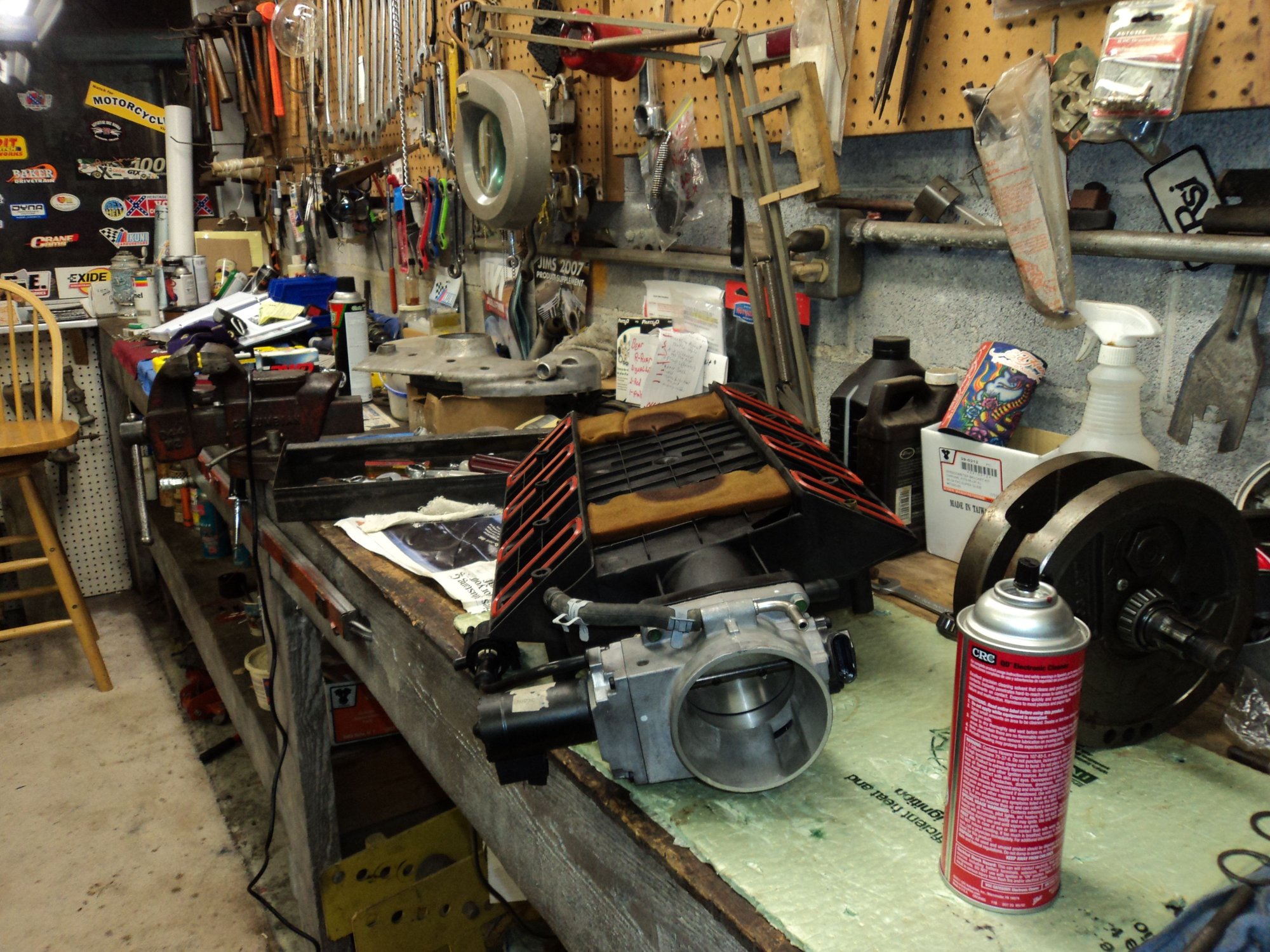

Replaced mine twice in past 5yrs, and agree with Foggy on the cleaning. You would not believe how much dirt and crap under the Intake, and all the oil inside it. Would also add a catch can after cleaning it. Some were on the forum is an article on using/adding extension to the OPS. Use the CF search.
Replace your gaskets.
take you time, bag and tag all your parts and nut/bolts.
don't remember the taque.

2001 Base 6 speed....Occasional driver. When I pulled the intake it was full of oil and dirty....Google CCA oil catchcans......OR information
https://www.corvetteforum.com/forums...-from-cca.html
