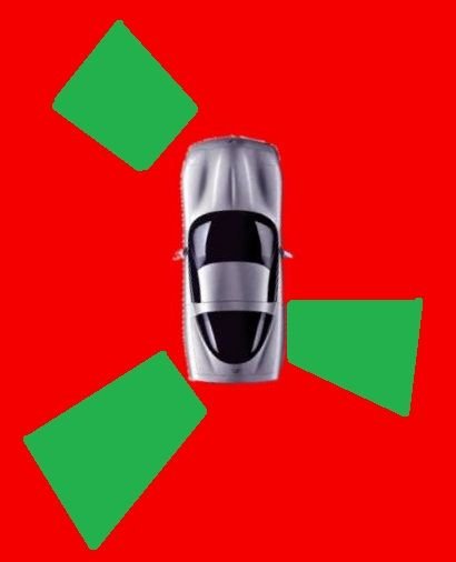

I have read about every post I can find on here (maybe I missed a couple) but all the key fob problems seem to be:
1. Usually a battery problem
2. Bad connections inside fob
3. Wrong fob
Mine works fine but only from certain directions from the car and under about 15' distance.
The batteries are new and I checked them with a voltmeter to verify power.
The fobs work only in the green areas of the picture......
Any help would be appreciated...

First, the receiver for the fob is just above and slightly in front of the driver side rear wheel. That might explain the green reception areas you've shown. Second, while you've tested the batteries, you might still be suffering from the fob cold/broken solder problem. I'd suggest you resolder your fob as shown in this thread. https://www.corvetteforum.com/forums...em-solved.html Lastly, you might just try this for fun. It appears that it really does work. There are other videos that show this same thing and many others that offer suggestions for increased range. GL and let us know how it goes.
