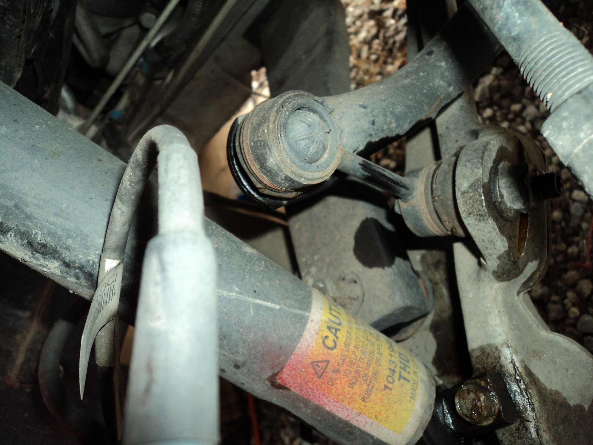

Not to hard to do, some moving sway bar to get to bolts. I took both sides off then replaced with new metal one from Cultrag parts house 484-334-8833
this is pic of new install
pic of old one, used liquid wrench then wrench with socket.....
IF they spin use a wedge of sorts and put pressure on them.......
