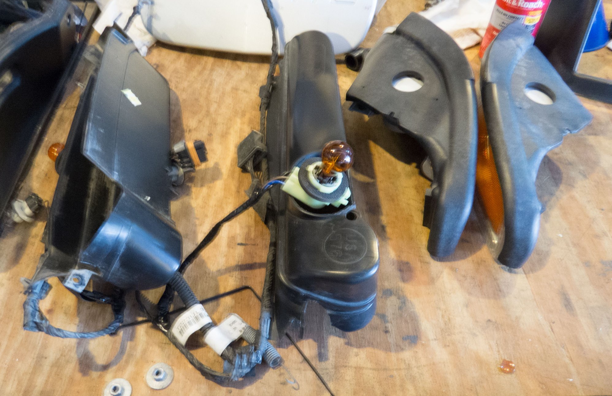

As the job progresses and I keep learning.
Got all set up on my fastly assembled work bench. ;-)
Did order new light sockets for the DRL along with LED bulbs and resistors. Found the OEM.s to be in pretty bad shape.
Did get the broken tab repaired enuff to work even though it's not pretty.
And have epoxy on the crack and blimish on the nose section.
Today. some sanding and see where we are at.

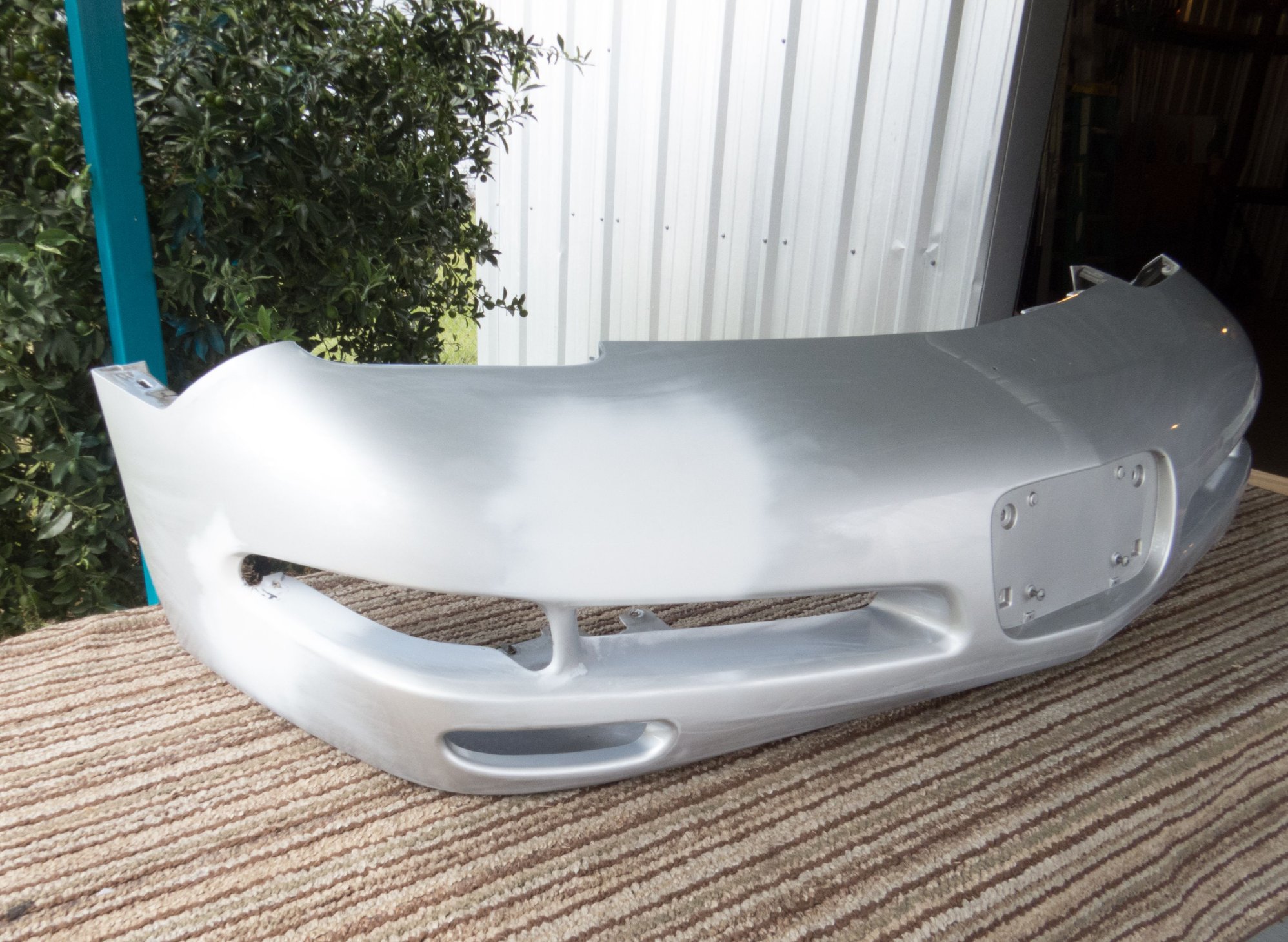

Slowly but surely coming along. If it would not be so darn hot in the afternoons, I'd be more excited about working on it. But, kinda waiting on the replacement headlight cover to come in so I can do the finale painting at one time.
Nose ready for a totally sanding and finale priming.
And Received the new sockets for the Daytime/ Signal lights. Was gonna go LED but changed my mind .
Tomorrow, hopefully finale sanding and finale Prime finish coat.

Nice job. How did you do the paint?
Old Oct 23, 2017 | 01:22 PM
awches's Avatar
awches
Joined: Aug 2016
Posts: 667
Likes: 162
From: Jennings LA
Repaired cracks and damage, then overall sanding and cleaning, then a couple coats of primer, fine wet sanding, cleaning , 2 coats of Base , a fine sanding and then a coat of clear. Wrong move on the fine sanding and clear as you could see the sanding marks.
So , another coat of base, then 2 coats of clear.
Still needs to be worked on and not quite a perfect match. I'll be going over it with some super fine wet sanding and then compounds and polish.
totally used one pint of base.
