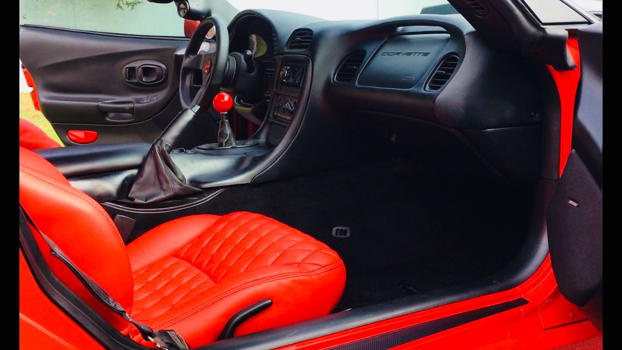

Guys..I just did a full interior conversion from Light Oak to Red/Black....In the process I decided I want to do away with the power seats all together...The Red ones I picked up are out of a C5 Z06...The passenger side is already manual...Drivers side is power...Now I already searched and found that I can pick up another passenger side manual track...However I would have to cut off the seatbelt receiver ear and weld it to the other side on the track....I'd rather avoid that..So my question is this...I've found a few threads saying that C6 seat tracks bolt right up to C5 seats...And that the C6 seat tracks have the seatbelt receiver ears on both sides of the track...Will a manual passenger side seat mount onto a C5 drivers seat?...Want to make sure before I buy one..Thanks..
