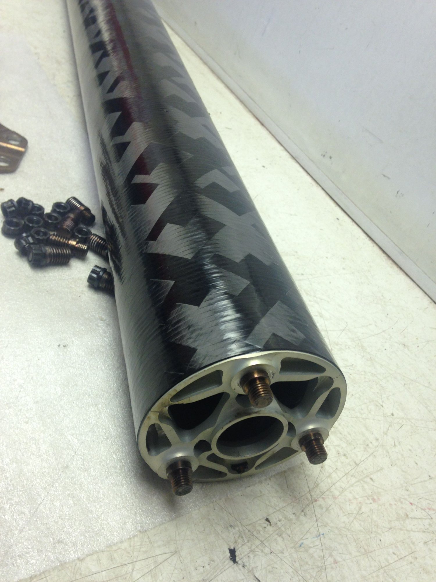

He is likely looking for the studs shown here:
I tried Fastenal without luck. AFE does not have a part number or source.
I would run a stud not a bolt as the flex disk rides on the shank with tight tolerances. The nuts also have to fit inside the ends of the torque tube.

The original hardware appears to be custom made. All I could suggest is finding 12 point bolts the correct length and then finding a small sleeve that will fit. Another possibly is that you could find shoulder bolts which fit.

Thanks for the help guys. Here is a close up picture I have. I've also contacted ARP to have them custom made. They want ~$100/piece and will match the material if I send them one in to do a hardness test.
If I order 100 or more the price may be closer to ~$30/each.
