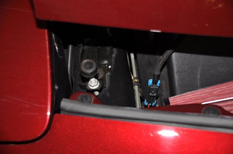

You can also check to see if the previous owner unplugged the under hood light. Connection for the lamp is located along side the radiator shroud on the right hand side.
Here's a picture from the front of the car looking down along side the radiator.

Thank you for your help, was #2 fuse.
