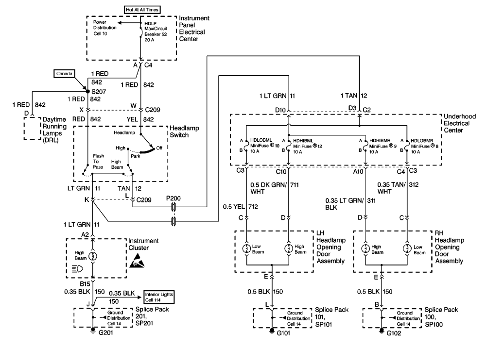

A multimeter and the electric diagram in Post 4
