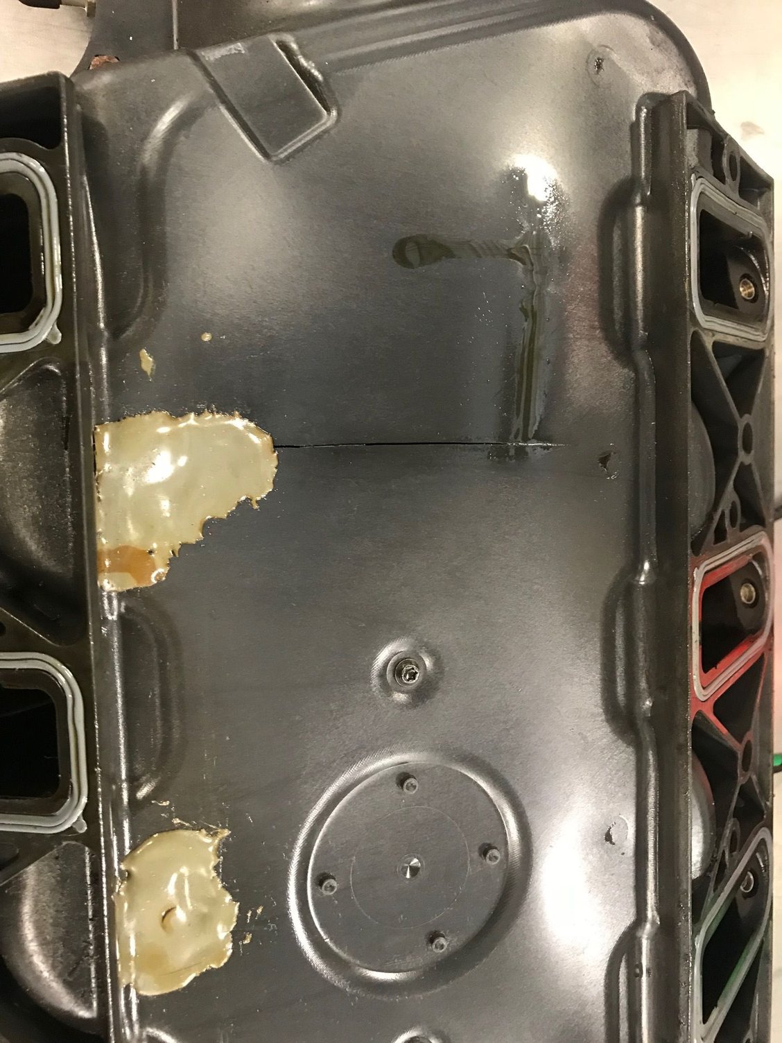

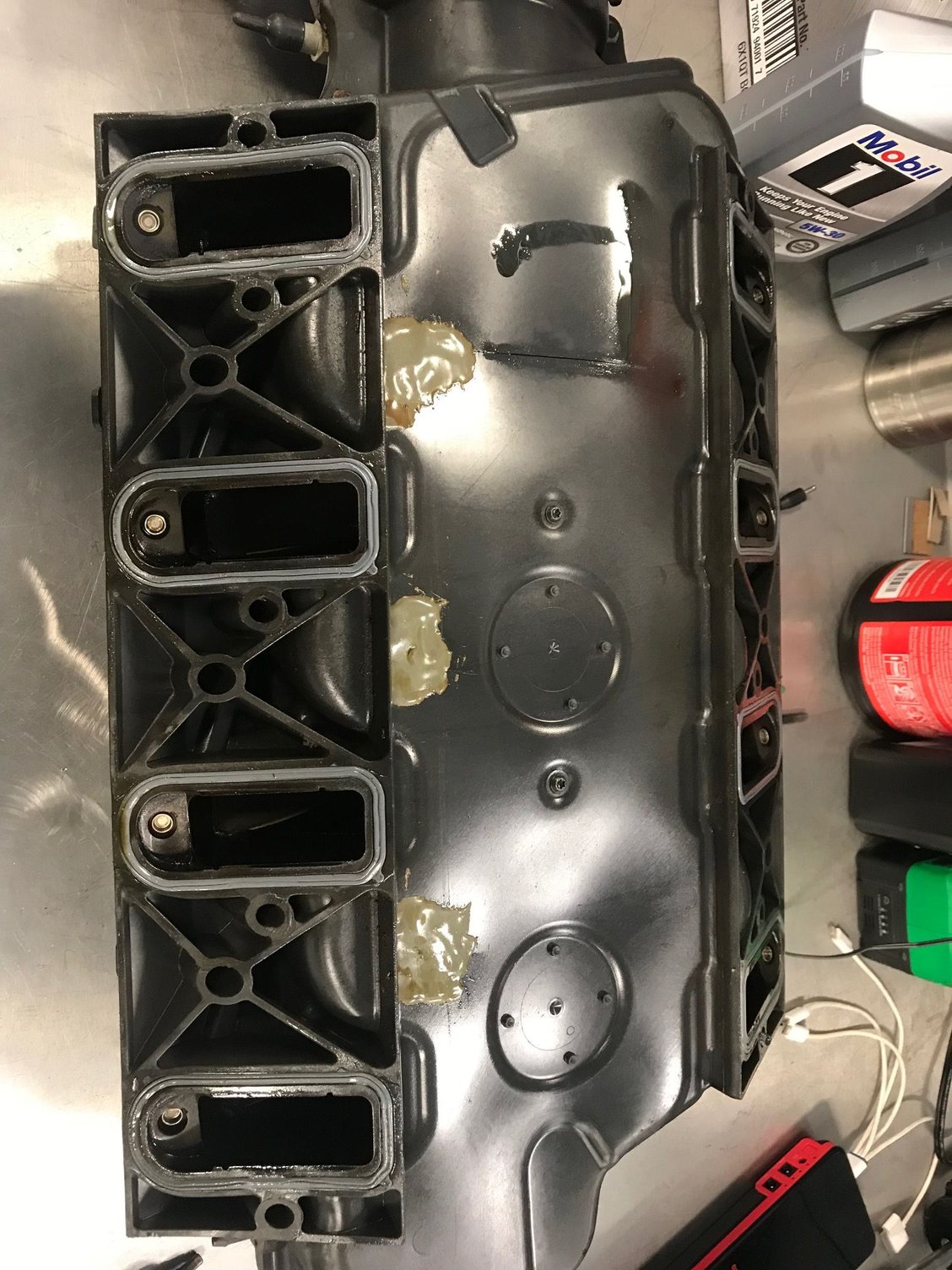

Cracked FAST 90 = Massive Vacuum Leak
This is just an FYI post...I just picked up another FAST 90 from a CF member that lives about an hour south of me. Thanks again brother!
Sooo...it looks like either the previous owner, the original owner or a mechanic likely over torqued the bolts or used the wrong bolts during install and cracked the intake. Did they replace it? Nope! The cheap bastard simply epoxied the cracks. It became my problem when the epoxy repair finally failed. My RPMs were crazy erratic, idling super rough and shaking and when cruising it's like the cruise control was on. As soon as I let off the brake it would jump to about 2k. My amazing Vette Tech troubleshot it, talked to my tuner, smoked the intake and found the leak.
Check it out...

make sure you have button head bolts on the valley cover otherwise it's highly possible the intake will crack on the bottom just like your pics

As mentioned above, you did switch out the valley cover fasteners for the low profile button head units that would have originally came with the FAST when you installed the new to you replacement manifold, correct?
http://www.jegs.com/i/FAST/244/54018C-KIT/10002/-1
They are the ten (10) button head fasteners shown in the upper right hand corner in this photo;
