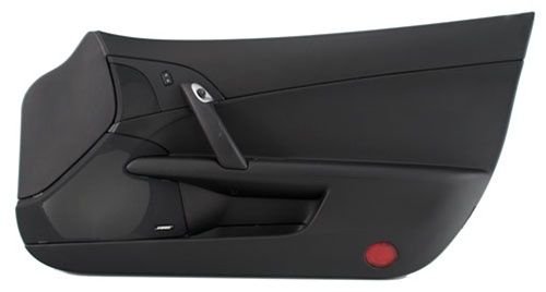

I didn't see a plastic tab so I don't know where the bolt is this is what my door panel looks like. Sorry if this picture is huge, I'm on mobile and don't know how to edit the size.
Edit: the top of that flat portion is just the window switch, but there isn't any type of cover anywhere.
If your door panel look like the one pictured then you need to be in the C6 section.
