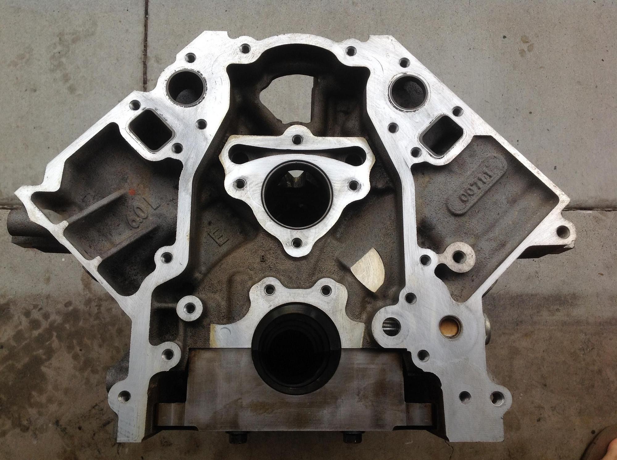

If it is a LS2 you maybe able to see 6.0 cast into the front passenger side of the block below the water pump ports.
Thanks! I'm really curious so even though it is 3 degrees out, I will look as soon as I get home.
