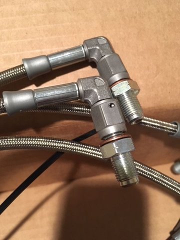

found a pic of my Doug Rippie lines before I installed them

Those are nice, checked them out and it sells for $139.00 plus shipping. Going to do the speed bleeders as well as c4cruser suggested.

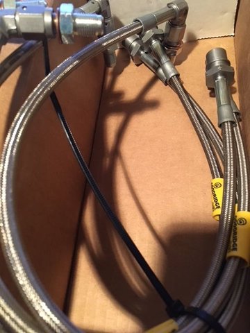

They came in today, looks pretty well made
