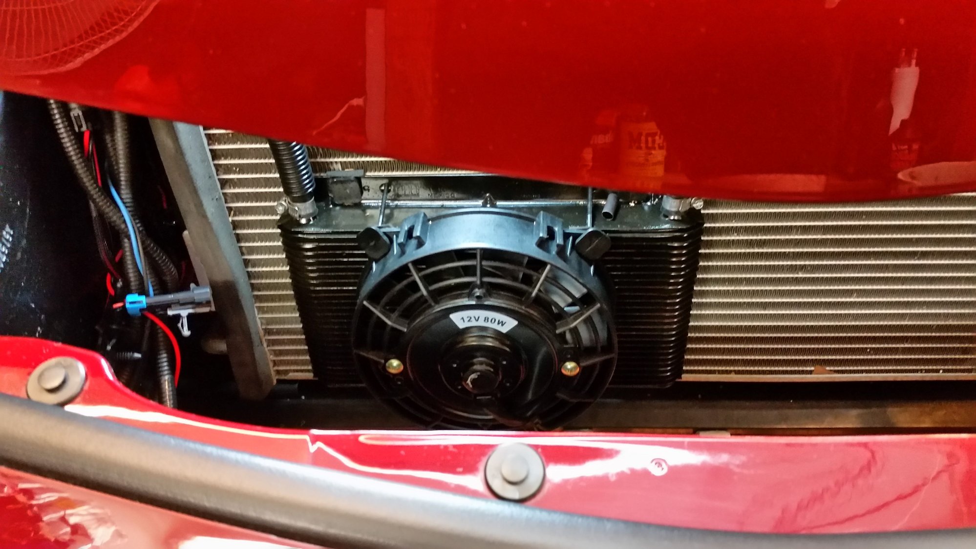

I installed the B&M 70268 several months ago in my 03 due to high trans temps. If I was to do it over I would order a larger size cooler but stick with the rigid stacked-plate design. Perhaps the B&M 70266 or even the B&M 70274.
While my install has helped I hoped for a greater reduction in temps. I also installed an electric pusher fan on the front of the cooler.
As to the install, I doubt the kit will have all you need depends on just where and how you mount the cooler. I mounted mine to the lower right side of the AC condenser and routed my lines up and over the top of the condenser/radiator stack but under the upper support. This did require some trimming on the bottom of the upper support to allow the lines/hoses to clear without being pinched. Connecting the lines to the upper AC line (return) on the side of the radiator requires either the correct size adapter for the AC cooler line where it enters the radiator. Or cutting the upper AC line at the location where it has a rubber hose insert and splicing in the new cooler line which is what I did.
Good luck with your install

Thank you very much. Great info and bonus for a picture!
I will take your advice and take a larger size. Might have to get rid of the stock airfilter set up too.
