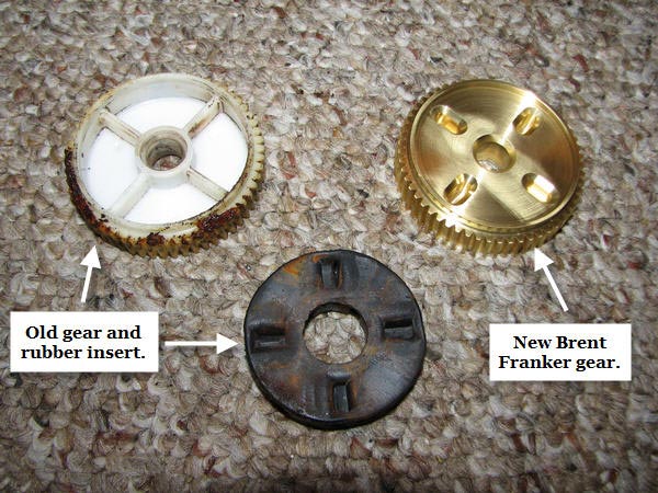

I have been having ACAs for years with no issues. However the other day I went to turn on my parking lights; first detent and the headlights pop up but not on! Turn switch all the way, and headlights come on like they are suppose to. Twilight option setting set to off also. It does it all the time now. Do not have a clue what it could be!

Bad MFS switch would be my guess.

first click popup is a known symptom of gears.
go with these:

Hey Thanks JDMvette! I went ahead changed the driver's side gear that was making noise after closing which was on my list. It solved all my problems! Don't know how it's related! So glad I did not order a MFS switch! SMH!
