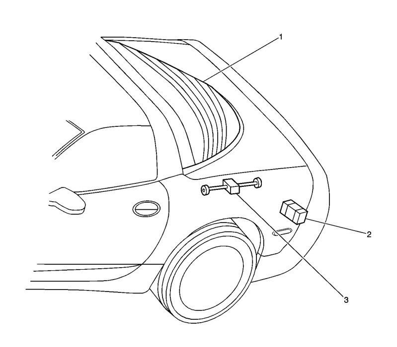

FOB receiver is located behind drivers seat

The fob battery might be weak. As the previous diagram shows, the receiving antenna is located near the drivers rear wheel. If the doors work when standing near the driver's rear wheel but not on the passenger 's side (because it's further away), that would point to a weak fob battery which is limiting transmission distance.
