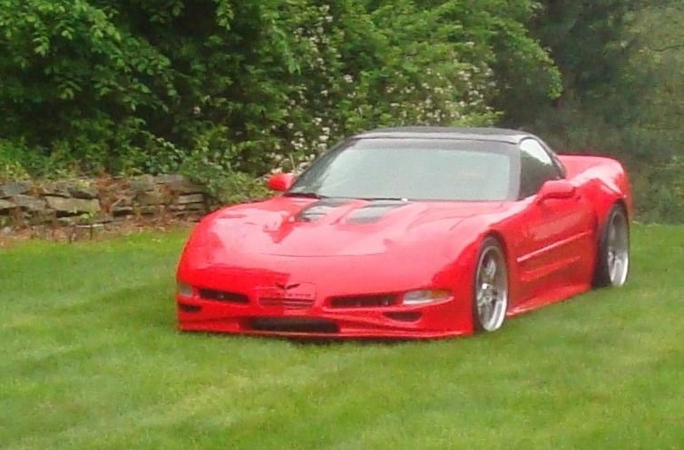

Heres something similar that i have done to the front plate,it helps out a lot especially if your trying to cool down a car with a turbo or supercharger.
its a must.
