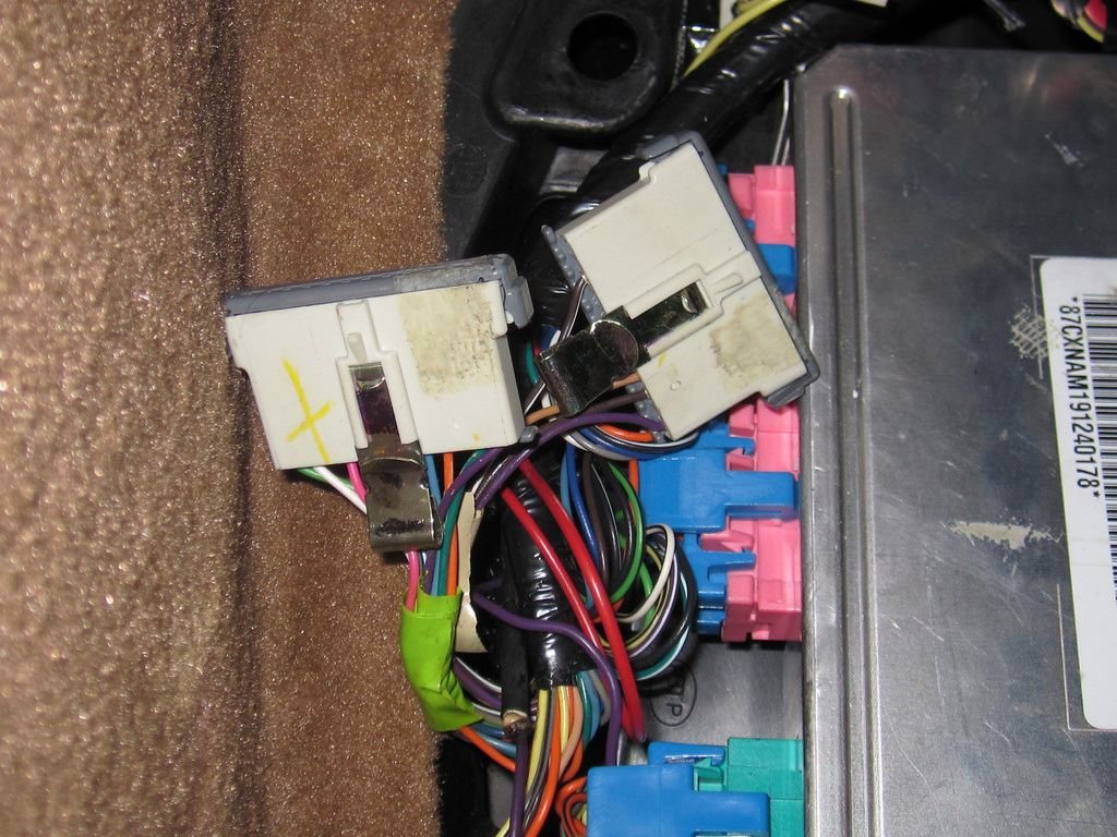

There is a serial data line issue. There is a connector for the serial bus that powers those door control modules as well as the seat control module. There is a short or open there causing these symptoms. Under the passenger side kick panel, there is a fuse box and BCM under there. There are 2 connectors under there. The one with 4 wires going to it is the one that powers those exact modules you are having connection issues with. There is a shorting bar on top of the connector. It may have lost contact with the other circuits in the line. Might try to pull that shorting bar and re-connect it. There is an issue with the serial line though causing your problem.
The pic below is what they look like.

Thank you RedRiderZR1 you hit the nail on the head. The connector somehow worked itself loose. I pushed it down and it popped right back in everything works again.
