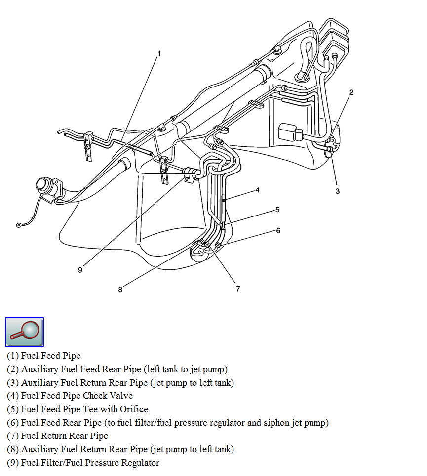

Here is how you tank system looks like
The electrical pump(pressure from electrical pump) in the left tank is feeding the siphron pump and moving gas from right tank over to the left tank through line 3 . If the electrical pump is dead I guess you may have to drain the tanks slowly by loosing the screws on electrical fuelpump cover and drain the gas into a bucket or any similar .

That's what I was afraid of, I guess that is my only option, thank you for the response!
