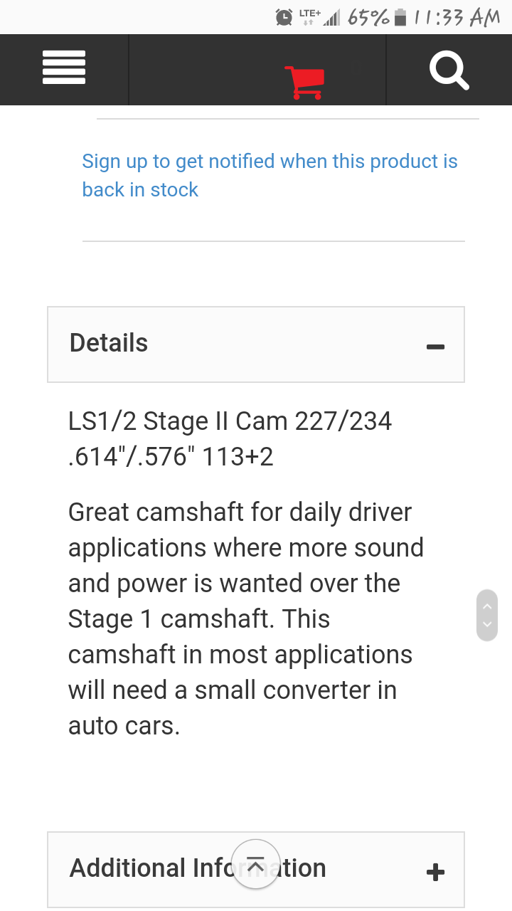

Would a stage 2 BTR N/A ls1 cam be mild enough for my stock ls1, with described bolt one?? What would I need to support the cam? Trying to keep heads on till fall.

I haven't memorized all the manufacturer's specs, so post a link, or just list the cam specs if you want an opinion.

I'm running that cam (BTR Stage 2) and didn't have PTV issues even with slightly milled heads. I really like the cam and with my heads (Livernois Stage 3) and LS6 Intake it made 440whp after dyno tune.
All that said, when I measured PTV, it was at the minimum recommended amount. I'd consider this to be the biggest you could go without needing to pull the heads.
The biggest concern with PTV is the exhaust valve because the piston is moving towards it while it's opening. A cam with slightly less exhaust duration (which is what matters on PTV, not lift) might be just a tad safer. Something like a Cam Motion Titan 4...
http://www.cammotion.com/camshafts/t...227-232-113-4/
VERY similar to the BTR Stage 2, just a bit of changes on the exhaust side (less duration, more lift) which would be preferred when concerned about PTV.
