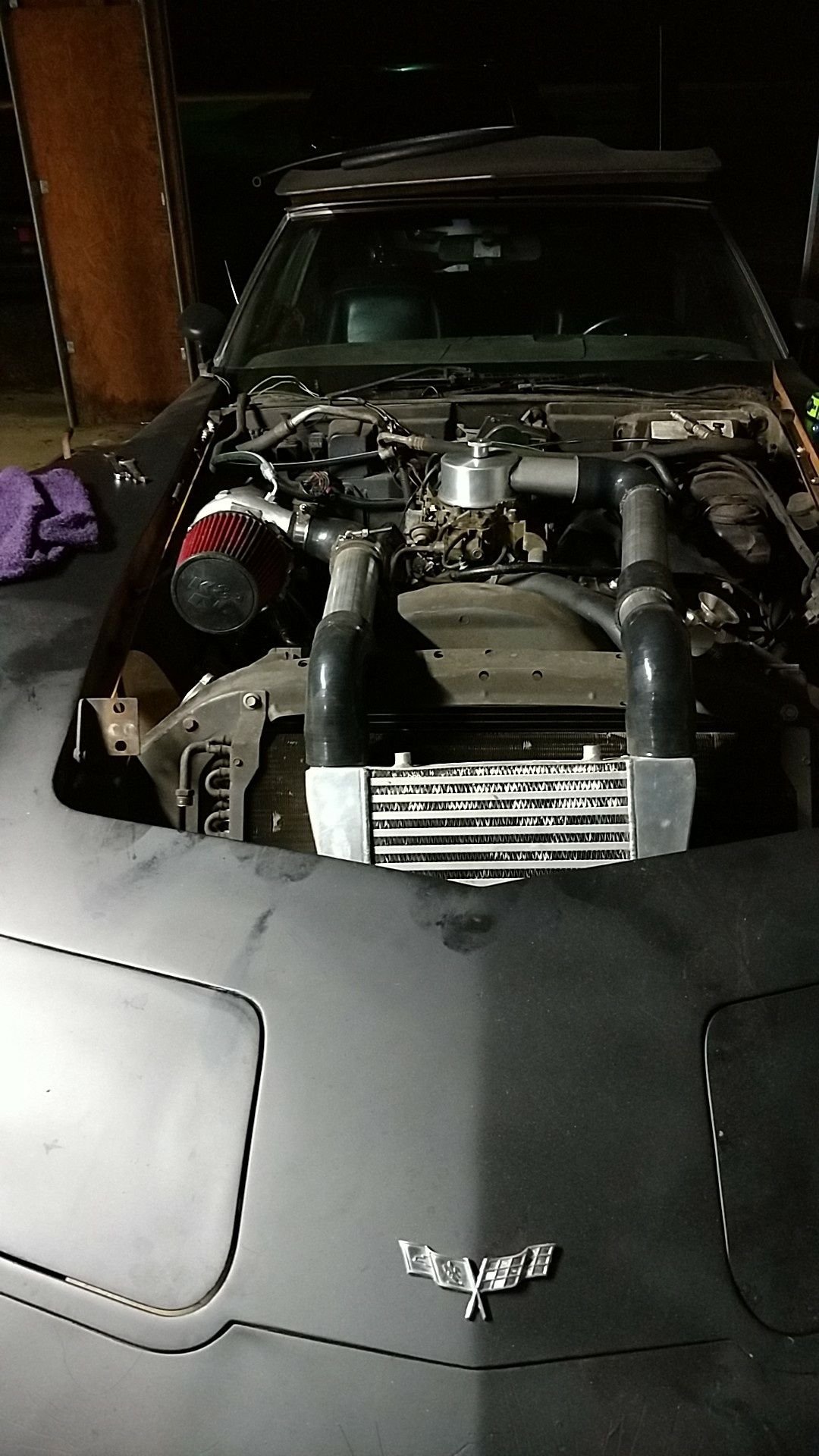

A single gt28r T25 ceramic ball bearing 51mm
W/ a street demon 625 tried to use quadrajet ran fine but kept leaking fuel
Wow you got a Quadrajet to work in a blow-thru application? What mods did you have to make to the carb?
Also, is it intercooled (looks like it) and did you do the piping yourself?
It is intercooled used a stick of aluminized steel from exhaust shop....did video upload?

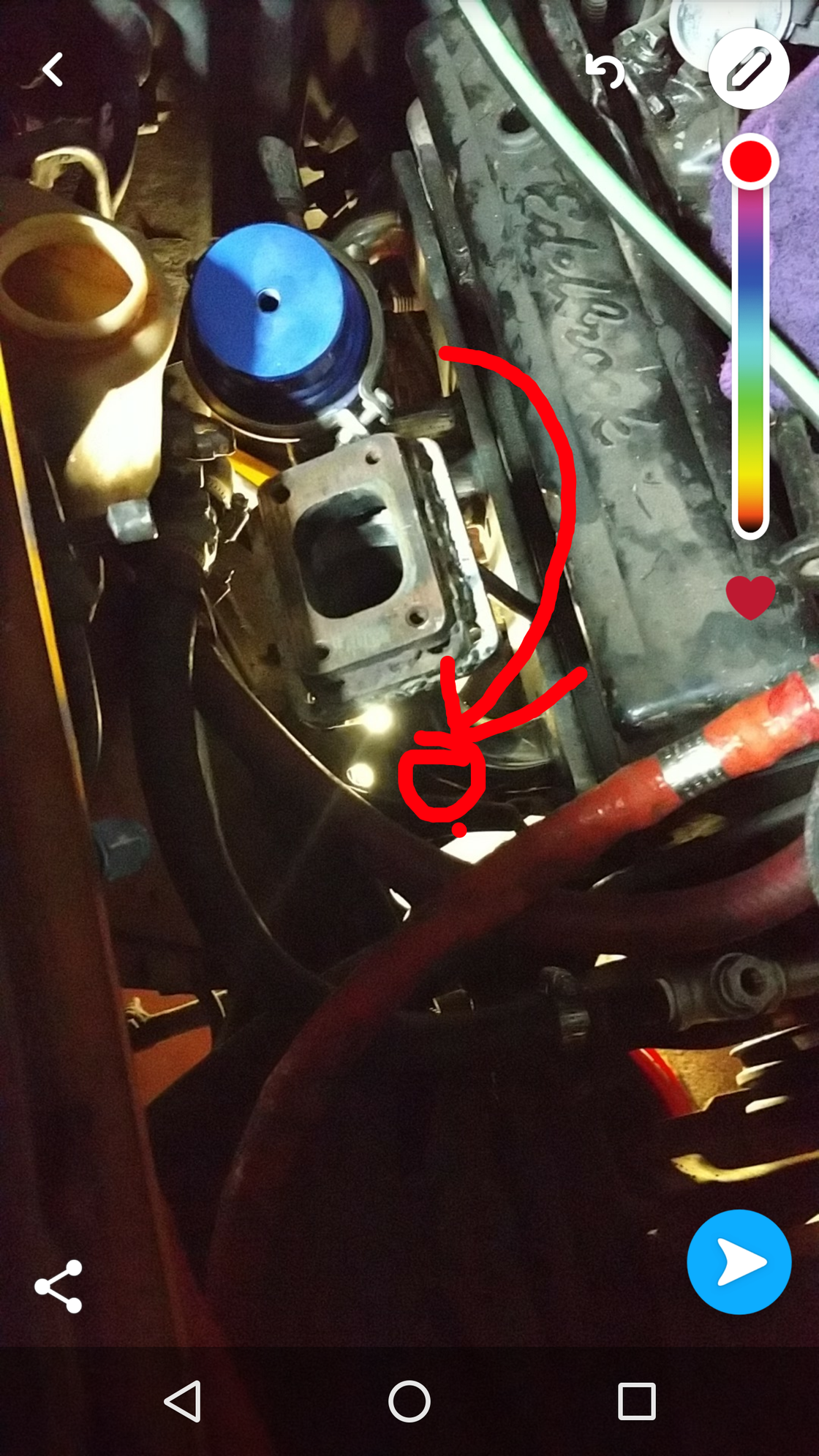

Cleaned it up but this was a seal I epoxied in cuz fuel was pushing out from here

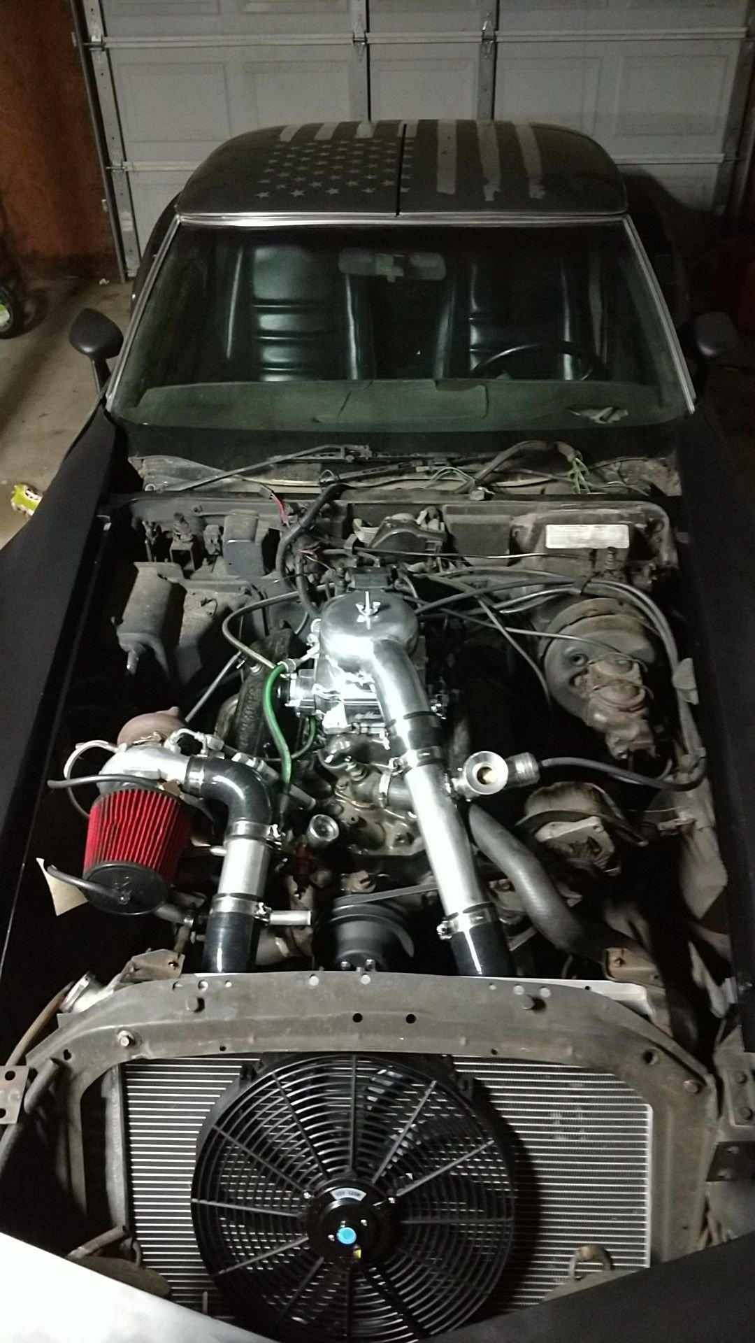

Ok so what did you use for turbo headers, I assume the drivers side is running under the motor and up over to connect with the passenger side?
That's a unique looking setup, and I like that it's kinda budget thrown together, totally my style!
And is that the only mod you did to the quadrajet to make it work in blow thru? I was under the impression that boost referencing a quadrajet was a no-no.

I ordered a aluminium carb cap for like 10 bucks & brazed a pipe in it for carb hat (all just temp to get it running) then just sealed anywhere carb was pushing out fuel.....most of my parts are fabricated or modified to work I'll post more pics if u like
Yes it has a crossover...had to move the waste gate from top to bottom..left no room for downpipe
