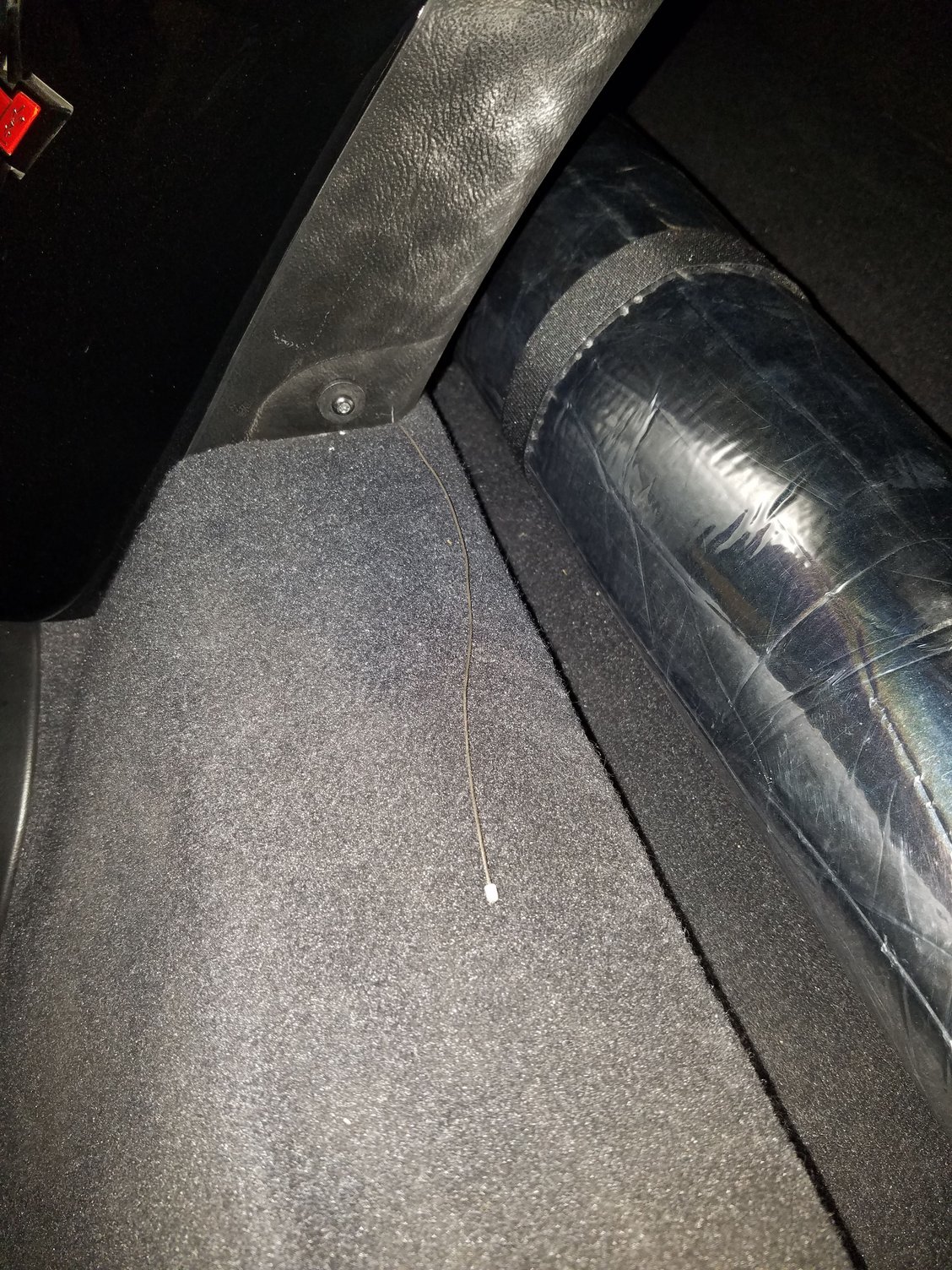

Default manual release for boot cover
Originally Posted by acposter
I just installed a new battery in my 01 corvette, but not sure if that has anything to do with the problem since I have not put the top down in a while. I was attempting to lower the convertible and lift the hard boot by depressing the button under the corner (driver's side), but it would not release the lid. Any suggestions? Could there be a fuse to this?
there should be a small metal multi strand cable at the back of the water fall hiding under the carpet or hidden in that area to manually release the boot but make sure the trunk is shut so you don't crash the boot into the trunk lid
Good luck
little metal cable
