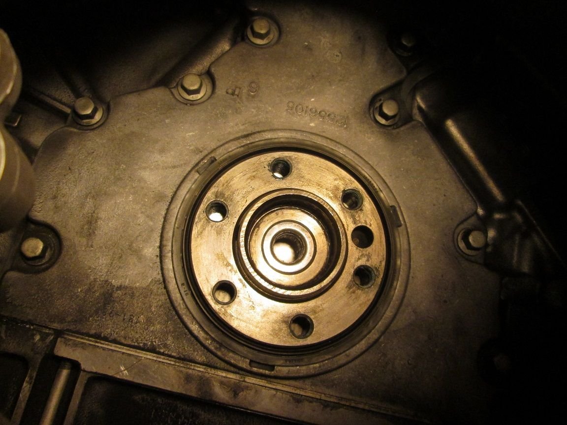

-take off cover, replace barebell and cover/rear main seals

do you dirty rear main seal work first, the once done, then remove and install new pilot bearing.

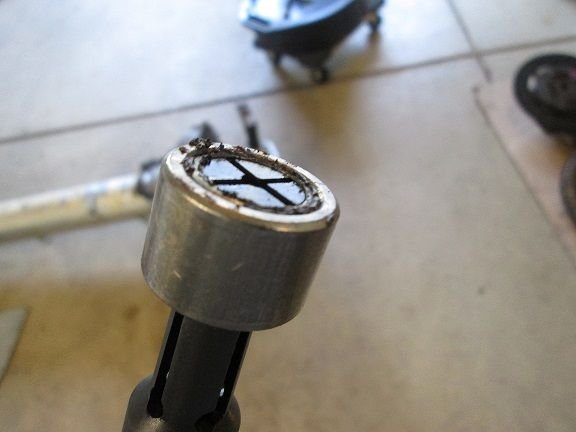

Pilot bearing removal;
make sure you use a slide hamer and bearing adaptor to remove the pilot bearing. Do not use any " old school" methods as you risk damaging the oil gallety plug at the back of the cranke behind the pilot bearing!!!!
pilot bearing installation orientation.
make sure when installing the pilot bearing that you have the correct face of the bearing facing out of the crank shaft .
cheers

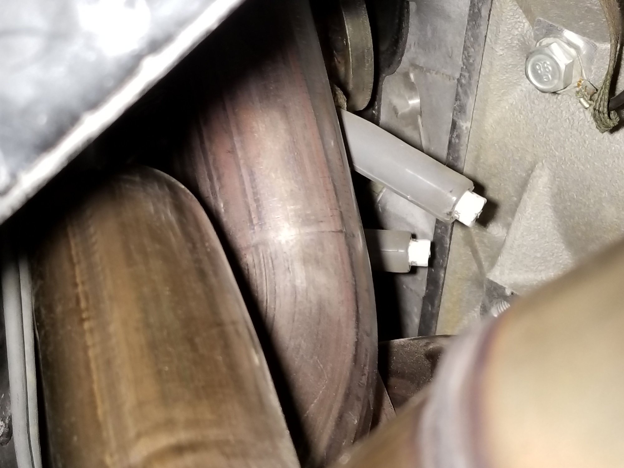

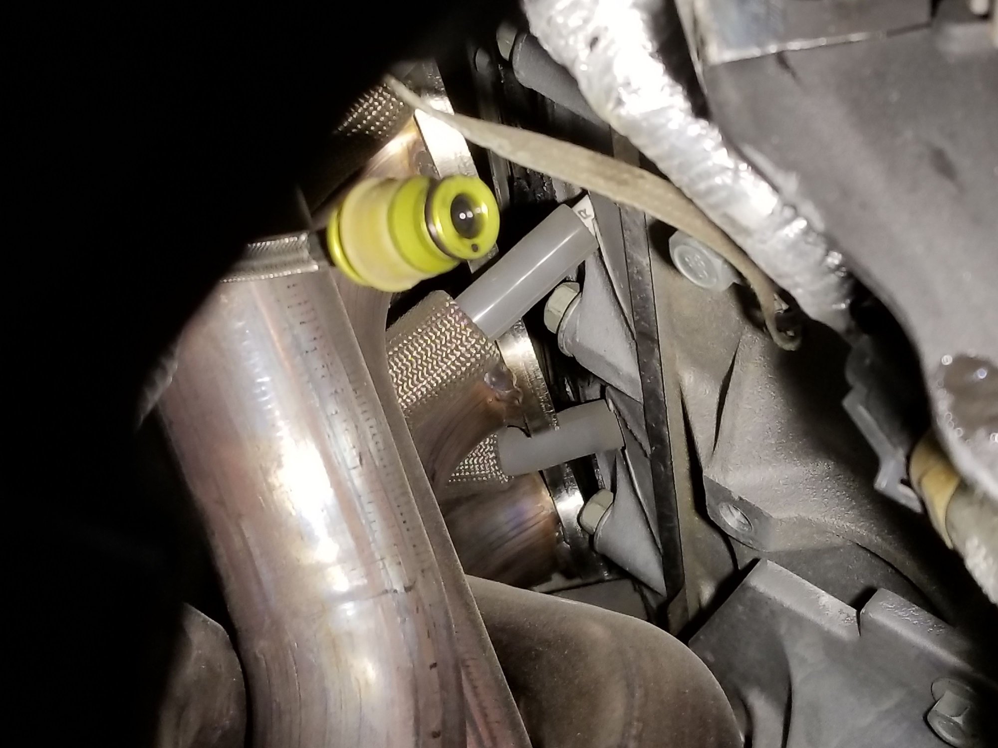

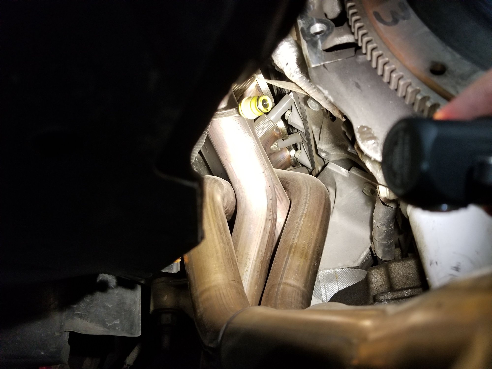

I was able to lower it some first to be able to remove some of the wiring clips. The output shaft still in the clutch. I then strapped it down.
While trying to remove the bellhousing, i forced to much on the headers(unbolted, just dangling) and broke two of the driver side spark plugs....
I have ARH long tubes. I should have disconnected the wires from the spark plugs first, as i left them there and they were supporting the headers.... f... me.
So, if you have longtubes.. watch out!!

Pulling the plugs is always a good idea when unbolting the headers from the head. I've broken a spark plug as well.
