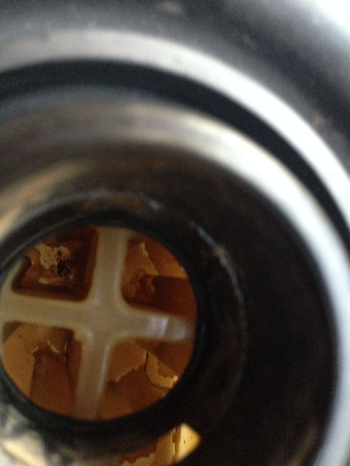

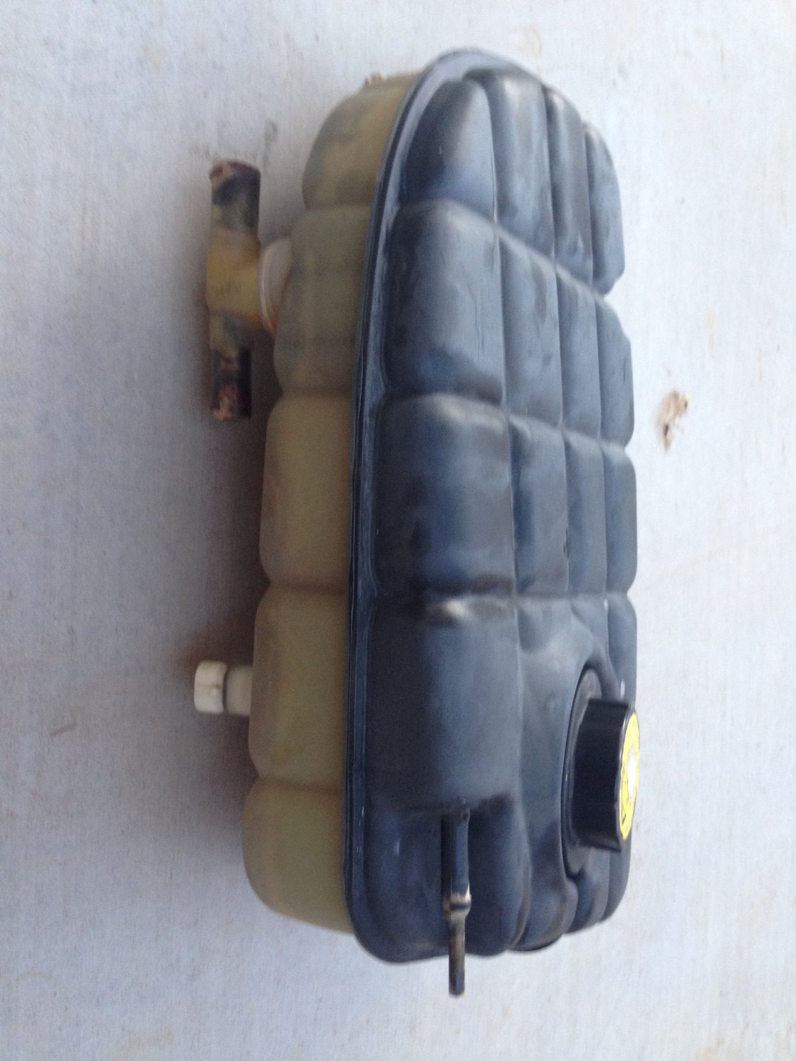

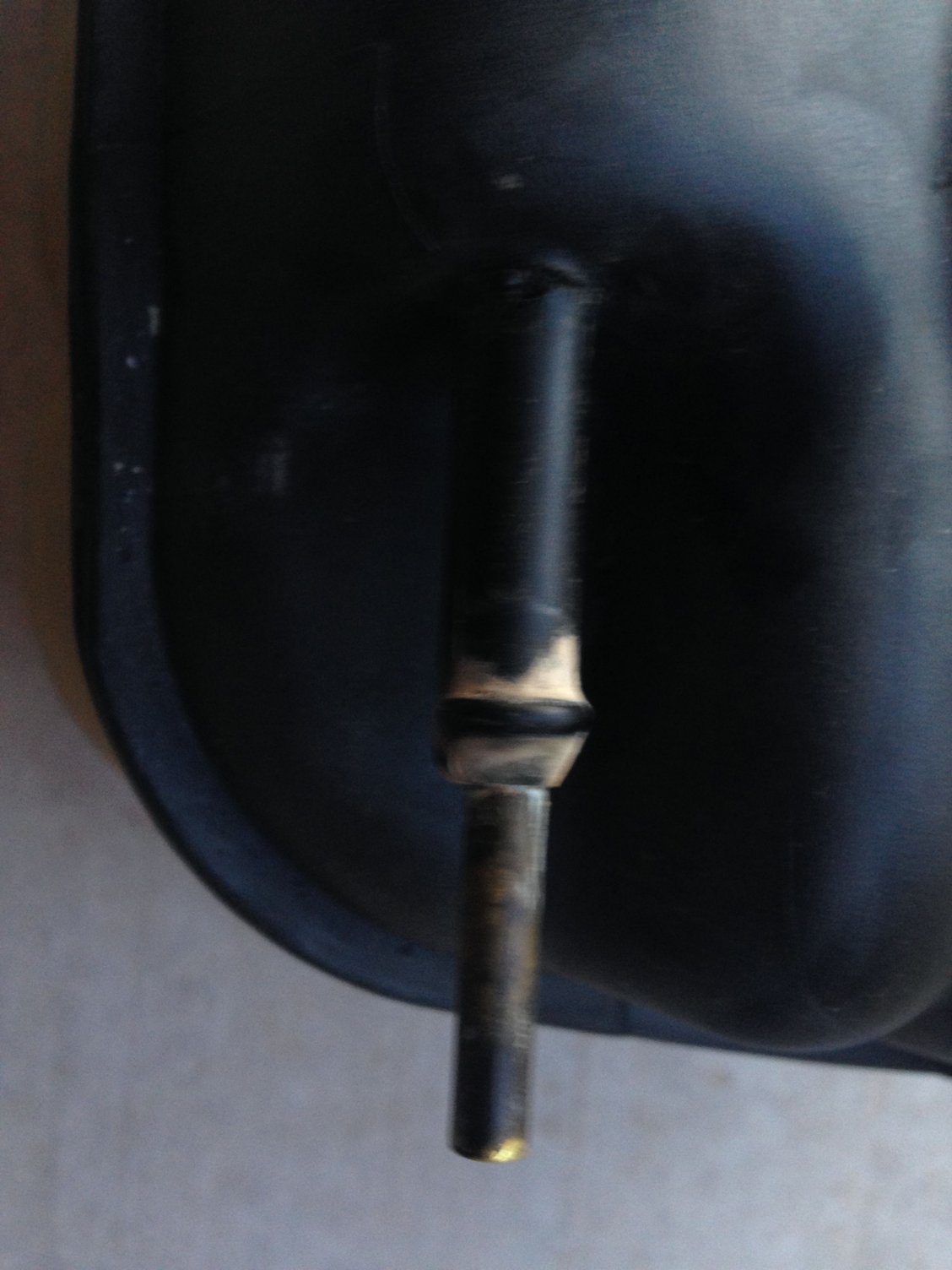

The failure on the original C5 tank was the nipple for steam line had a crack, and that little tube was popped out on it's own after pulling steam line off, I'm assuming it's purpose is to add reinforcement, also the other nipples appear to have tubes in them also.
I took cap off and doing all angles looking in, you cannot see the float, the float doesn't appear to come out, so you can't really get at it to clean or replace.
If you buy a new tank with the float and either replace yourself or have shop do it, you don't have to mess around anymore, 110.00 or so for AC Delco September 2017 as I recall.
