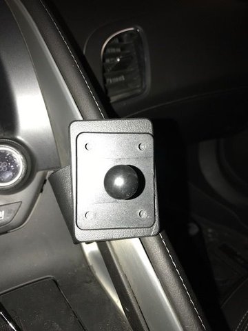

You might have a look at Pro Clip USA. They have vehicle-specific mounting systems for many cars, including the C5 Corvette. I prefer adapting magnetic style mounts rather than their phone-specific adapters.
Here's what I did in my C7. I know that Pro Clip has a similar mount for the C5:
to start with I purchased a mount from Pro-Clip USA, their item #855034. To this I attached a surplus Garmin mount (Fleabay) with automotive grade two sided trim tape (I used the Garmin gimbal-style mount so I could adjust to avoid glare):

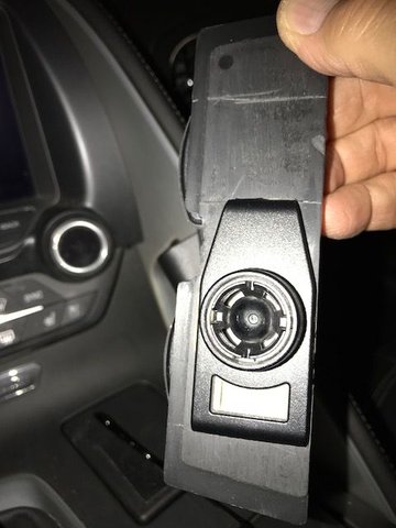

I then attached the female side of the Garmin mount to a spare piece of black plastic:

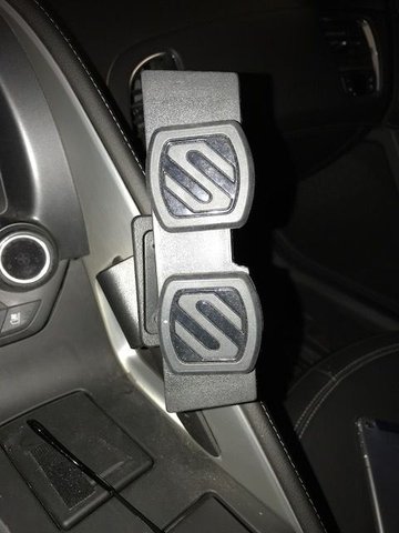

I then attached two magnets to the front side of the piece of black plastic:

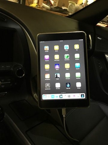

Now I mounted two steel mounting plates to the back of a thin ipad 'skin':
Voila!

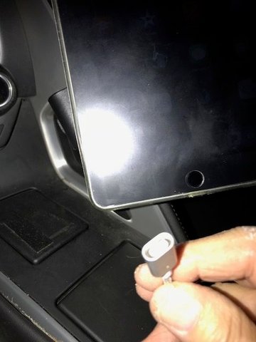

This a 'dedicated' Ipad mini with AT&T WIFI. FWW I also use a magnetic 'quick disconnect' style charging cable:
