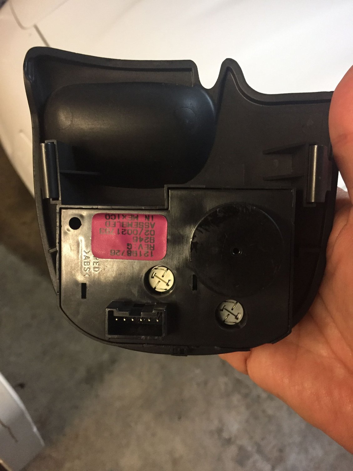

Old May 28, 2018 | 07:40 PM
a0papie's Avatar
a0papie
Joined: Aug 2014
Posts: 30
No button!?
The bottom has a plug in too?
Originally Posted by lionelhutz
Take any pictures of it?
yes here is the 8th wonder
Old May 28, 2018 | 10:08 PM
lionelhutz's Avatar
lionelhutz
Joined: Apr 2007
Posts: 11,150
Likes: 890
From: South Western Ontario
Interesting, but odd. The p/n on that piece is the original GM p/n for the bezel with switch for a T/C only car. So, it appears to me that the switch hole was filled in for some reason.
How does the finish compare between the 2 switch panels? To me, the finish on the picture you just posted looks off compared to what I'd expect a factory GM one to look like.
https://www.wholesalegmpartsonline.c.../12198726.html
