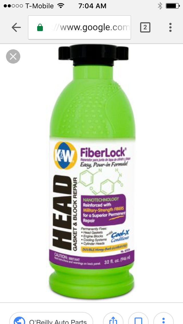

I put this in my girlfriend's PT Cruiser last summer since it was way too hot to do a head gasket, it stopped the bubbles that I'm guessing were exhaust gasses entering coolant, also stopped overheating immediately, lasted from June to right before Christmas, however it clogged the heater core and when it got cold I had to use water hose to purge out heater core.<br/><br/>Then water pump started leaking and because the PT Cruiser is so tight to work on, I told her time to get a new car.<br/><br/>

Has anyone tried any of those coolant fixers on a vette?,
i dont want too screw anything up. I dont really have the place the mechanic said the whole motor would need too be pulled out.

Go to another mechanic. The engine does not need to come out to replace a head gasket.
As for those coolant fixes, they are trash as was previously said.
Save some money, and get your car fixed by a mechanic that knows what he is doing. Or learn and fix it yourself.
If you put any type of coolant sealant in your car and then drive it, you will end up needing a new engine.
