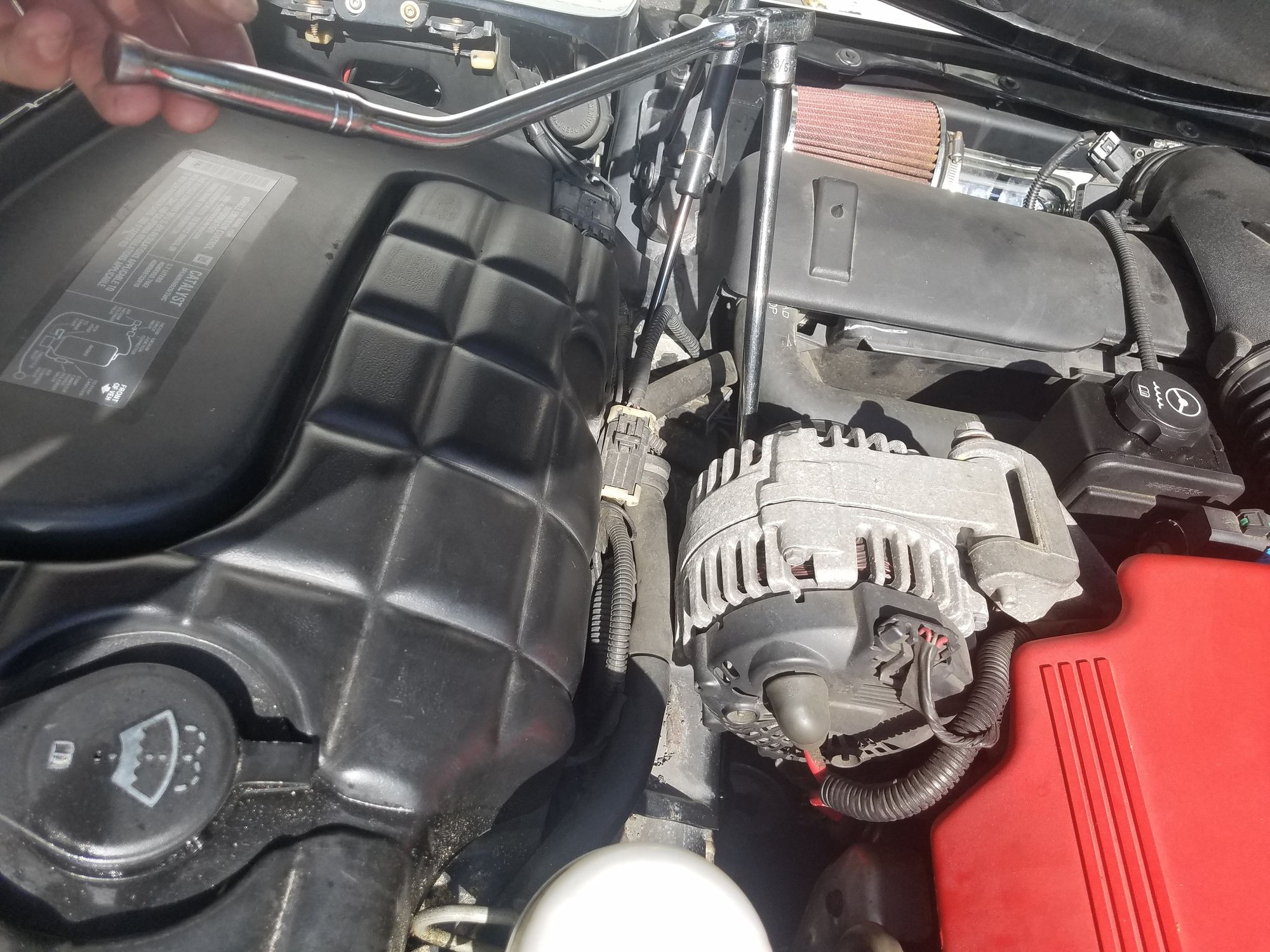

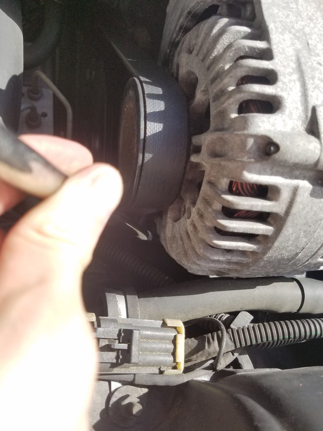

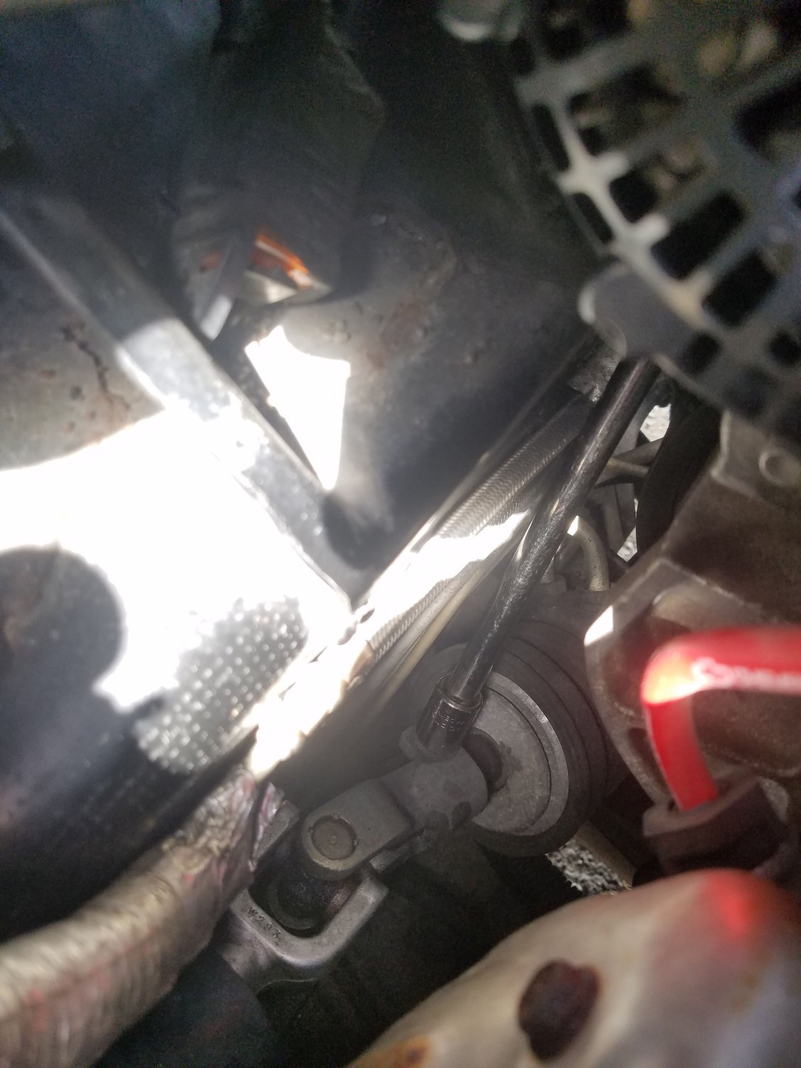

Tighten this sucker, like really tight.

That was it, thanks!!

Shaft was actually loose.
Once I cranked down on that nut some more, all tightened up.
I was using published torque setting throughout, didn't think of
checking to see if shaft was actually tight, just assumed it was.
Silly me.
