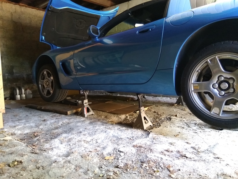

So to give you an update, I was able to recover the jack by lifting the front crossmember with the second jack I got from harbour freight. From there on it was more or less smooth sailing. I was able to adjust the jack stands correctly and I used 1 jack on the front crossmember, one on the back. Put the car on the 4 stands and did the oil change.
I ended up having to run get a oil filter wrench because it was impossible to unscrew by hand.
