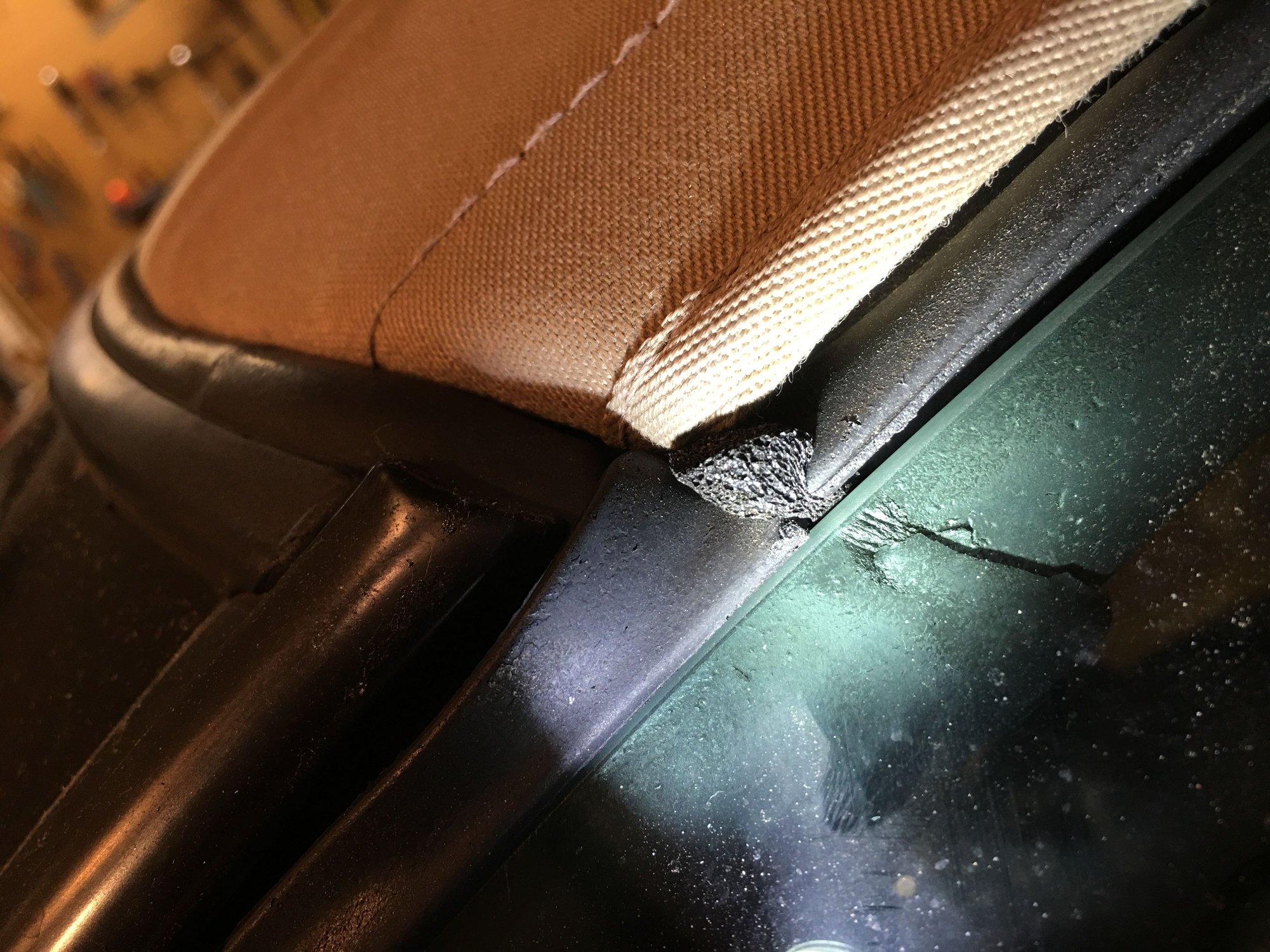

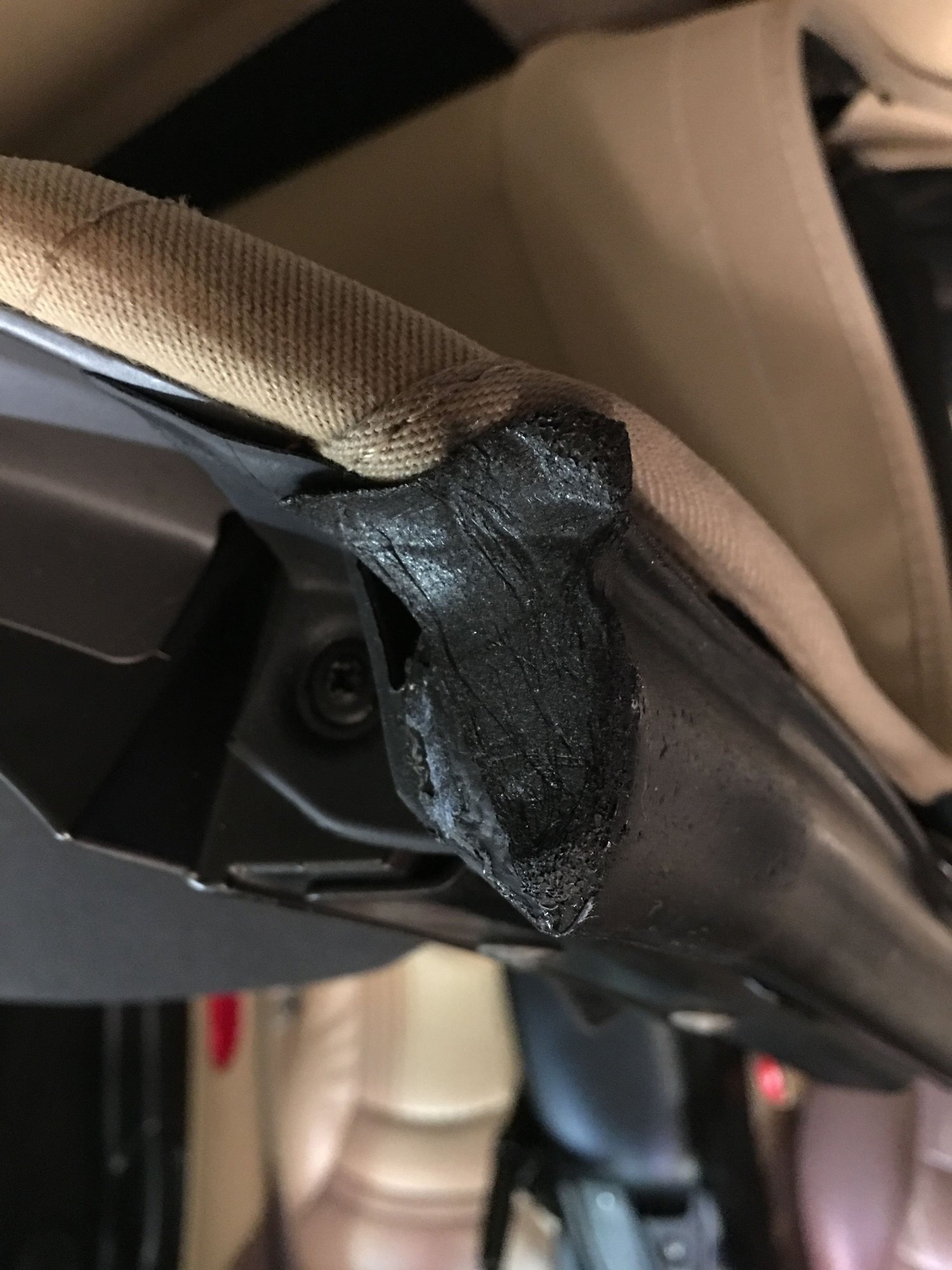

Well, my 2001 convertible has had a leak on the driver side since I bought it 7 years ago. The car lives in the garage much of the time, but if I got caught in a rainstorm it would drip on my left leg just above my knee. Very annoying, and plain un-cool. I tried all kinds of adjusting and fiddling with the window. Putting shims between the frame and the molding.
Good grief!!
One day I got around to taking a real close look at what might be different about the driver side vs. the passenger side. It seems that there was just a little gap at the top of the A-pillar and the convertible top on THE DRIVER SIDE, but not on the passenger side. After a lot of puzzlement, I eventually decided to try a piece of foam insulation in there. I have all kinds of junk in the garage, and I located a remnant of M-D Premium Sponge Rubber Weatherstrip.
This stuff is labelled for Door & Window - perfect!! (After all it needs to stop the window leak of my driver side door.) The dimensions of the entire weatherstrip is 3/8" x 1-1/4" x 10ft. This might be enough to do 200 Corvettes, because I only needed about 2 inches.
So I ran a trial with this stuff and was very surprised to see how well it worked. I unlatched the convertible top where it attaches to the top of the windshield. Next I folded the top back enough so it would stand open.
I cut a sort of triangle-ish shaped piece and put it in the recessed area of the molding that receives on the front end of the molding that fits into the recessed area of the molding that is attached to the A pillar the when the top is folded down.
DON'T glue/adhere your foam in this part. Instead attach it to the piece of molding that is at the front edge of the convertible top.
I folded down the top and re-fastened the latches. That piece of foam seems to be smashed in so tight that rain can't get in there.
I can report that after a few torrential rains - the frog-strangler variety - the water is being kept out. It is working so well that I am just going to leave it alone for a while longer. At some point I will possibly trim the sponge rubber a little and then infuse it with some 3M 5200 urethane sealant (I have a tube of it in black and it is very handy for certain specialized situations.) This same 3M 5200 is what I used to attached the triangle foam to the molding. It is messier than roofing tar at 100*. So wear gloves,mask the car and top excessively, and use plastic wrap (over the foam) if you fold the top back down before the stuff dries. Drying time can be up to 7 days according to the label/instructions.
If this helps you, or gives you any good ideas, please post up accordingly.

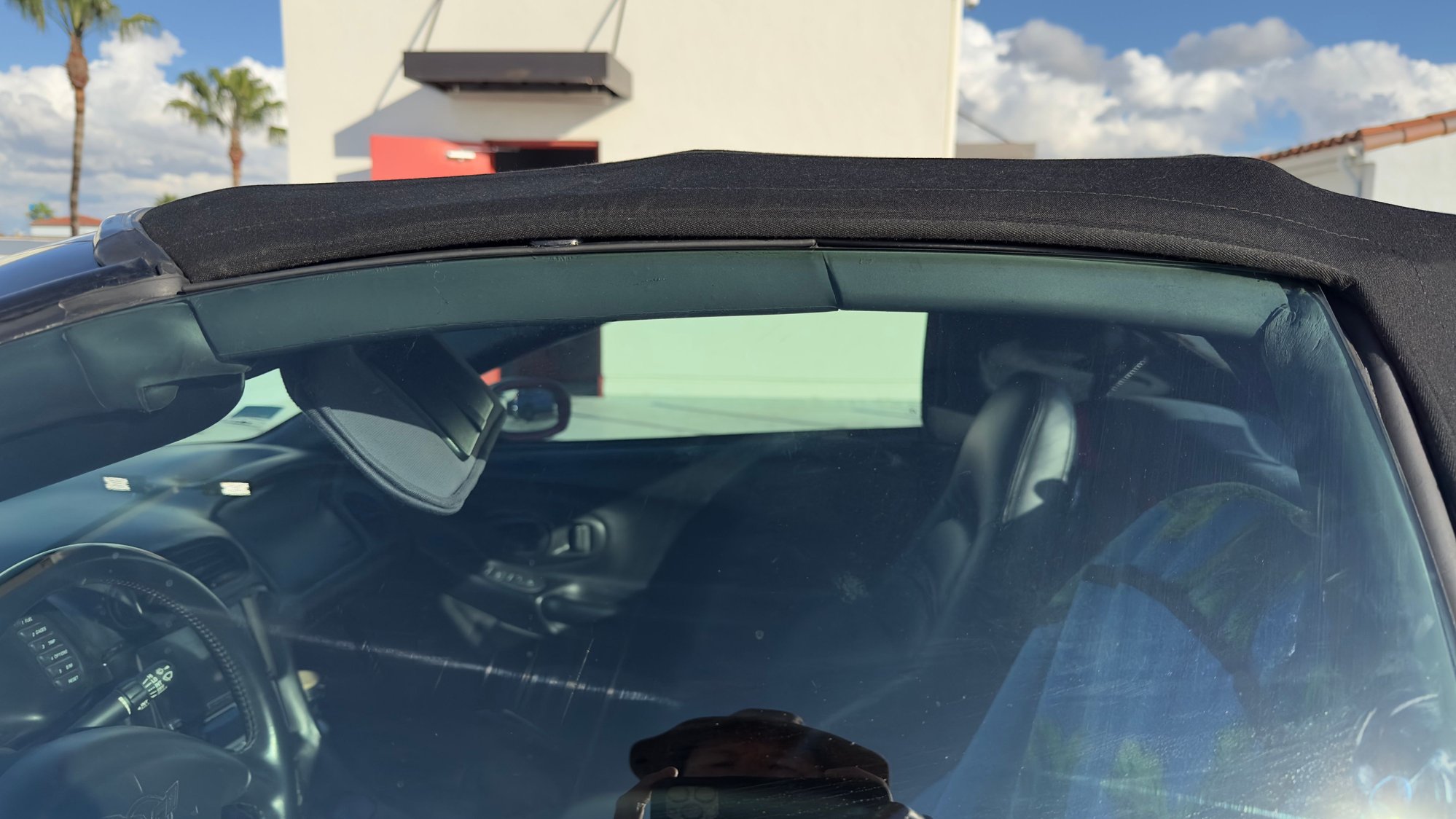

Ok, I think I found the problem. I replaced the windsheild pillar weatherstripping and the convertible roof and rear roof pad weatherstripping. I had to use that Home Depot weatherstrip behind the driver's side upper middle and glue the GM weatherstripping to it. I also had to pop out that offending corner where the windshield pillar meets the convertible roof and glue those in position as well.
The window is still getting sucked out a 70+ mph causing a gap. The window is wobbling out/in more than the passenger side. I tightened the two bolts holding the window. The wobble is less. I'm going to get the door's outer and inner window rain guards as well. Hopefully that will solve this noisy problem. In the meantime, I have noise cancelling airpods.

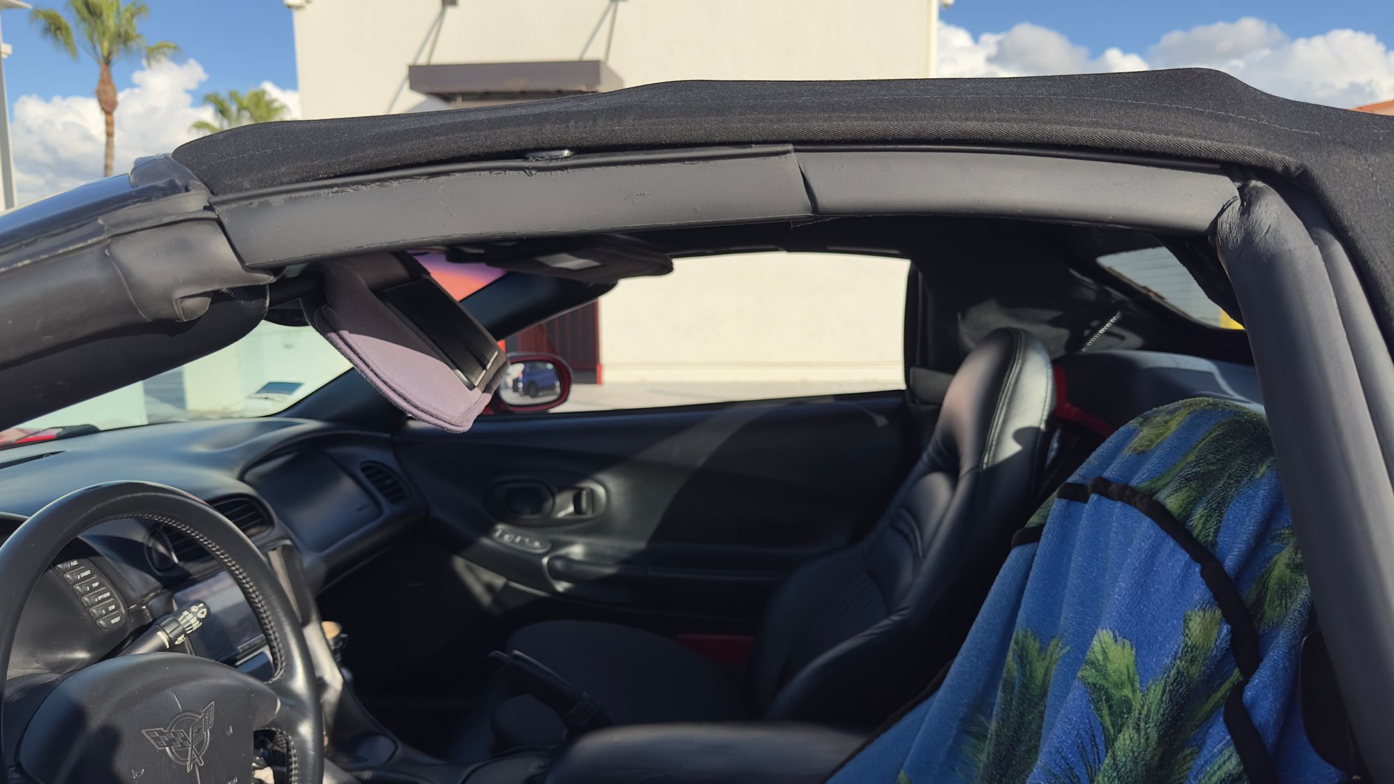

The is new Corvette Central weatherstripping. I also used the 3M weatherstrip glue. The window rain guards are on the way from Zip Corvette. The problem area is where the roof meets the windshield pillar.

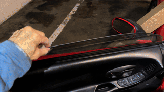

I just got them in today and installed them--they slide backwards then pop out. Do NOT try to pop out without sliding backward like I stupidly did--the fiberglass is fragile and I broke 3 of the keyholes or maybe they were like that already from the door repair at a shop I had done years ago.
This tightened up the window against the weatherstripping. I have not driven it but they passed the wobble test. My only trepidation is that the motor struggles to raise the window against the new rain seal.

SUMMARY: The wobble is the source of my window noise/rain leak problem. I replaced the roof weatherstrip around the entire roof including under the rear windshield (ensure proper alignment to window may need home depot weatherstrip under and 3M weatherstrip glue to seal); replaced the windshield weatherstrip (yes, don't be lazy or cheap); tighten the two window securing bolts (the rubber seals have aged thinner); and replaced the window outer seals (slide them back, then pop out--do not just pop out).
