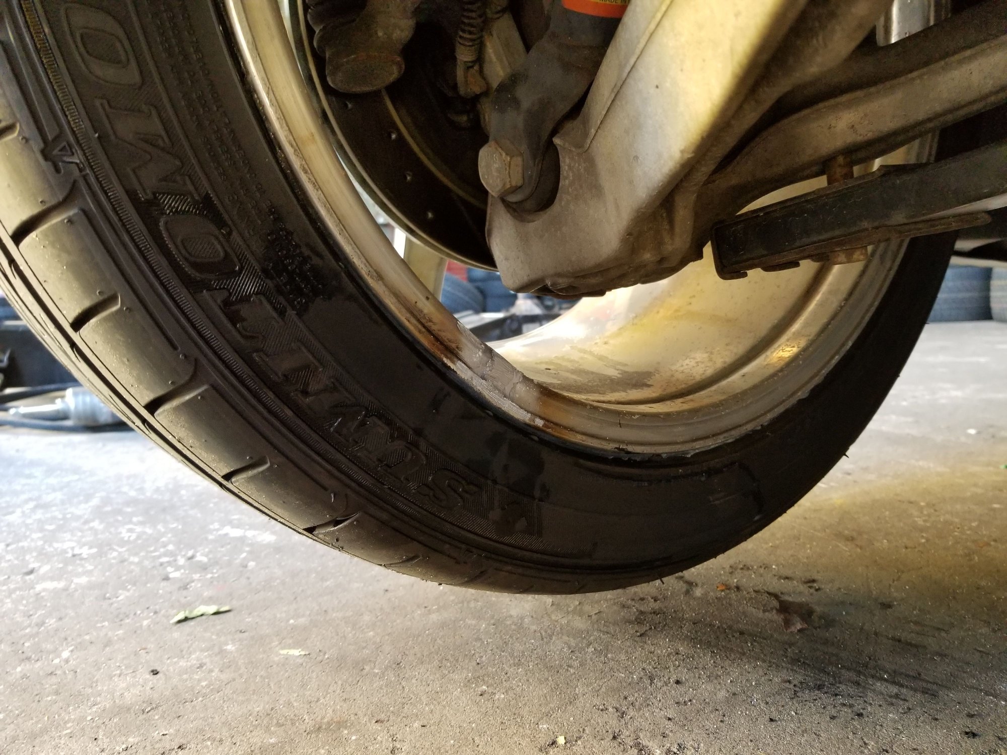

They noticed this crack as my car was getting rear end work done. Is this repairable? If not, how can I tell which wheel I should order to replace (is this chrome or polished)?

I would say no, it's not repairable and it shouldn't be used. The wheel is a thin spoke, polished aluminum wheel. Don't know if there is model name for it - probably not. You might find one for sale in the parts for sale section. Otherwise, look for a matching wheel from one of the many wheel vendors on the net.

that could be fixed pretty easily by a wheel repair shop... we have sent off wheels in far worse shape than that and they came back looking new... another option would be to find a used oem wheel in the for sale section

I respectfully disagree, lots of wheel repair outfits now. That's an easy repair- they'd just weld it, then refinish it.
To the OP: Get a few quotes- it might be cheaper just to replace the wheel. On the other hand, that wheel looks pretty dirty inside. May want to consider refinishing all your wheels if they're in bad cosmetic shape. I had four 18" BMW wheels redone for my DD- they were all curbed and previous owner never washed car, so brake dust started ruining the finish. Came out like new- about $500 for all 4. Well spent IMO.

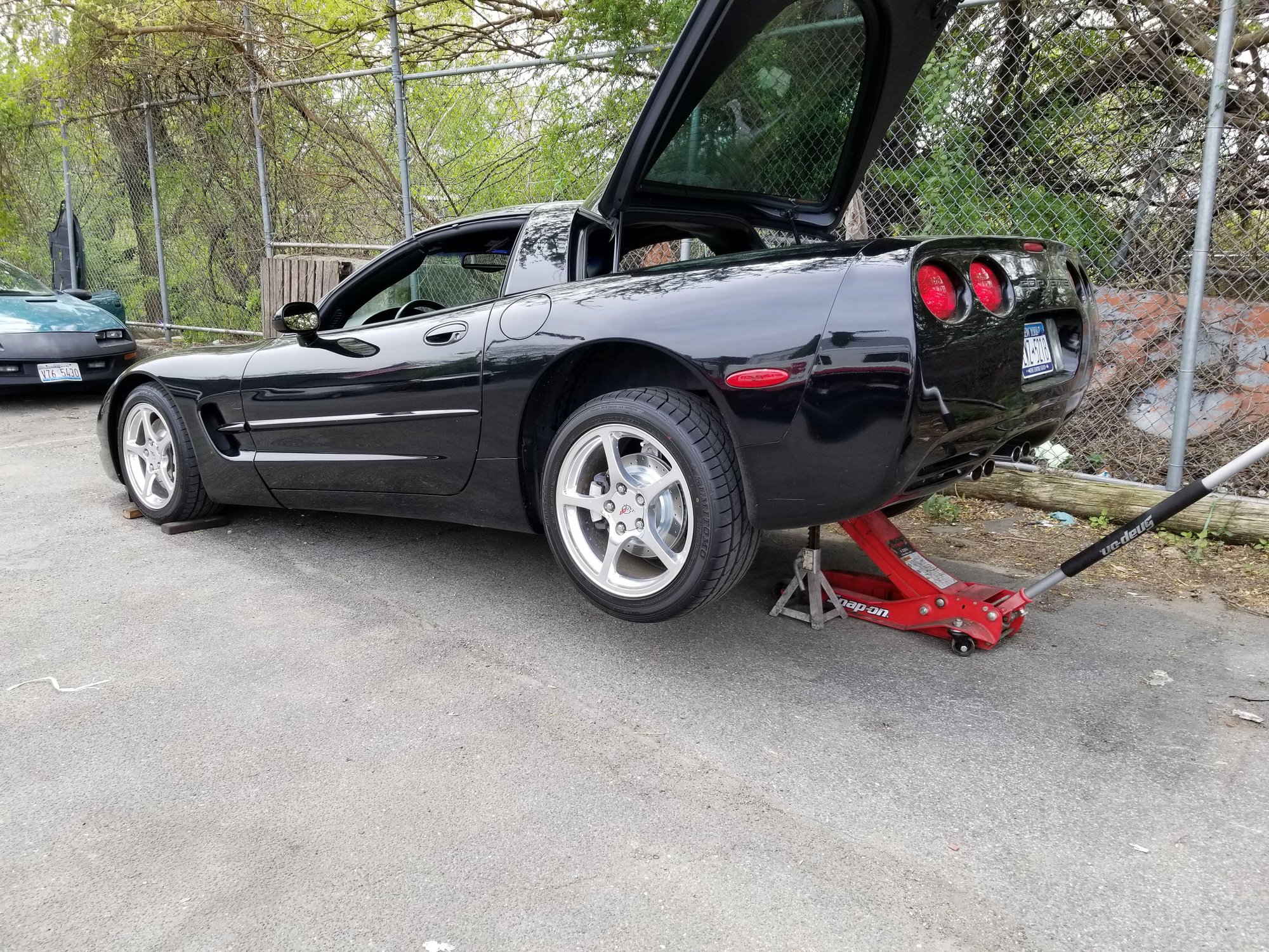

Here's a pic including the rims:

they are polished with clear coat and not chrome...........
and very pretty, on a very pretty car. I'd vote fix or replace with the same. That said, have we checked the remaining three?

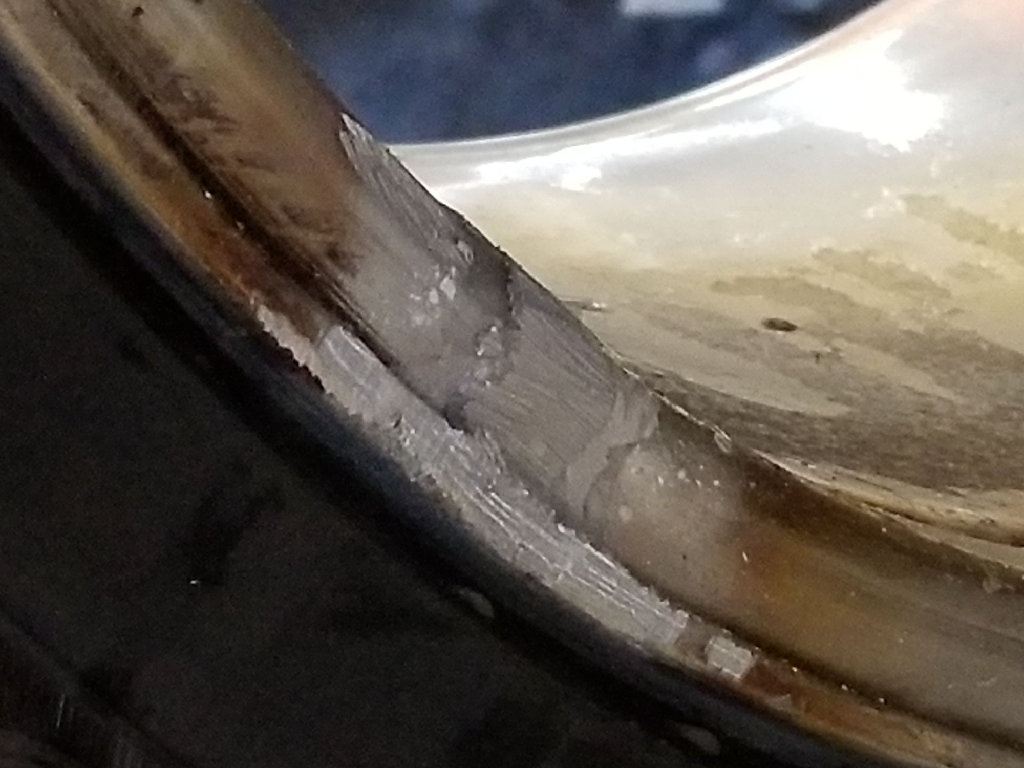

Ive repaired many like yours over the years. Just take a cutting disc and cut a groove right in the crack, then weld it up. On another hand, i would not repair my personal wheels on MY CORVETTE.

I had my wheel repaired. It was also a thin spoke. It's been 6+ months and still doing ok. I'd rather have replaced it, but I couldn't find a single wheel that was cost effective to buy. I think I paid the guy around 50 for the weld job.

Visited a local rim shop and they said they'd fix it for $50. Not bad for a rim job :P

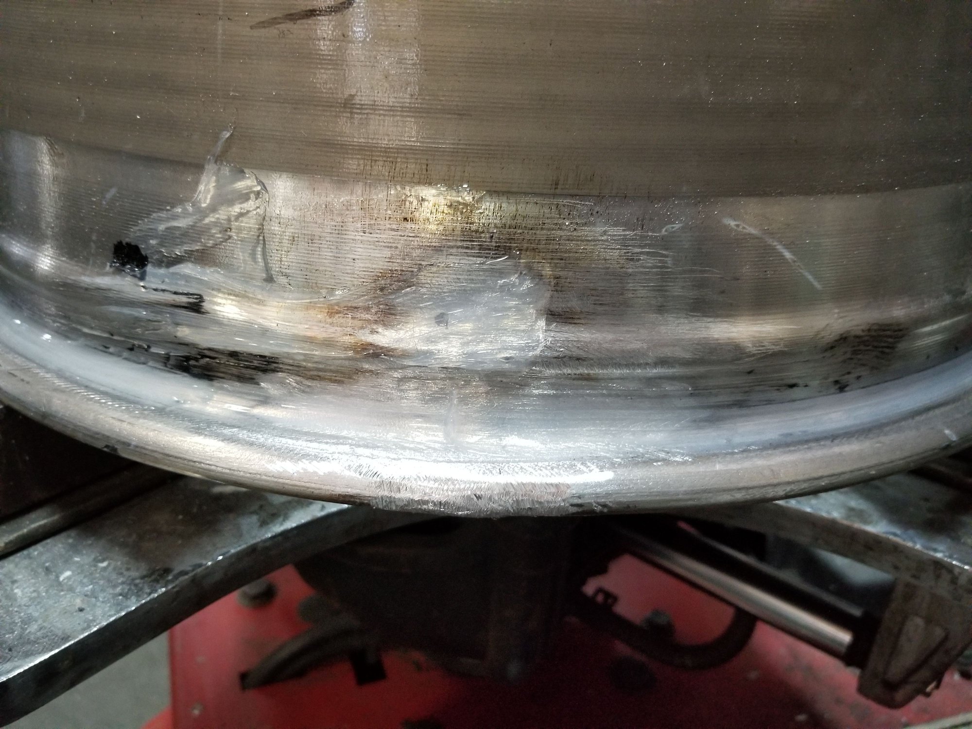

Just got it done. $50 at a local shop and I found out my rear tpms are swapped lol. It said the opposite wheel was flat
