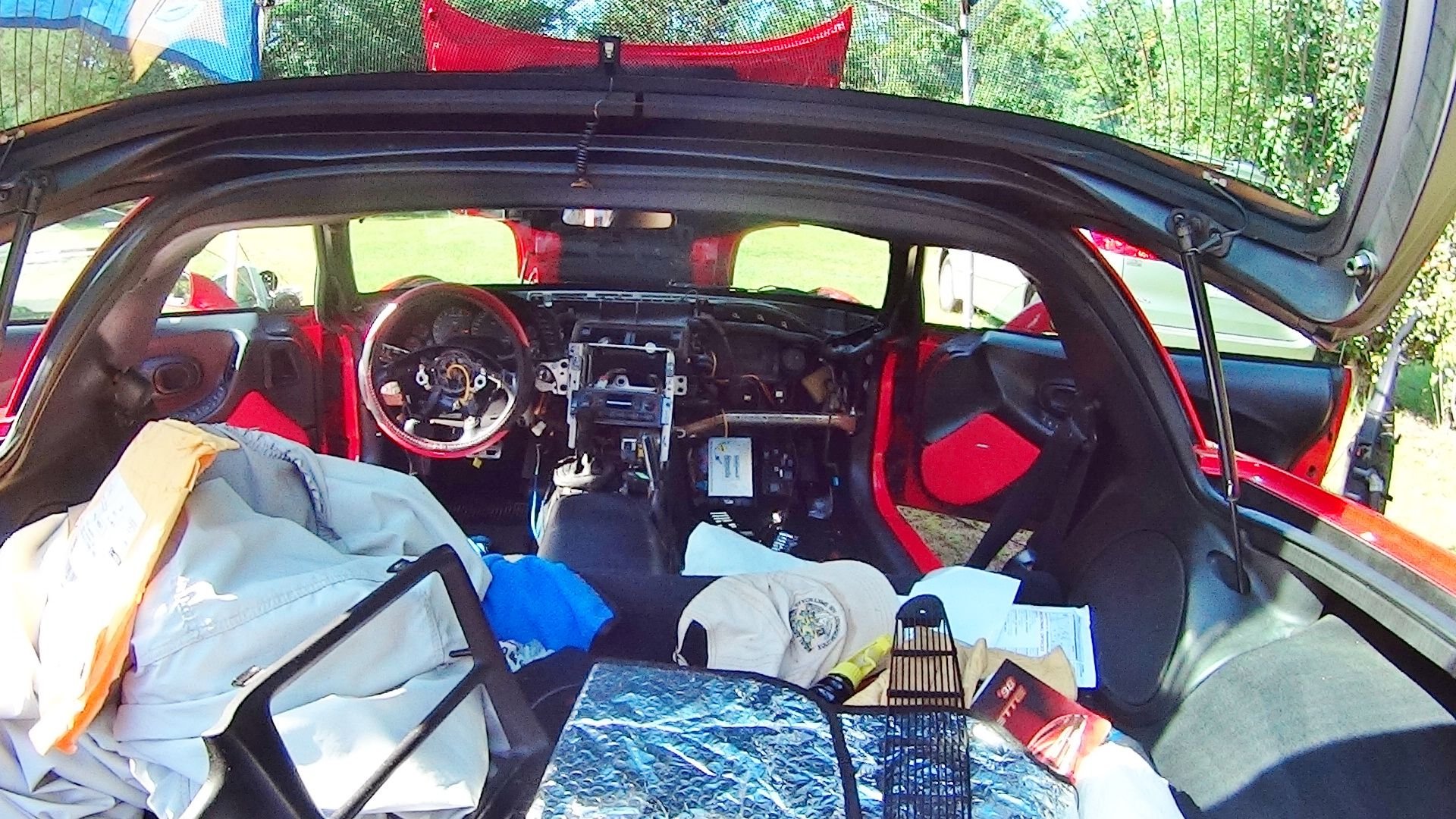

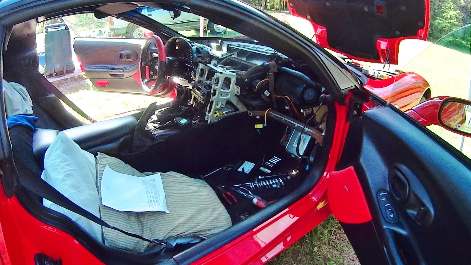

Here is what you are looking at to get to the passenger's actuator. It can barely be seen just above the body computer as a small part id tag below the round gray disk in the first picture. I spent most of a day on this, not hard, but you should get more hands to r&r the dash pad, it is fragile. I found that I could get a fingertip on the driver's actuator shaft end and turn the driver's temp **** slowly to test the actuator for correct movement. After the passenger's actuator was replaced I did the calibration routine before assembling the dash, with a helper, you can see the actuators move together.
The User manual states that the driver's temp **** must be adjusted to 73 degrees, the passenger **** to the middle (straight up) position, THEN turn it off and pull the fuse for one minute. I had to repeat this a couple of times, then it began to work correctly. You have to start the engine and give the ac head unit time to recalibrate itself before changing the **** settings. I also noticed that previous memory settings (door memory switch) needed to be erased and reprogrammed to the 73 degrees for this to work, otherwise, every time you put the ignition key in the ignition the memory will change the ac settings to the old stored settings. The reason the two actuators get out of synch is someone is spinning the temp ***** too fast for the head unit to follow.
After I explained what I was doing to my brother, (he owns a GMC pickup with dual zone ac) he used my method to get his truck's ac working properly (he is still trying to educate his 3 women to not twirl the *****). I got cold air out of both sides, but had no temp control over the passenger side. I had dic codes for out-of-range rh actuator. I pulled my dash pad and replaced the rh actuator, now it all works on auto mode. Cleaning the condenser and radiator cores of 20 years of debris accumulation by backflushing with water was a big factor for both engine temp and ac efficiency. Now I have engine operating temps below 200 degrees city driving and the ac vents blow 47 degrees on a 100 degree day. And I WAS going to install an aftermarket radiator. Now I see that the factory radiator is more than adequate.
Note-I found no proof that the door switch memory actually affects the HVAC memory in Corvette publications, but, frustrated that the 73 degree setting kept changing back to the previous old setting I had been using (60 degrees) I tried progamming the door memory switch after setting the temp to 73 degrees. It worked the next try. It may have been a coincidence, but I got positive results so I do that now. And, the blend door actuator reset seems to go quicker. This only takes a second to do. After driving this car for almost two years I notice that if I set the HVAC different from the previous ignition turn off setting, and I change it repeatedly away from the old setting, The HVAC will begin to start up at the new settings, and continue to do this until I change my settings, for instance, going from hot weather to cold weather or back.
Also, if the temp is at either 60 or 90 degrees, these two settings will block any other changes to HVAC settings (including the passenger temp ****). If you are running the driver's side at 60 degrees and the passenger wants it warmer, you will have to adjust the driver's temp away from 60 degrees to get a change in passenger temp, and the passenger only has a narrow range either side of the driver's temp. It works the same for heat temps. This last is from Corvette publications.
