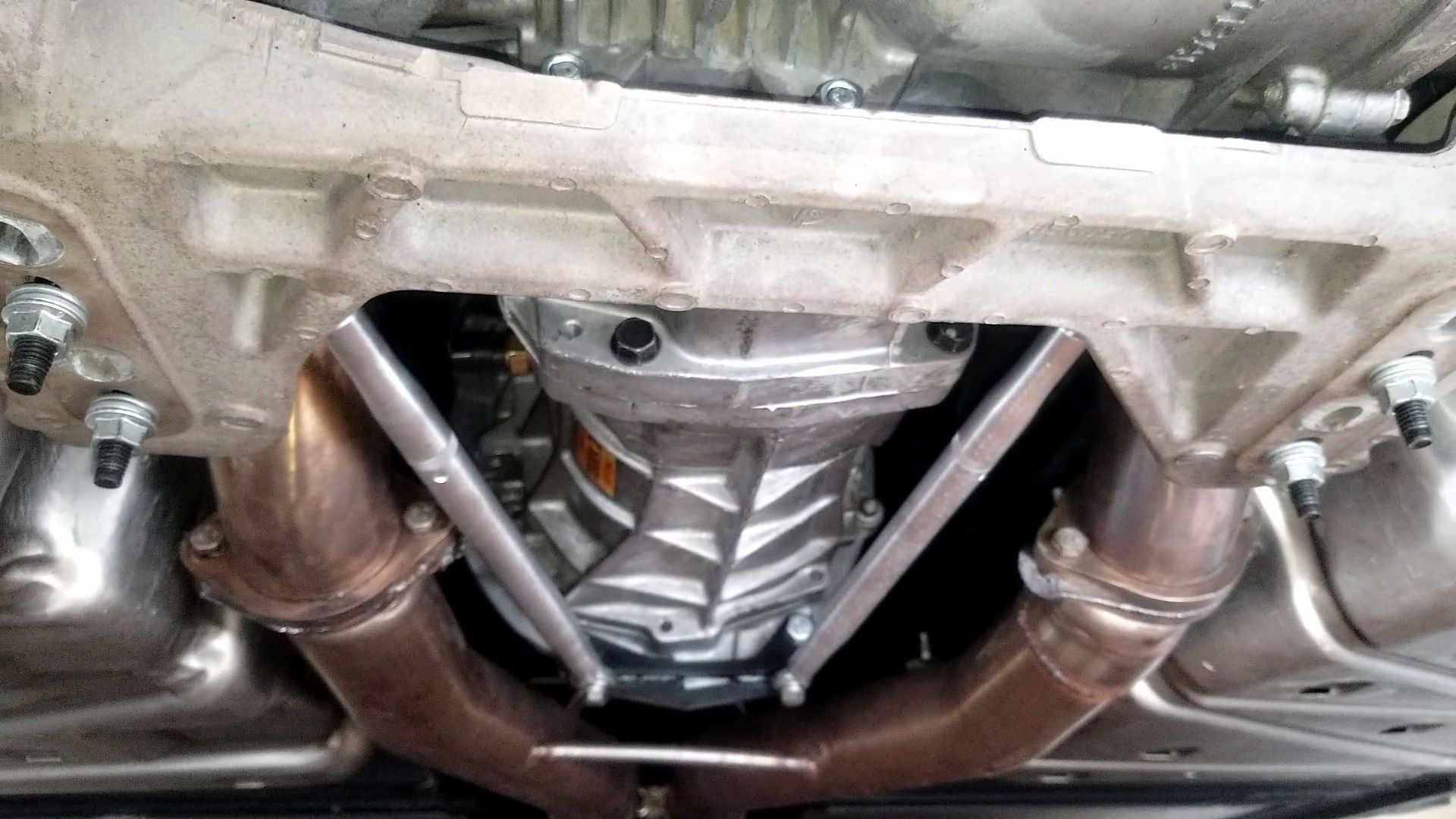

I just had this swap finished. Put a C6Z06 main shaft in my T56 and had it rebuilt to RPM stage 4 specs. Used a C6Z rear diff also built, an ECS brace and used a dual mount rear k member so I didnt have to use the offset mounts.

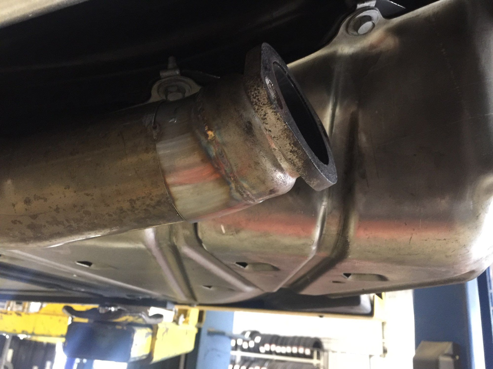

The only thing I cannot wrap my head around is modifying the over axle pipes. I have not seen or heard a set exact what people do.
I saw in brets sticky that you have to modify and that's what they say in fb also. I just wish I could find out exact.

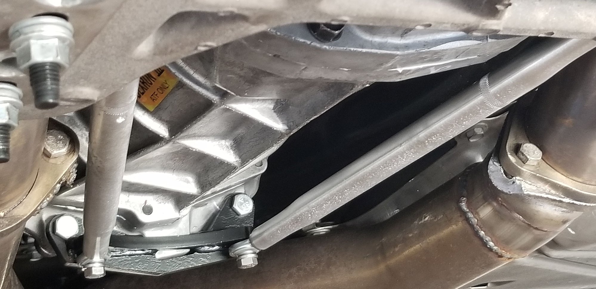

you have to cut a 3" section out of the midpipe, cut the over axle pipes at the top, and weld those 3" sections back into the over axle pipes... so basically you are shortening the midpipe and lengthening the over axle pipes so they can clear the diff case

Mine had to be extended at the top of the over the axle hoop and at the mid-pipe connection

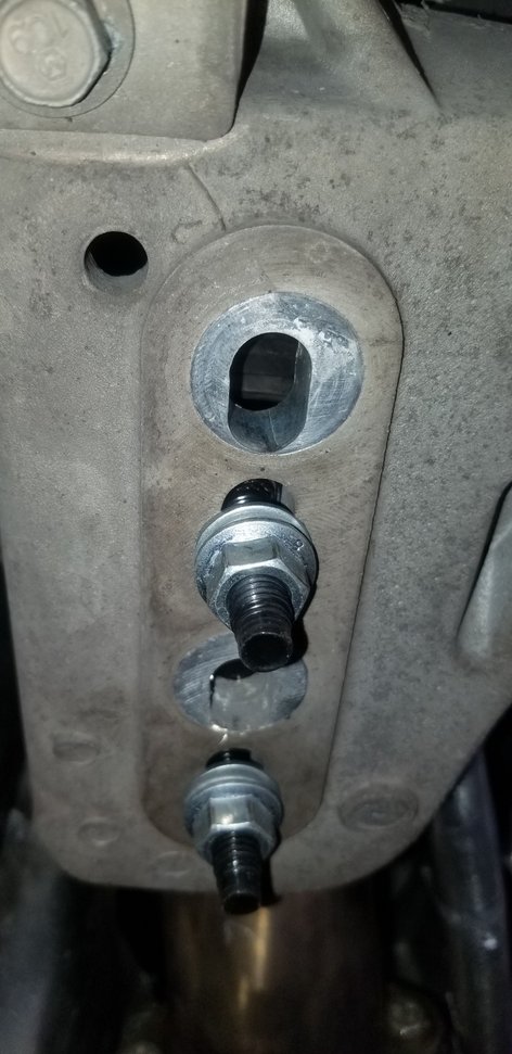

I'd have to check on the K Member but it's a dual differential bolt pattern k member.
The 6060 doesn't matter, it's the C6/Z differential that necessitates the K member swap.

Here's a pic, I'll see if I can get you a part number

Rear Subframe Cradle Crossmember 25795639 Corvette C6 ZR1 Z06 427 2009-13
