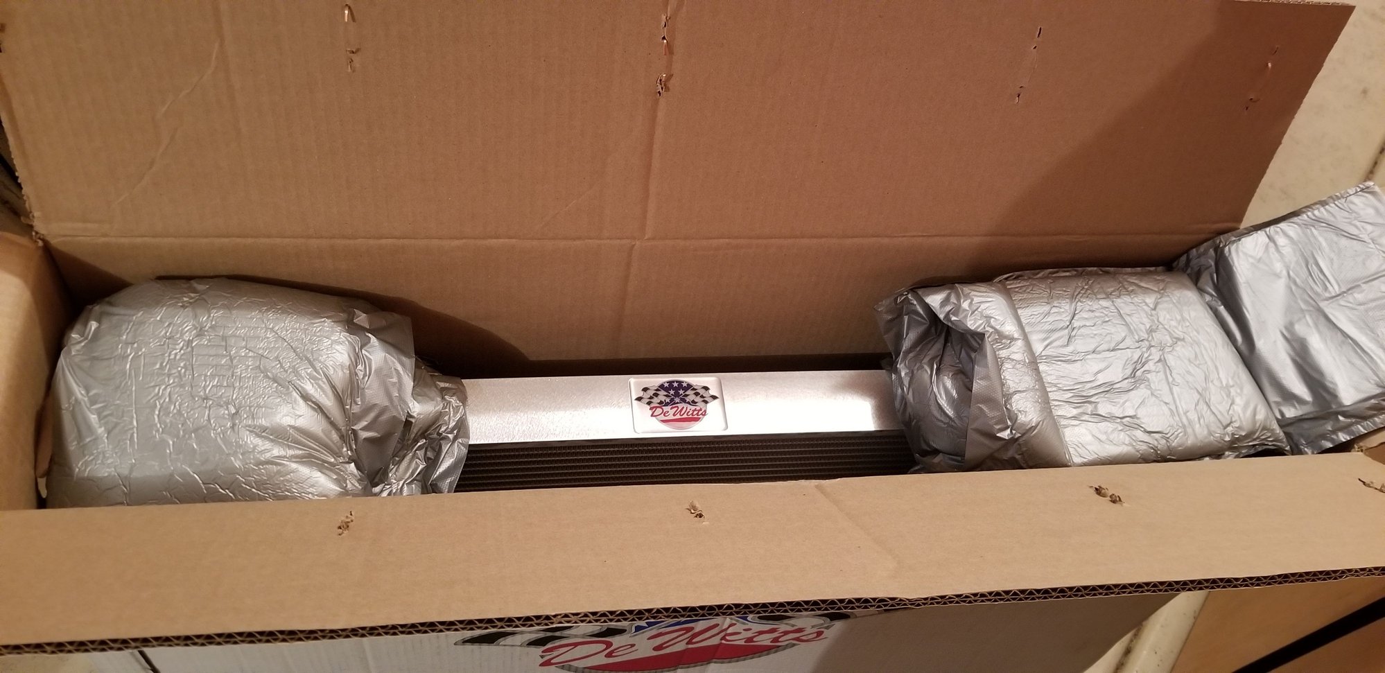

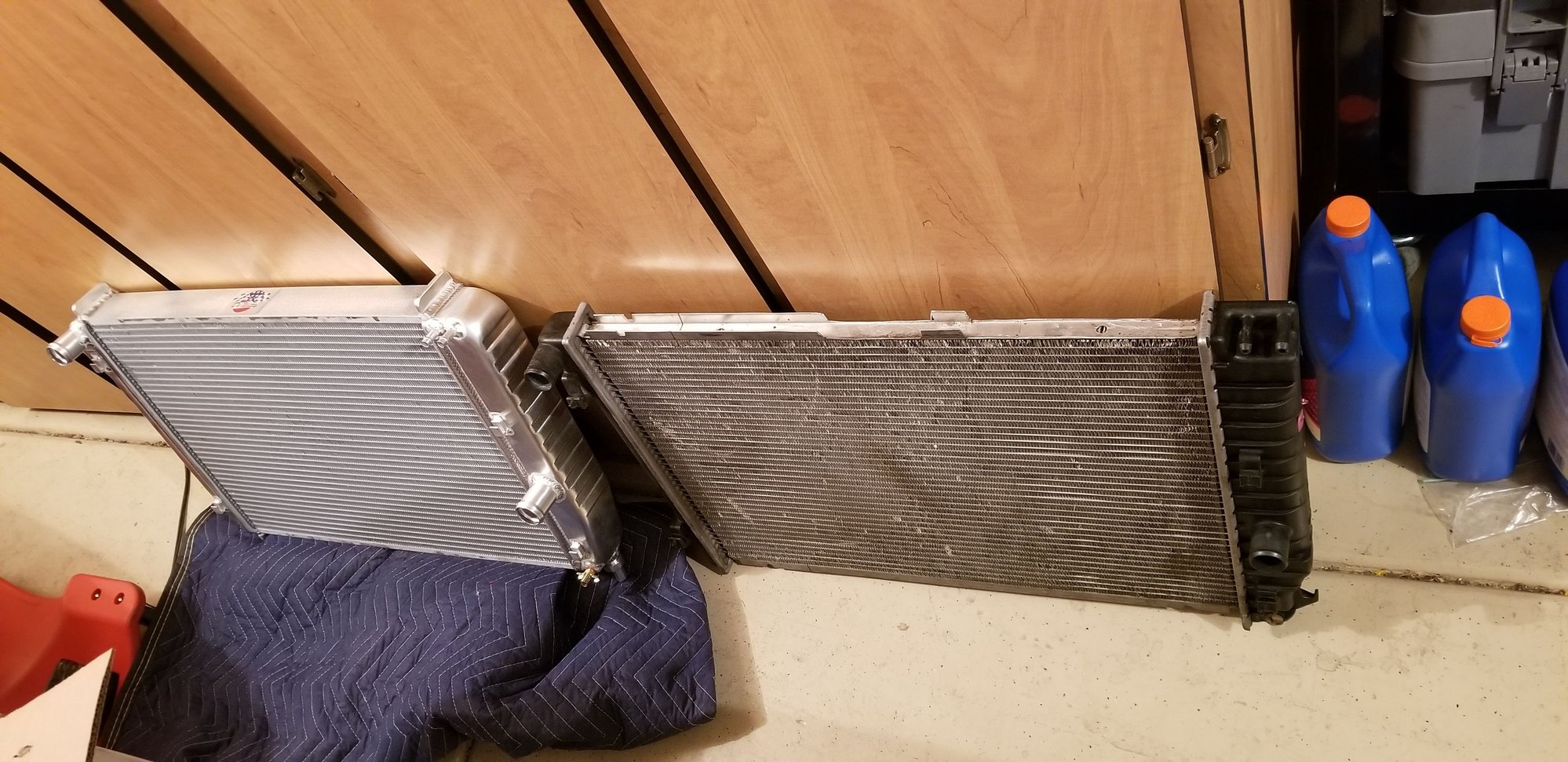

Radiator arrived

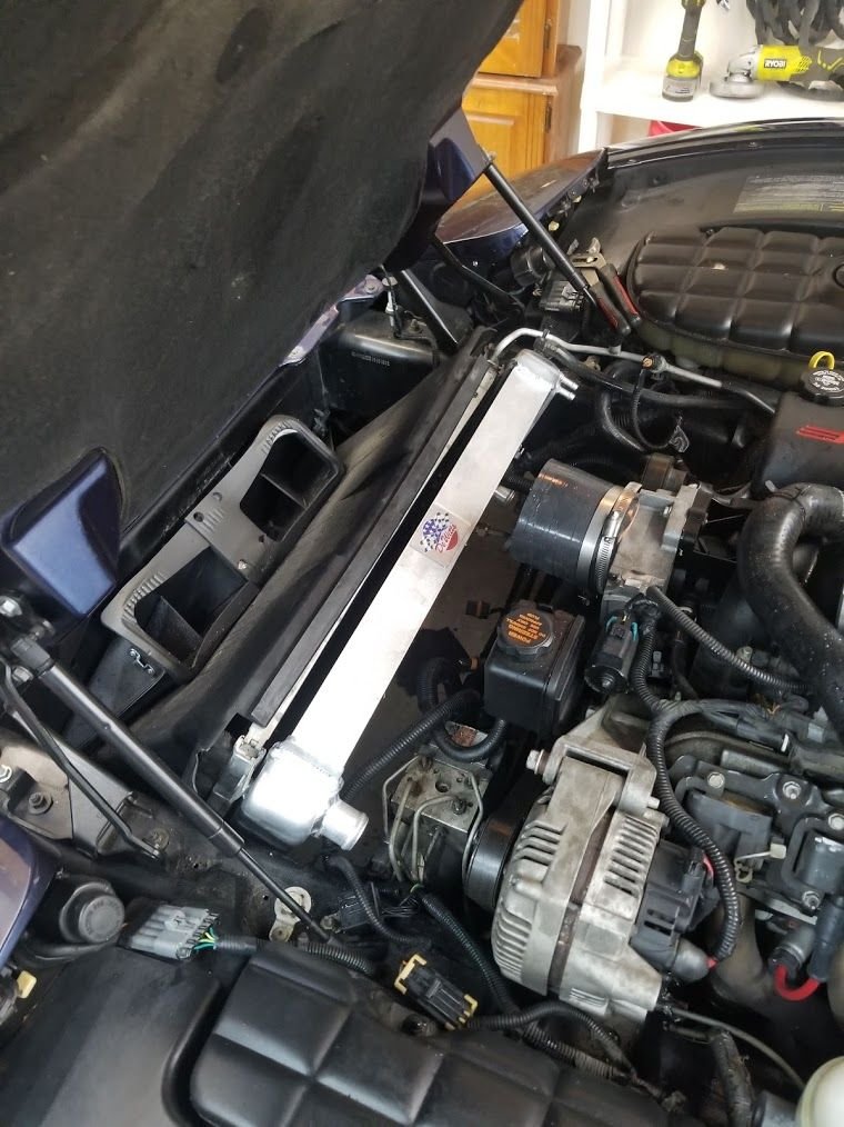

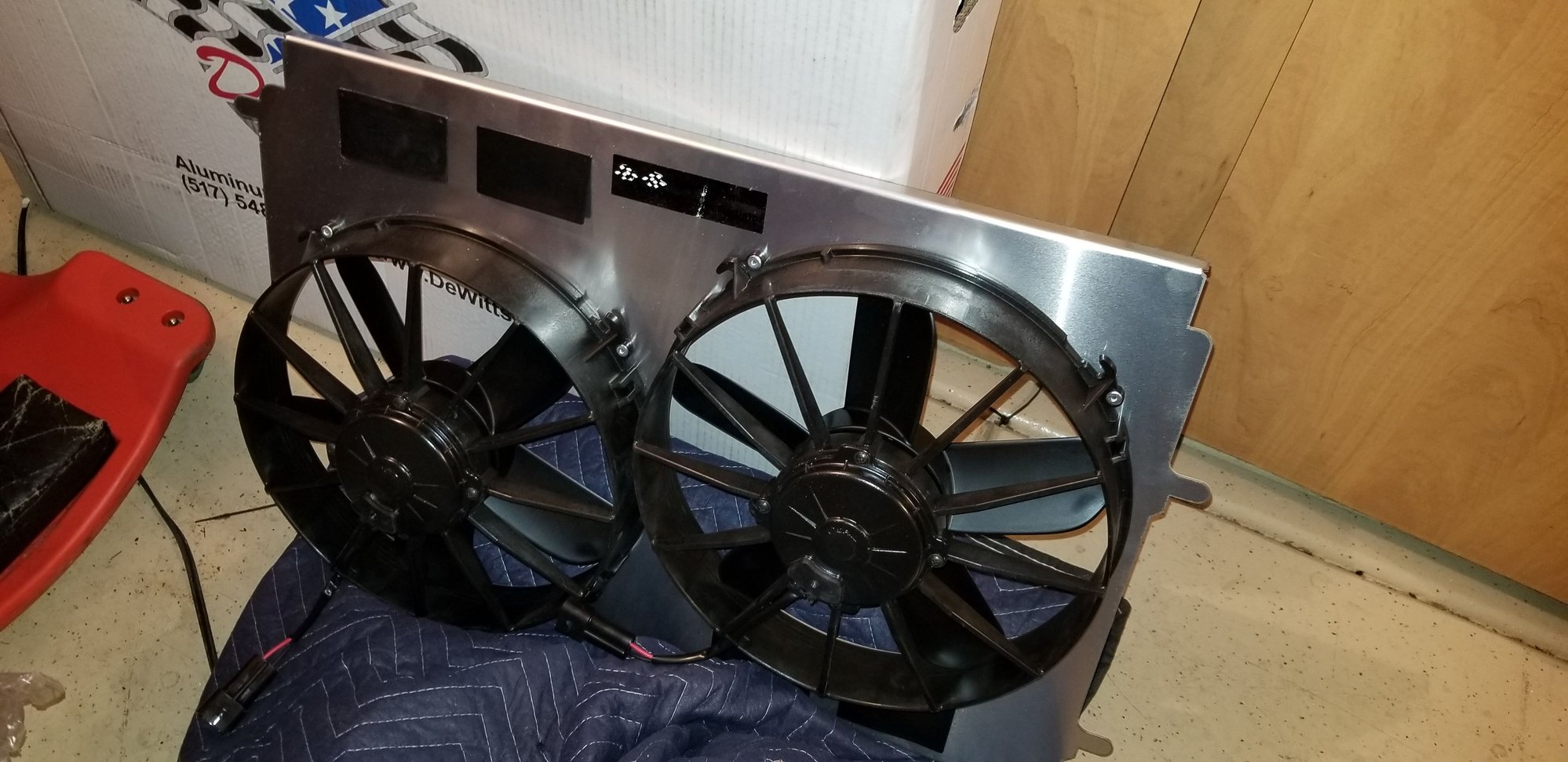

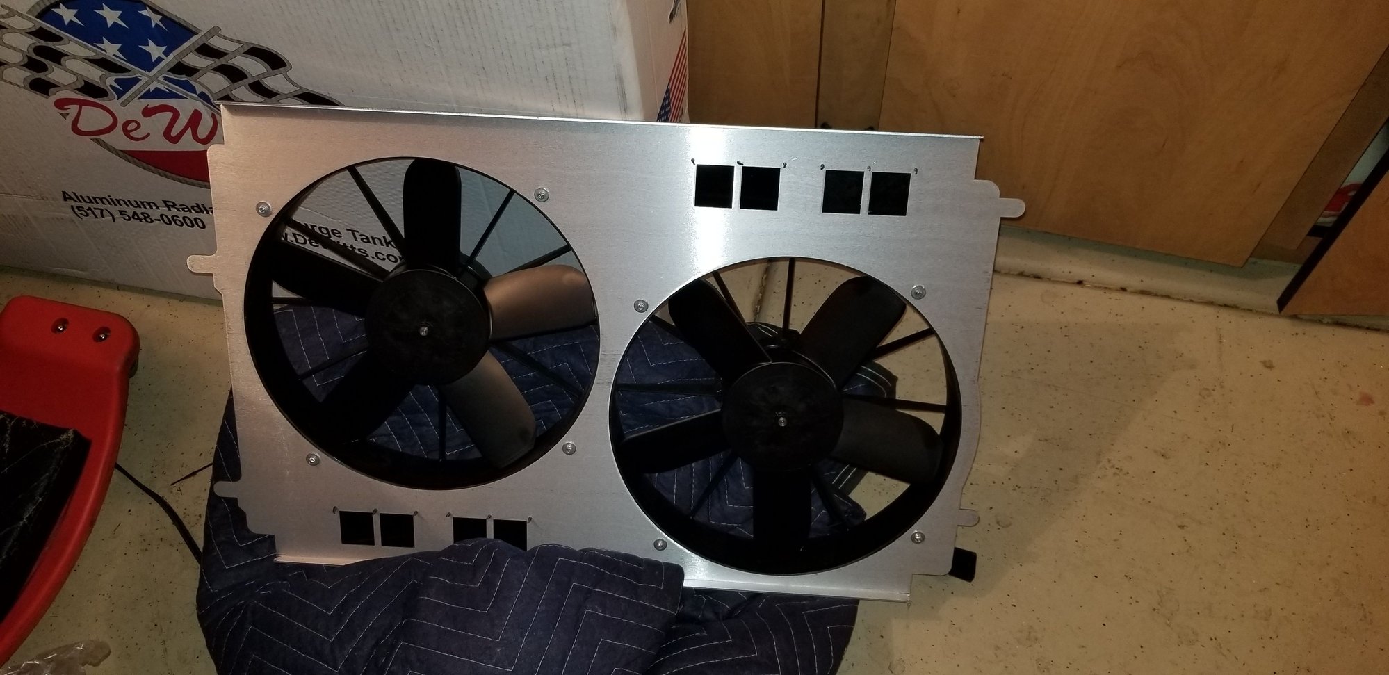

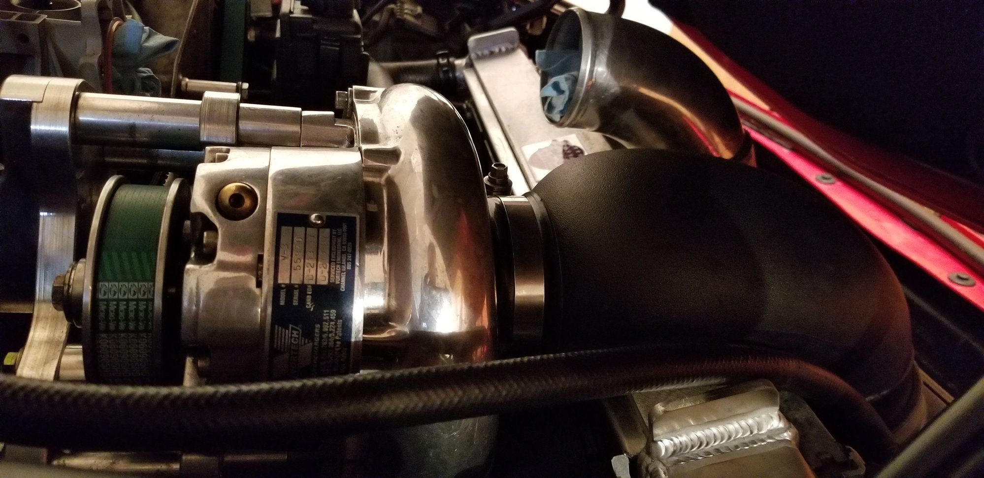

Got the fans and managed to install them and the radiator with what is likely a broken finger.
Took a puck off my glove awkwardly playing goalie tonight. Might make getting the supercharger and belt back in a little challenging.

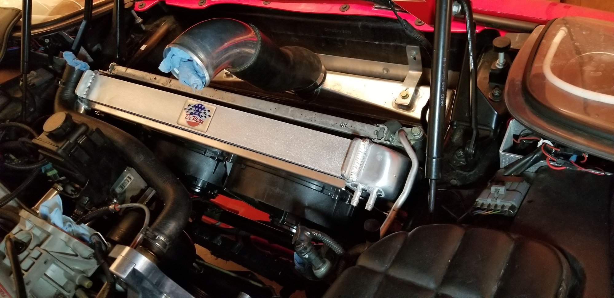

Pretty much took an act of God to get the inlet on. But it's on. Harbor freight radiator picks for the win.

Got to drive the car yesterday and saw Temps down 30-35 degrees. Only issue I'm having is the hood hits the corner of the radiator condenser. Started a new thread for that issue.
