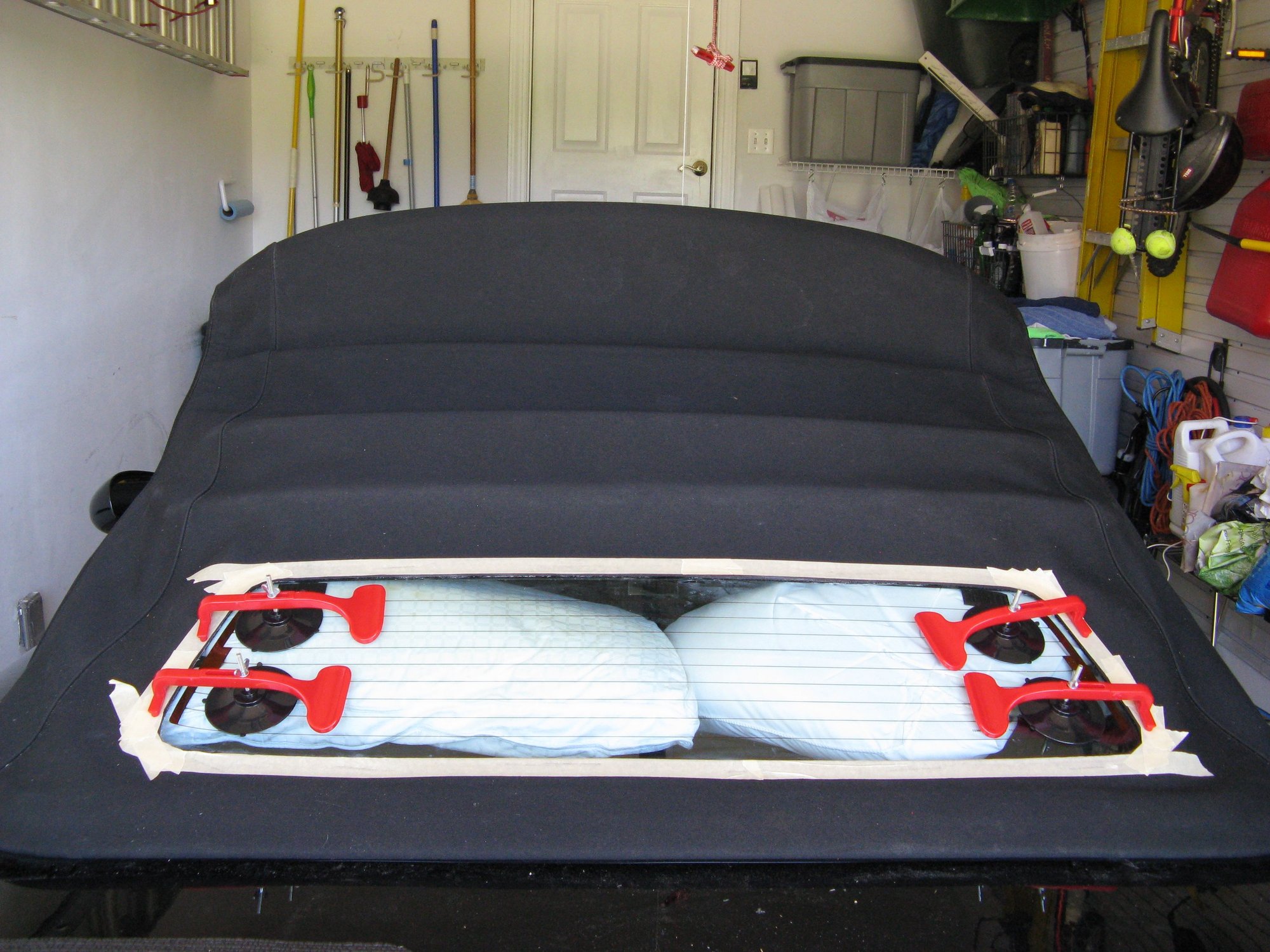

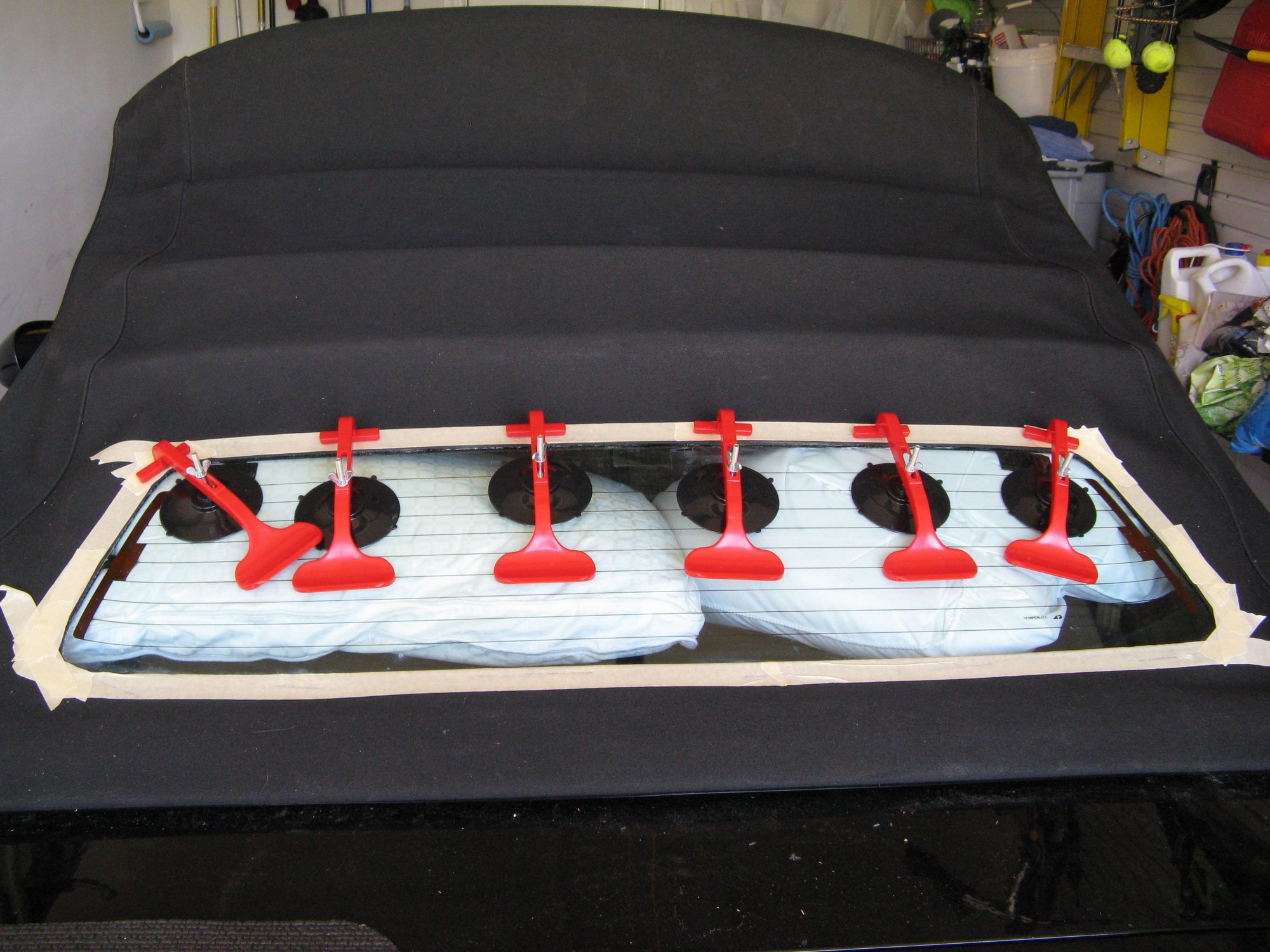

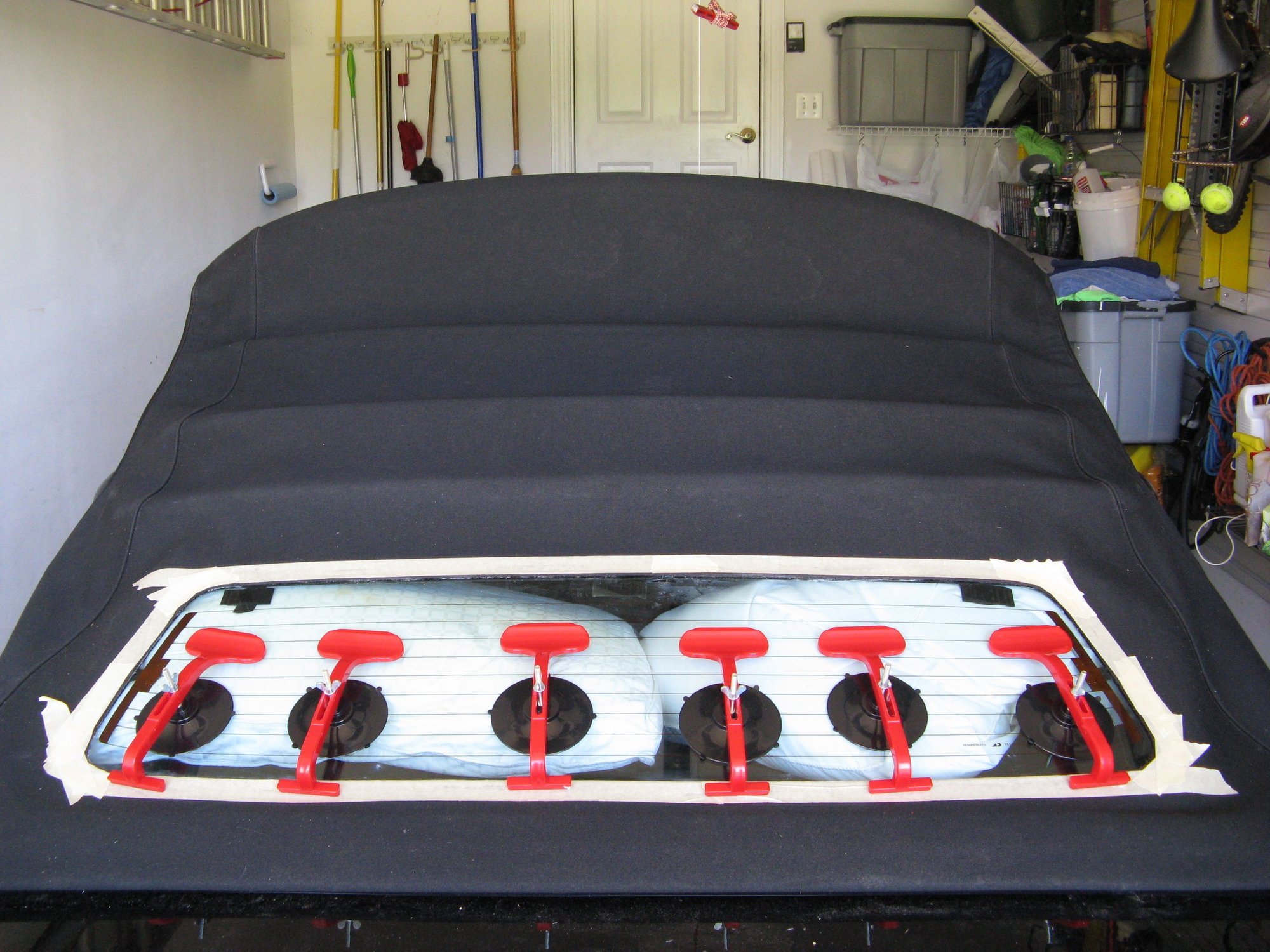

My window was partially detached. Here is what I did to fix my window last year with RINO glue. Still holding with no problems.
Bought Rhino Ultra Glue and “Universal Vacuum Clamps” (six in a box) on the Internet.
Unlatched the top to loosen the fabric. Supported the top with a piece of PVC piping. Stuffed pillows against the window from the inside.
Removed the old glue stuff from the glass using a glass scraper. Cleaned the fabric and glass with rubbing alcohol and glue remover. Masked the outside fabric as a protection against any glue run off. Glued glass top first using all 6 clamps. Clamps stayed on for 12 hours for each application.
The two sides were done next.
Last was the glass bottom.

Yes, I removed all the glue from the glass and top fabric on all sides. If some glue finally let loose, the remainder is not far behind. It is import to clean completely. Hope all goes well
