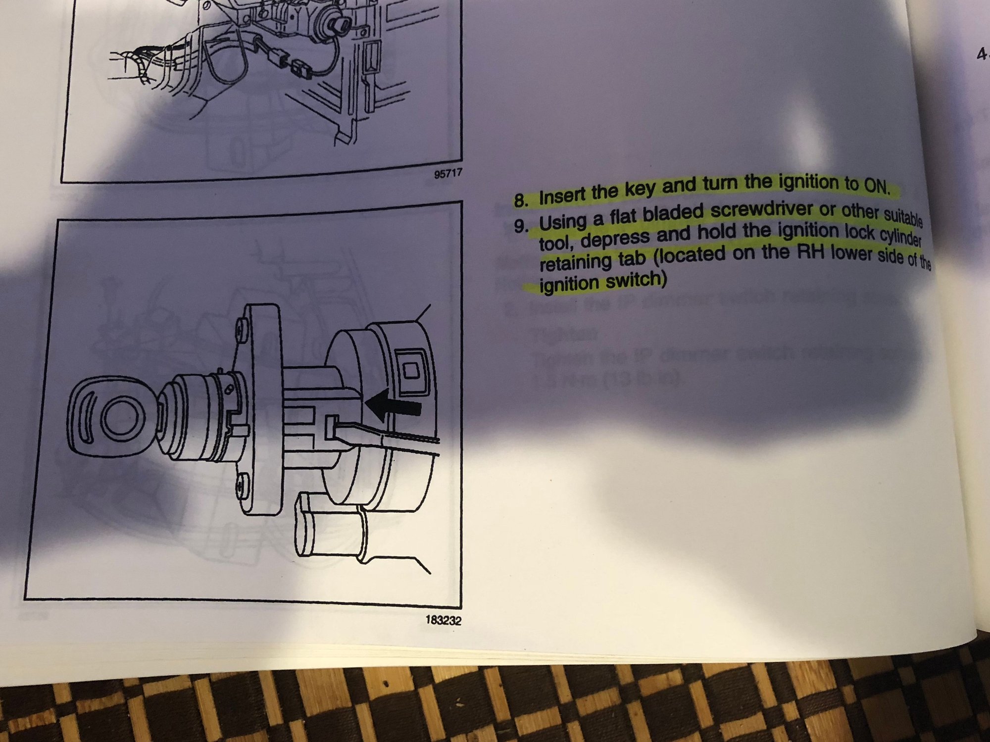

Next item is remove Ignition Switch (2 plugs - white and black) and try starting with the other switch. It was removed from my car several years ago because the 2 contacts in the front of the locking mechanism which read the keys resistor pellet were shot. The current switch has worked fine for several years. When I tried to turn the lock mechanism on the former ignition switch I replaced several years ago with the original key it wouldn't budge. I finally drilled out part of the center of just the locking mechanism and can use a flat blade screwdriver to go to the the various positions from LOCK ACC ON and START.
On the OLD switch, I CAN"T GET the LOCK CYLINDER OUT OF THE ELECTRICAL OR REAR PART OF THE SWITCH. Have posted that as a separate thread. I have tried to go to the ON position and use a small screwdriver to depress something on the cylinder where a slotted line appears at that position, but so far have not be able to remove the cylinder. IF the old ignition switch starts the car I wold like to remove the broken cylinder and put the newer working cylinder (in the ignition switch now on the car). Any ideas here on removing the broken cylinder from the alternative ignition switch would be appreciated.

Nov 5, 2018 | 11:10 AM
From ‘01 FSM !!

Dec 2, 2018 | 02:00 PM
Thanks for the picture. I found the same picture in my 1998 Corvette Service manuals but did not know it was there until i did a diligent search. I was pressing a screwdriver on the other rectangular hole 180 degrees from the smaller hole in the picture. Did successfully remove the lock cylinder. Now all I have to do is rip the car apart to get to the Ignition Switch.
