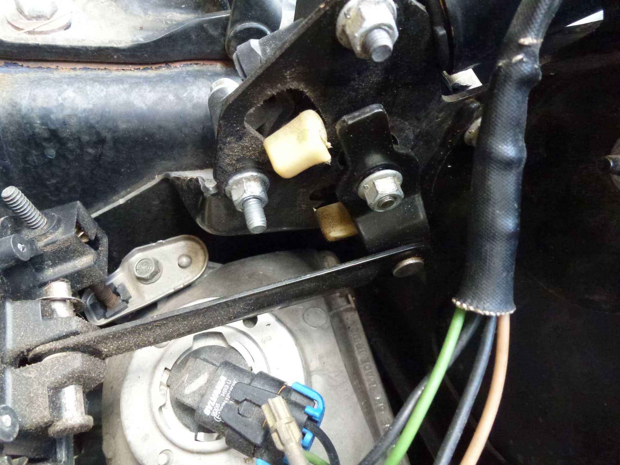

Originally Posted by 8VETTE7
Will the headlight open after you turn the manual control **** slightly?
Could be the plastic gear is history or it could be a missing or damaged close bump stop:
https://cimg2.ibsrv.net/gimg/www.cor...80fd5629b7.jpg
Yes it did go up manually after turning the **** and then made bad sound when it went back down
