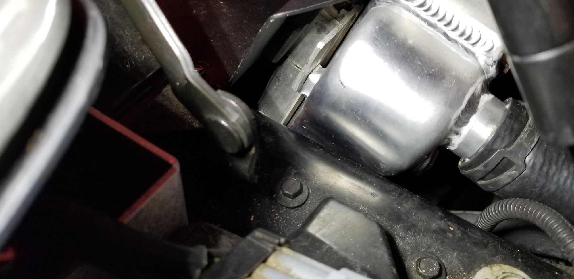

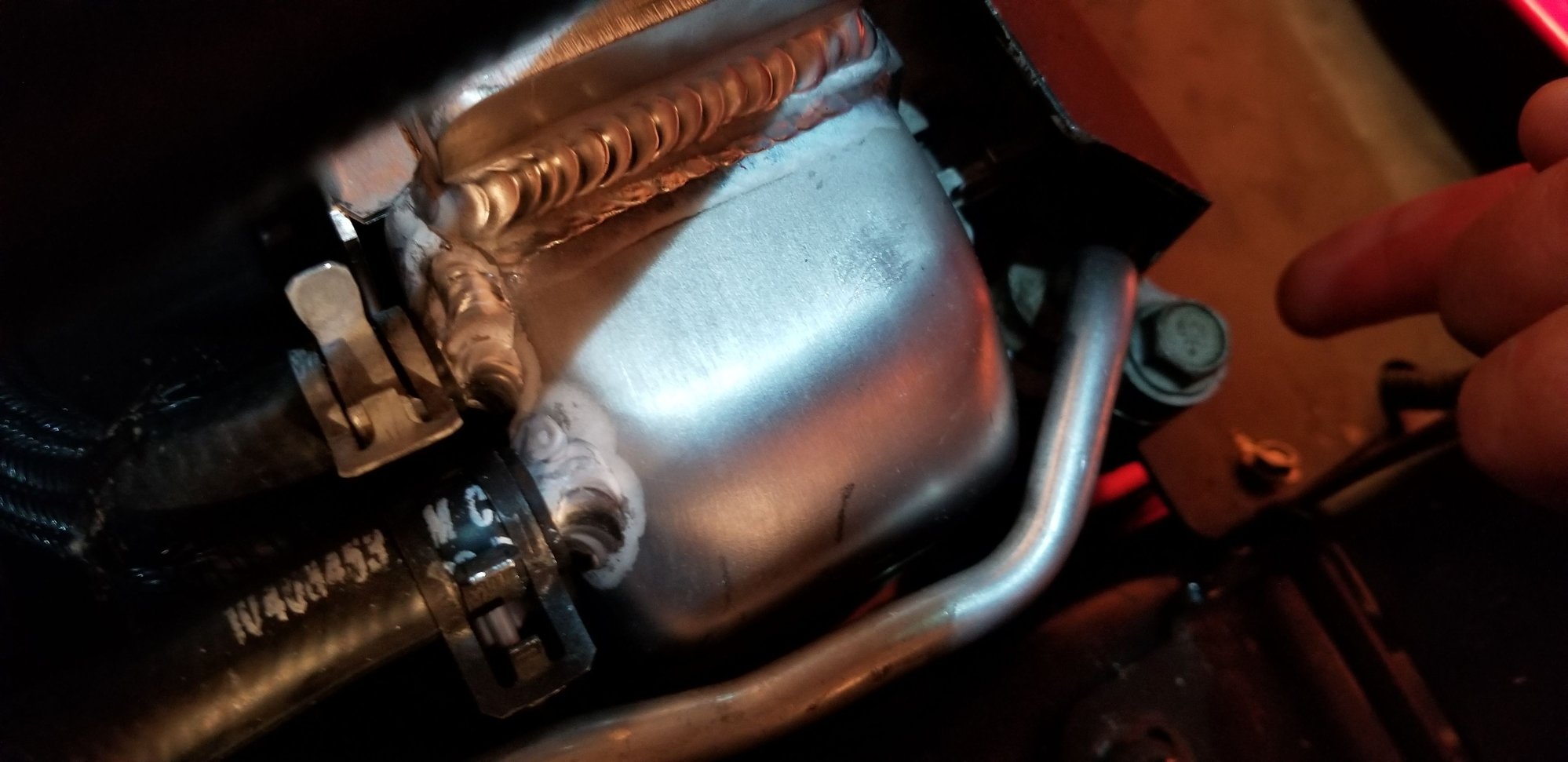

Went to close the hood after installing my dewitts radiator and spal fans and found it is kissing the **** of the ac condenser. Tried adjusting the hood and the stopper but no luck. Hood won't shut by a 1/4". The damage on the side of the hood support area was preexisting, the flat spot is new damage. Any suggestions beyond grinding a slot in the hood or enlarging the slots in the hood bracket I'm not considering? I can not move the radiator assembly any further back.

Are you sure the condenser is seated properly in the brackets on the radiator? And, are you sure the radiator is seated all the way in the radiator support? Do you still have the plastic piece that holds the radiator down? If so, try installing that and see what happens. You shouldn't need to modify anything to install a DeWitt's radiator.

I just put a dewitts radiator in mine and had that exact problem. I bought the car with a SC so have never seen a stock setup before and figured it must be a rare problem with something about my setup. I have A&A upper mounts and was able to push the radiator back a bit more and get it to fit. Why cant you push yours back any more?

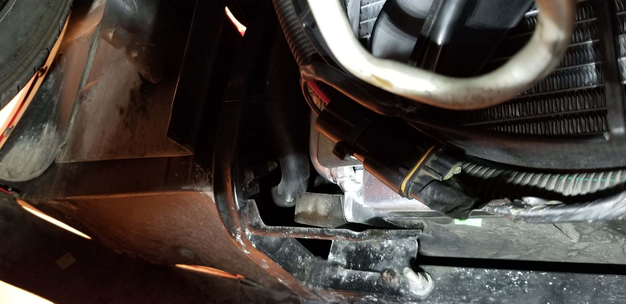

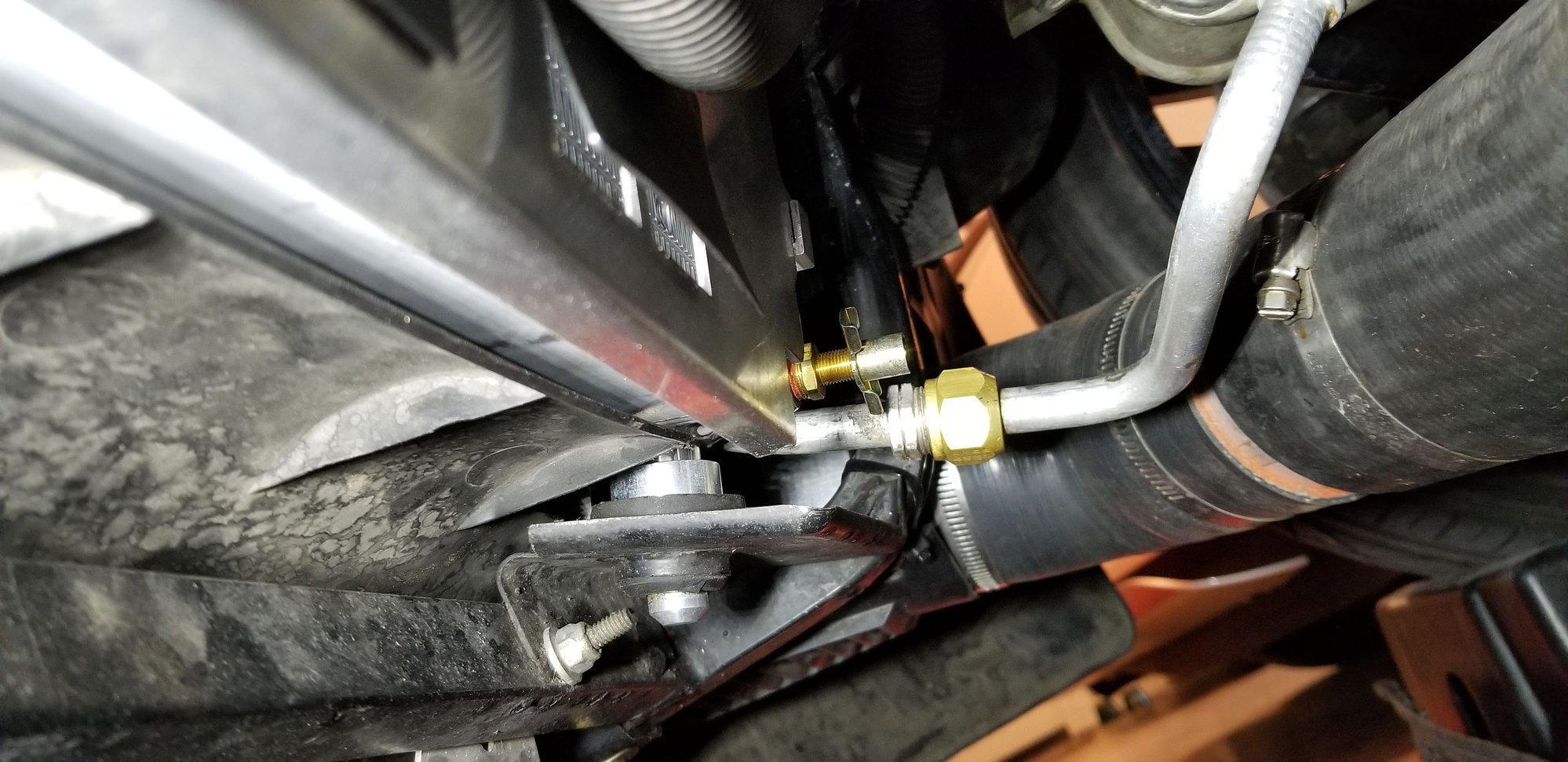

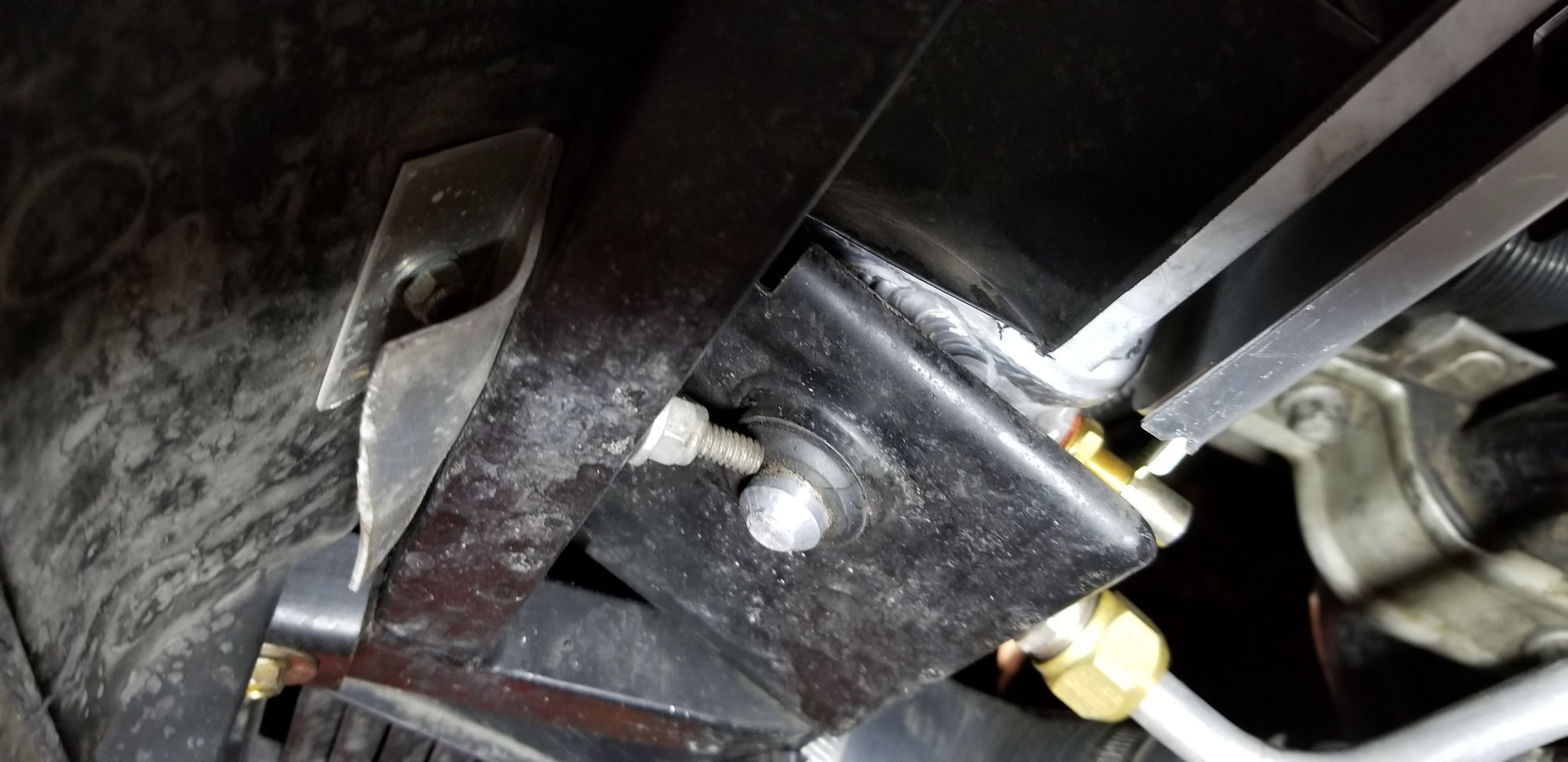

After looking under the radiator the bushing is seated around the stem, but the upper portion of the bushing is not seated on the thick piece of the stem, should it be seated higher up on the stem, I don't recall being able to push the bushing further up?
Also the radiator spacers from A&A are already installed.

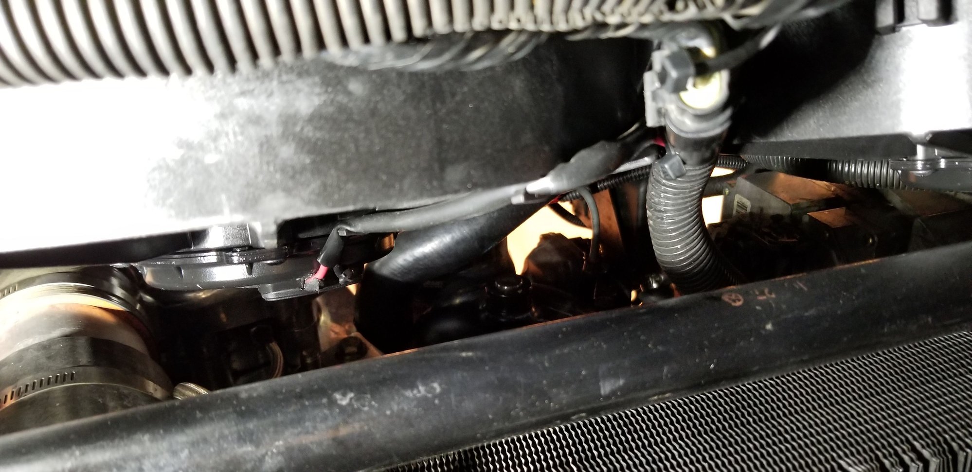

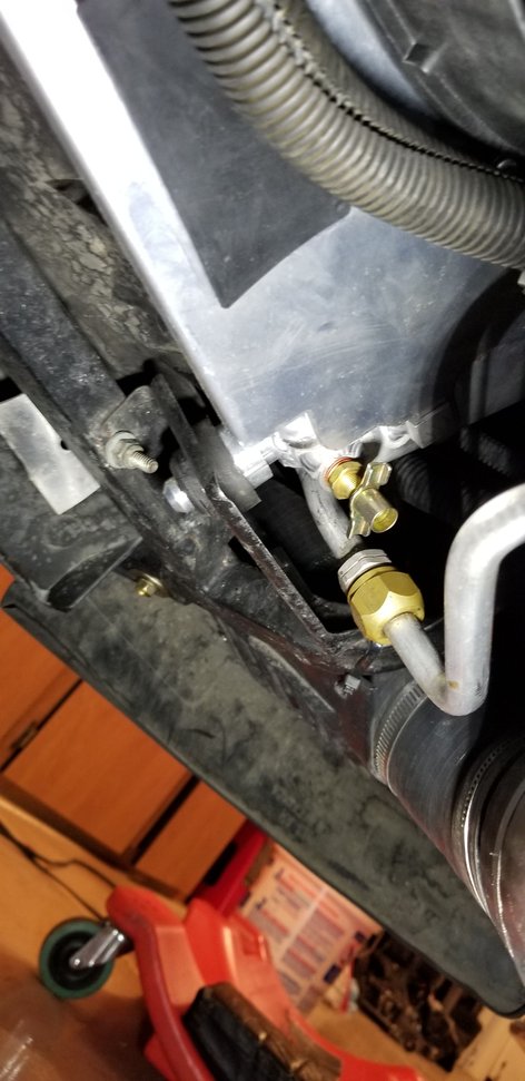

More pics for clarity.

Originally Posted by tommypenguin
After looking under the radiator the bushing is seated around the stem, but the upper portion of the bushing is not seated on the thick piece of the stem, should it be seated higher up?
That looks right
you driver side mount seems a bit off there.

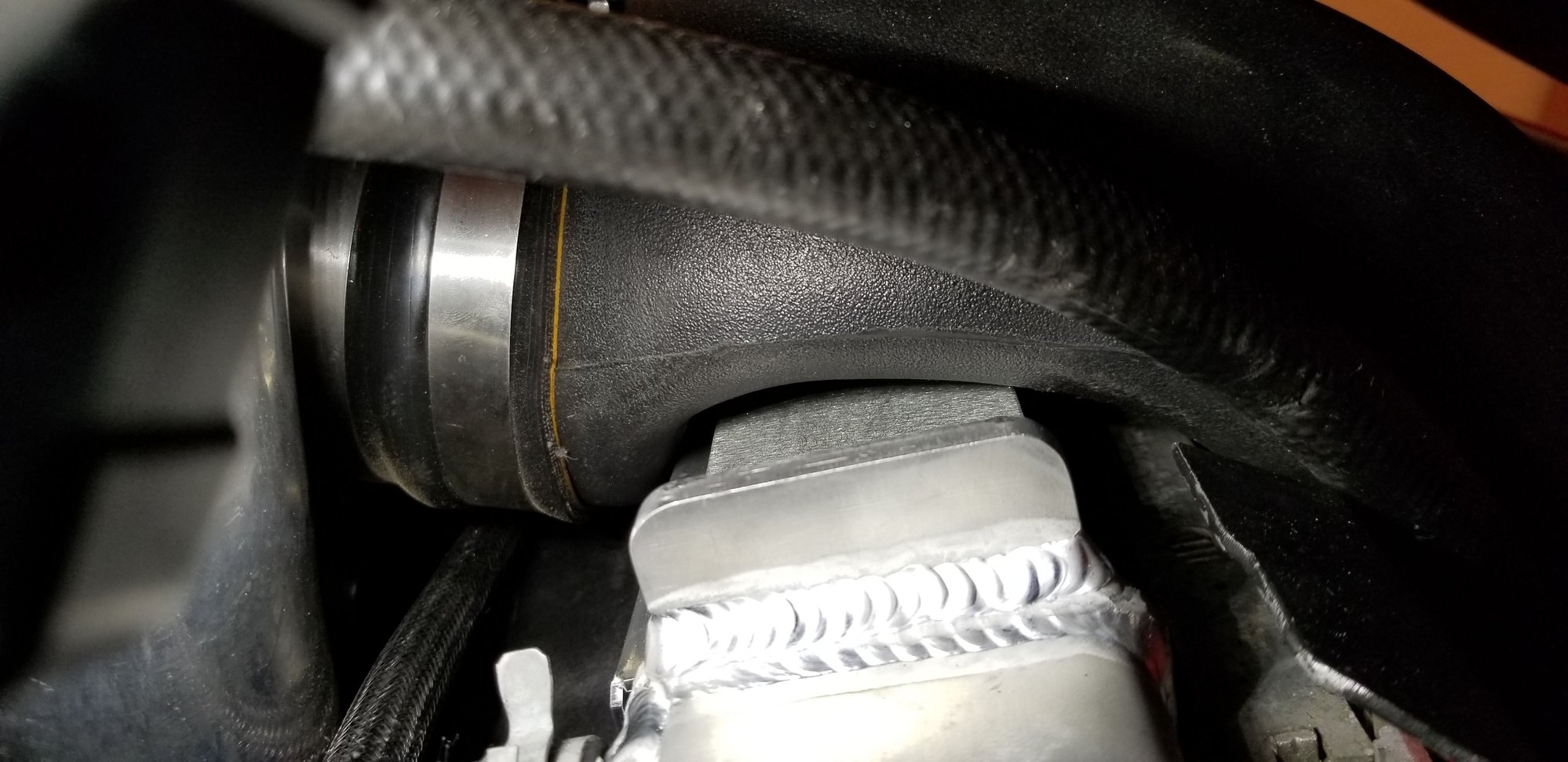

Been almost a year, still have this issue. Have spent god knows too many hours f***ing around with it.
The issue is that my supercharger inlet is pressed against the back of the dewitts radiator which pushes the radiator/ac condenser assembly too far forward by probably 1/2". I have proven this theory by pulling the supercharger inlet off and verified I can close the hood and clear the ac condenser. I have shortened the coupler as much as possible, after doing this the inlet was resting on my spal fans bracket so I trimmed that portion, got more clearance but the inlet is resting on the top of the radiator. Also called A&A and asked if the new inlet would provide better clearance thorough a more steep angle to clear the radiator and they said it would not. They said they have had to fab up lowering the radiator cradle or install a cut down version of the dewitts radiator to clear the inlet.
For kicks I have tried removing the ac condenser from it's tabs and pushing it down an inch or so where it is flush with the bottom of the radiator. In this scenario with the ac condenser lowered probably an 1 and 1/2" inches it still will hit the hood just higher up on the spot.
Really sucks, The hood pretty much shuts completely versus what it was in my original pic, probably can't completely shut by an 1/8-1/4" and constantly is making contact. Don't care about the damage to my stock hood as it's not worth much to begin with. But I want to put on a carbon fiber hood and don't want to damage it because I was not able to reconcile this issue. Any other suggestions on something I could try beyond fabrication or purchasing a cut down radiator/fans to clear the inlet?
