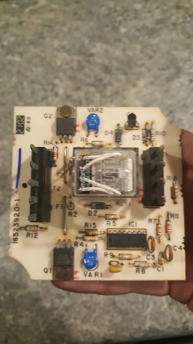

Well hell. I'm pretty sure it's the headlight control module. I replaced the headlight bulbs with stock bulbs to no effect, and that fuse I mentioned was intact.
Definite signs someone has been into the HCM though. As soon as I pulled off one of the harnesses, I noticed it was covered in dielectric grease. Cracking open the cover, I noticed part of the tar seal around the edge was improperly applied, and wasn't sealing about 3/4" of one of the sides. Surface components mostly look good, but the traces on the back of the board look terrible. Looking at the right side of the picture, you can see a wide area of corrosion that just about goes all the way across with some pop-corning of the board. (it's a little puffy and flaky there)
If my electrical skills weren't so limited, I'd try to solder a lead around it, but it looks like the corrosion is just marching its way through it at this point.
On a positive note, after cleaning the board a bit and fiddling with it, I no longer get the annoying constant door chime. I guess the malfunctioning HCM was telling my BCM that the headlights were on. I must have jogged something back into connecting.

Sorry to see it was the module after all. OTOH, if the used one you bought is fine, it was a good find
What happened to yours is not uncommon. The back seal fails and moisture/water gets in causing damage.
