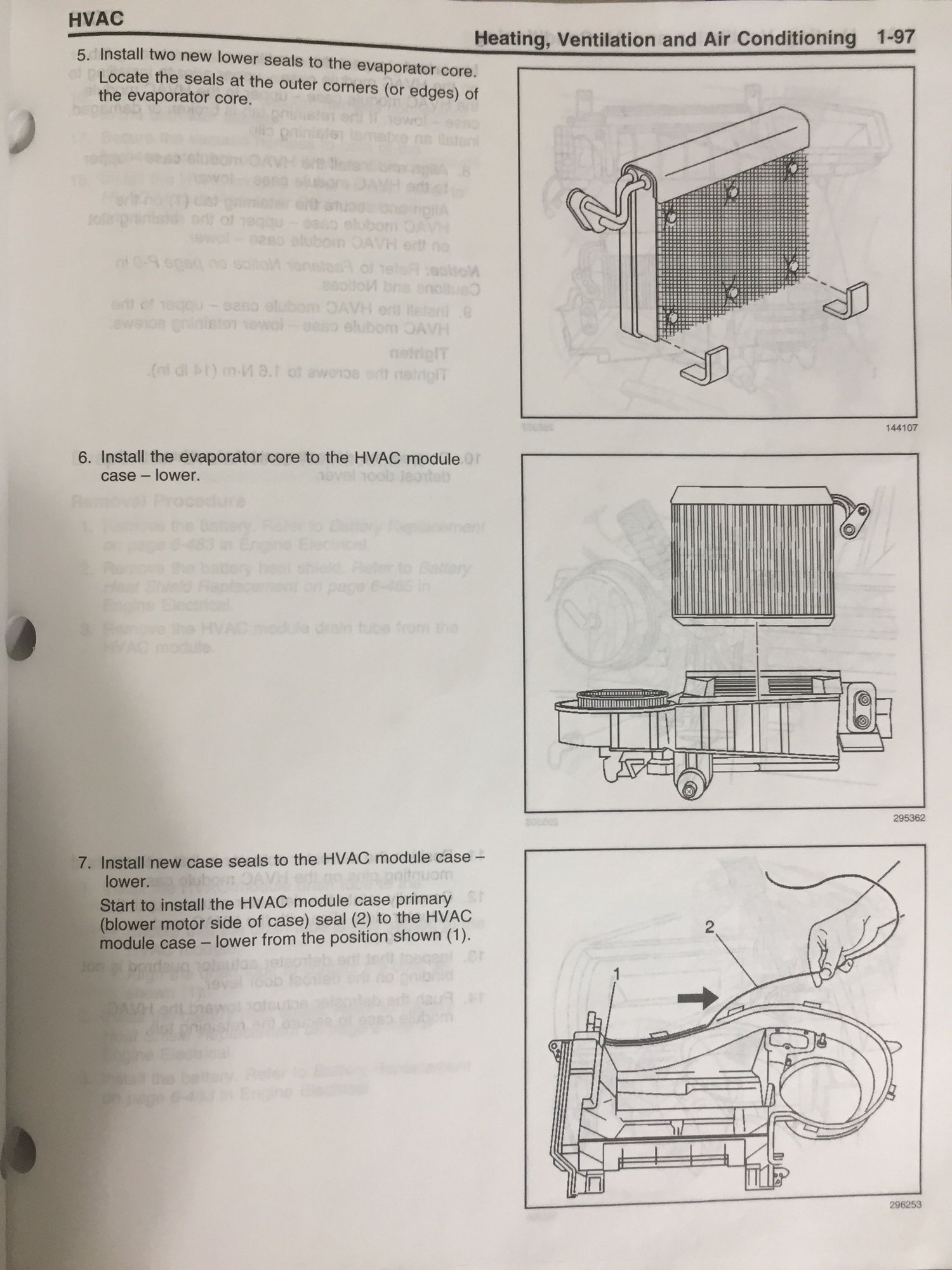

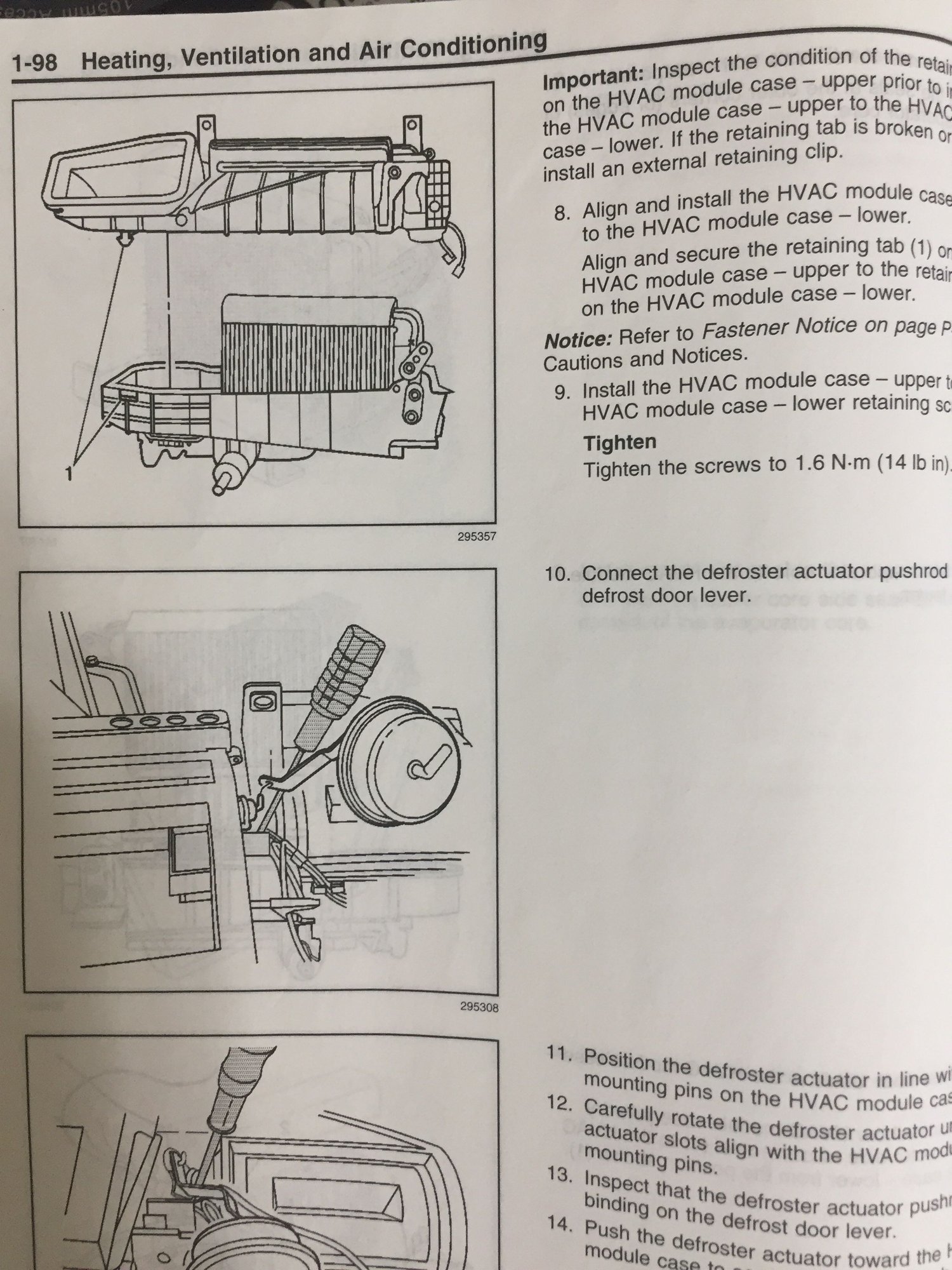

Originally Posted by 8VETTE7
The original rubber tube that turned 90 degrees down that was on the car served basically to keep small creatures from crawling into the tray the condenser sits in. You have to decide if not having the tube is a consideration for your situation or not.
I'm not sure I can get it back up in there. Talk about tight spots. I'm going to leave it off and hope for the best.
Old Jul 13, 2018 | 02:39 PM
Randryracer's Avatar
Randryracer
Joined: Feb 2018
Posts: 51
Likes: 23
From: Illinois
Here are a couple pics from the shop manual of the tray that the AC Condenser sits in:
In the first pic above the condenser is the top diagram, the condenser sitting in the tray is the center diagram. The fan squirrel cage is seen to the left pointing up and the drain for the tray is pointing straight out at the bottom center of the diagram.. The bottom diagram in the first pic shows the interior of the cavity that the condenser sits in but unfortunately they turned the diagram 180 degrees from the center one. You can however see the hole where the fan and squirrel cage mount.
2nd pic top diagram shows the cover that goes over the whole assembly.
What ever you use to push into the drain tube you need to be careful NOT to puncture the condenser. It looks as though you MIGHT be able to feel what, if anything, is blocking the drain tube by getting a small hand up through the opening where the squirrel cage mounts and feel around. Have never tried this as my hands look like a catchers mitt.......
Thanks for the diagram, now I am glad I didn't start ramming the wire in hard, just went in until it stopped. The squirrel cage accesmay be the best way, I wish I would have investigated more when I had it out to drain the water out of it.
