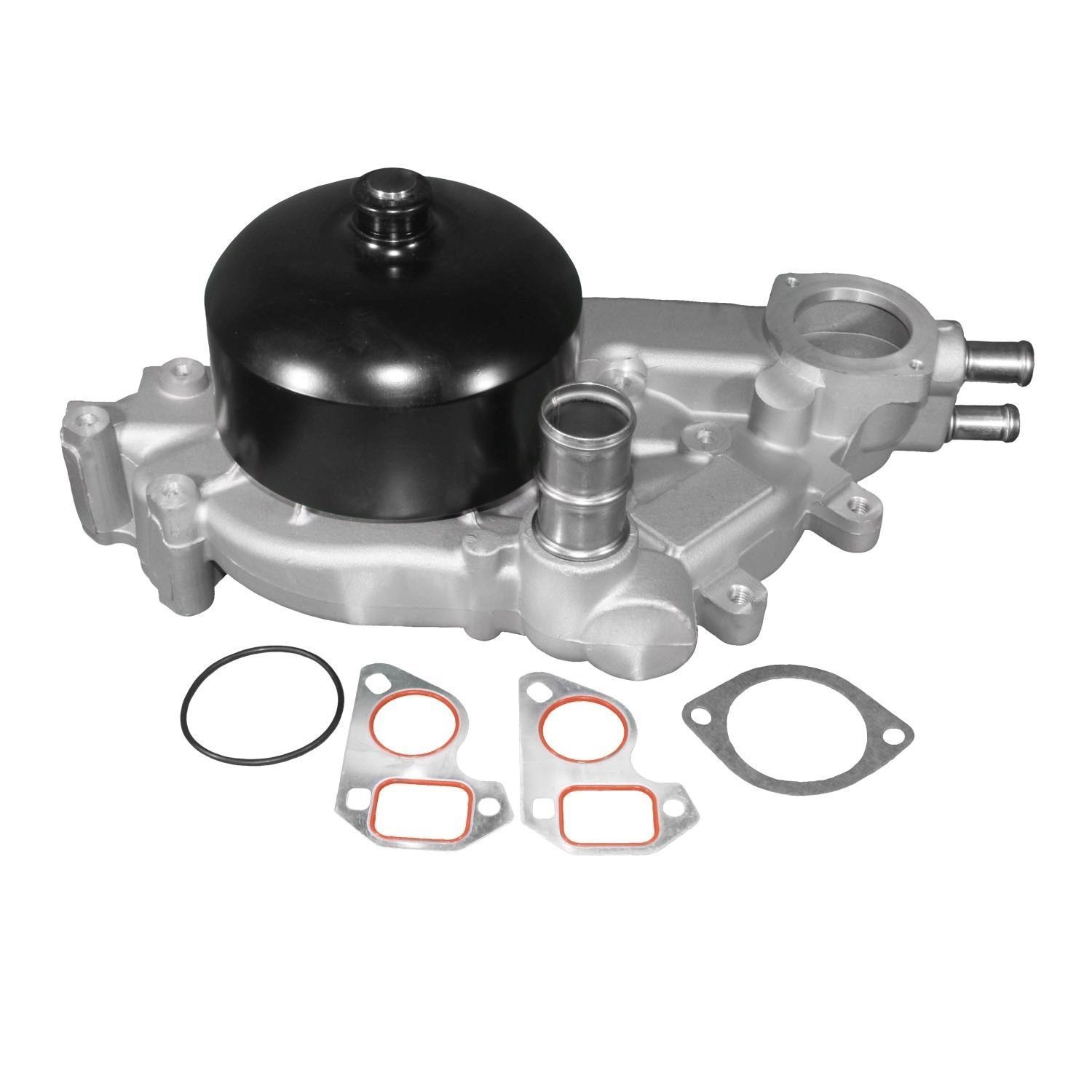

I hate to throw money that I can't really afford right now at this guessing, but this car is normally my DD & I'm forced to drive my escalade until it's fixed. And 400+ miles a week just to work & back has my dumping well over $100 in gas into it.
So I ordered a new ac delco water pump today. Hopefully that fixes it, but if not, a dual core radiator will be next. And pulling the heads will be my last resort.
That would be my bet. Good luck.

Originally Posted by 8VETTE7
If you are not already aware of the replacement C5 water pump issue here are a couple threads you might want to read through:
https://www.corvetteforum.com/forums...d-subject.html
https://www.corvetteforum.com/forums...t-opening.html
Bottom line you need to determine whether the WP on your car is the old style or the new style. Looking at the last picture in post # 5 (2nd link above) you can see that the old style pump can easily be recognized by the shape of the T'stat cover. If you have the old style and you ordered a "new" pump and not a rebuilt pump you will also need to order a new T'stat cover and new T'stat. The old cover and T'stat will NOT seal on the new style pump. The diameter of the opening in the new pump is different than that of the old style pump. Old pump opening is 2" and the new style opening is 1 7/8". NEW pumps will only be the new style. Rebuilt pumps are a crap shoot. There are plenty of the old style pumps in the rebuild stock pile so you have to look and see what the rebuilt is, old style or new style.
Thanks! I went back through the amazon reviews for this ac delco part number & it appears its the new style pump with the pressed back cover instead of bolts. But according to a few customers it can fit either thermostat style & comes with a gasket for the new style & o-ring for the old style. Part number is 252-846. I'll find out for sure when it get's here & if it does have to have the new style thermostat, I'll pull the one off my LS swapped Nissan in storage.
Either way, this one was ridiculously cheaper than the $139 for 01 pump at autozone & $200+ for 04 model pump!
The new style T'stat and T'stat cover DO NOT need a gasket to seal. The new Style T'stat comes with a rubber seal on the T'stat.
Again reference the top two pictures in post #5 of this thread:
Good luck getting the system to seal if you use the old style T'stat cover and old style T'stat with this new style pump body. Several threads about those sealing issues on the Forum.
Ok, I see what you are saying. Thermostat seal on new vs o-ring for the old style on the housing itself. Looking at the picture of the new water pump. I wonder why it has the gasket on the bottom right? Do I not need to use it?

Got the new water pump on. It seems to have solved the problem. This new water pump DOES work with both the old style & new style thermostats. It even came with instructions for using either one. So this water pump is a great solution for anyone wanting a genuine acdelco.
