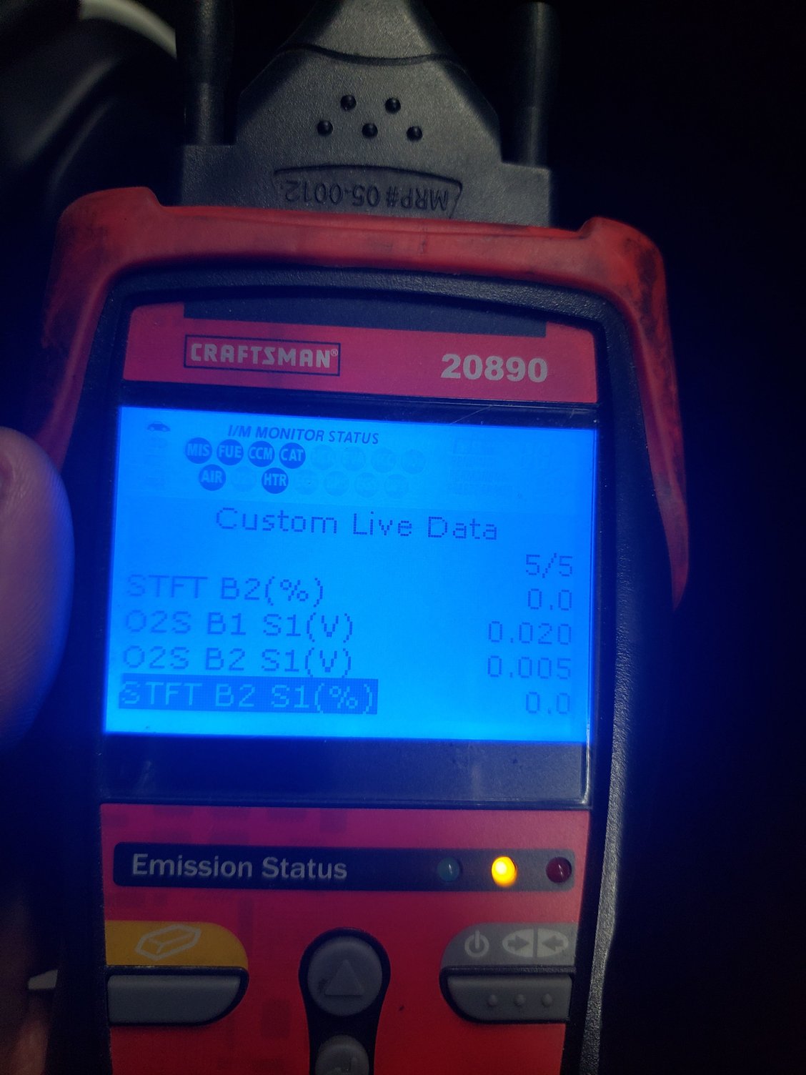

I want to thank you again for helping me out... so on a cold start the sensors are reading .005 I believe. I have the video and when revved on a cold start go to 1.0xx .9 is the highest it should be if I can remember right, here is the video after reaching operating temp.
https://youtu.be/FFZAnJooCrc

Originally Posted by rwobs777
Did you buy OEM O2 sensors ??... if not it’s most likely a bad sensor...try that test and create a vacuum leak...if that sensor still remains high (900 Mv) the sensor is not responding to a lean condition...with your scan tool connected do you read anywhere from 350-550 millivolts..(engine cold) on the O2 sensors ??...GM have a bias voltage and the PCM sends out about 450 MV to monitor the sensor circuit but the FSM says from 350-550 is good. Let’s do the “O2 response test” and we will go from there
that's the cold start numbers
Is this just KOEO ??...key on engine off ??...looks like you have 30 and 25 millivolts there !!...should be higher but I don't know how accurate your scan tool is !!
I tested on right before on an oldsmobile and read .450 engine cold key on engine off

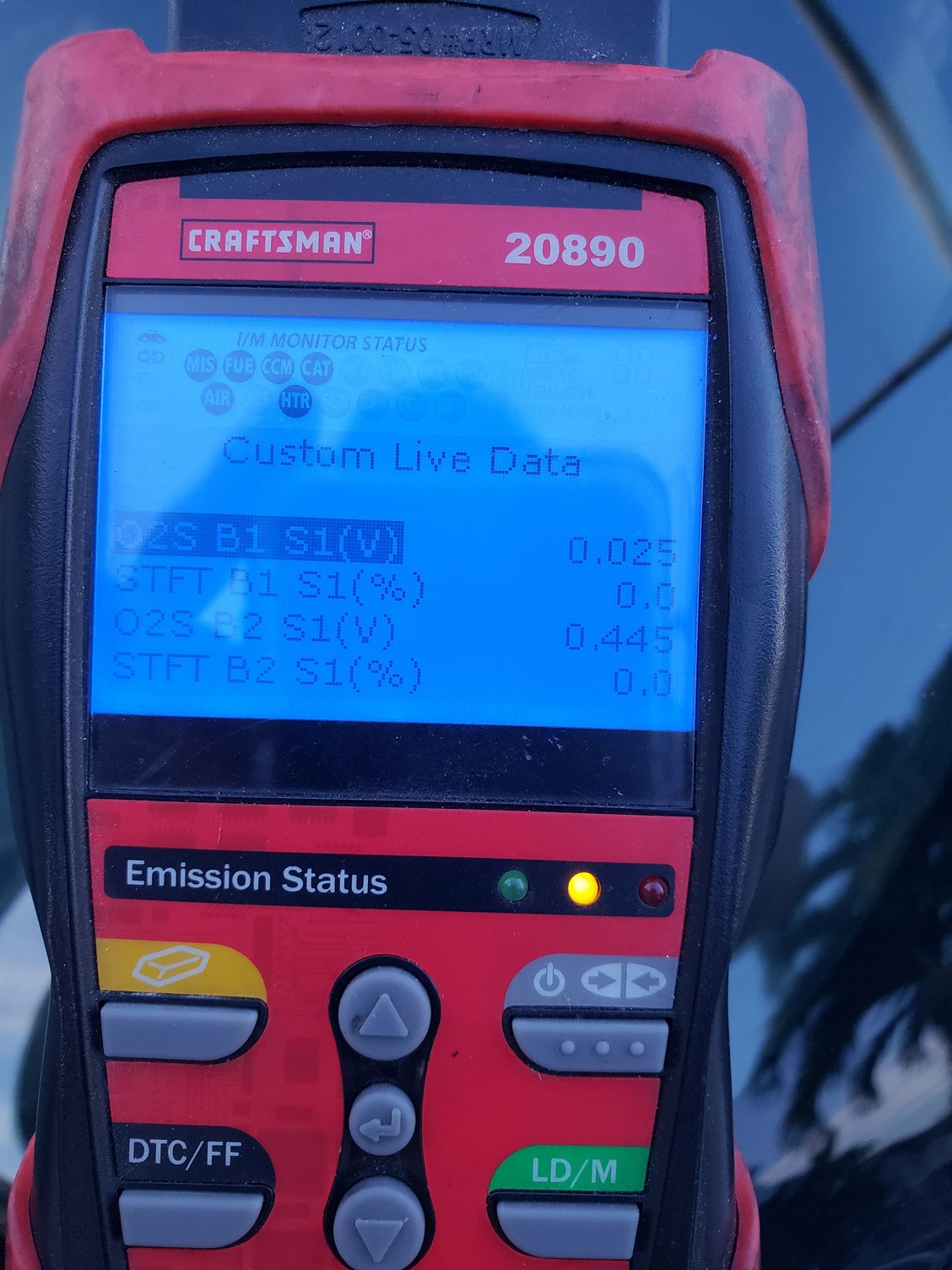

If the O2 switches between between .200-.800 Mv that’s perfect !!..,no need to disconnect the harness !!
so I went ahead and disconnected the 02 sensor passanger side anyways and when I did the voltage went up to .450 soon as I connect it starts slowly dropping back down to .005 even .000
Old Jul 16, 2018 | 09:06 PM
C5 Diag's Avatar
C5 Diag
Moderator, Tech Contributor
Posts: 15,627
Likes: 4,071
From: Cape Coral, Florida
Can you try it with a multimeter instead of your scan tool ??...how long does it take to drop down ??. When I checked mine I checked the voltage got my reading and removed the test leads. Like I said if your driving and the O2 are switching between .200-.800 Mv that's normal operation !!...the only reason I can see it dropping is because you are measuring such LOW voltages that the normally high impedance of the meters drag the voltage down. The perfect mutimeter would have 0 impedance meaning it will draw no current from the circuit that is being tested. The more current a voltmeter draws from a circuit under load the more the measured voltage will decrease. That is the only thing I can think of !!...Maybe someone can chime in !!
