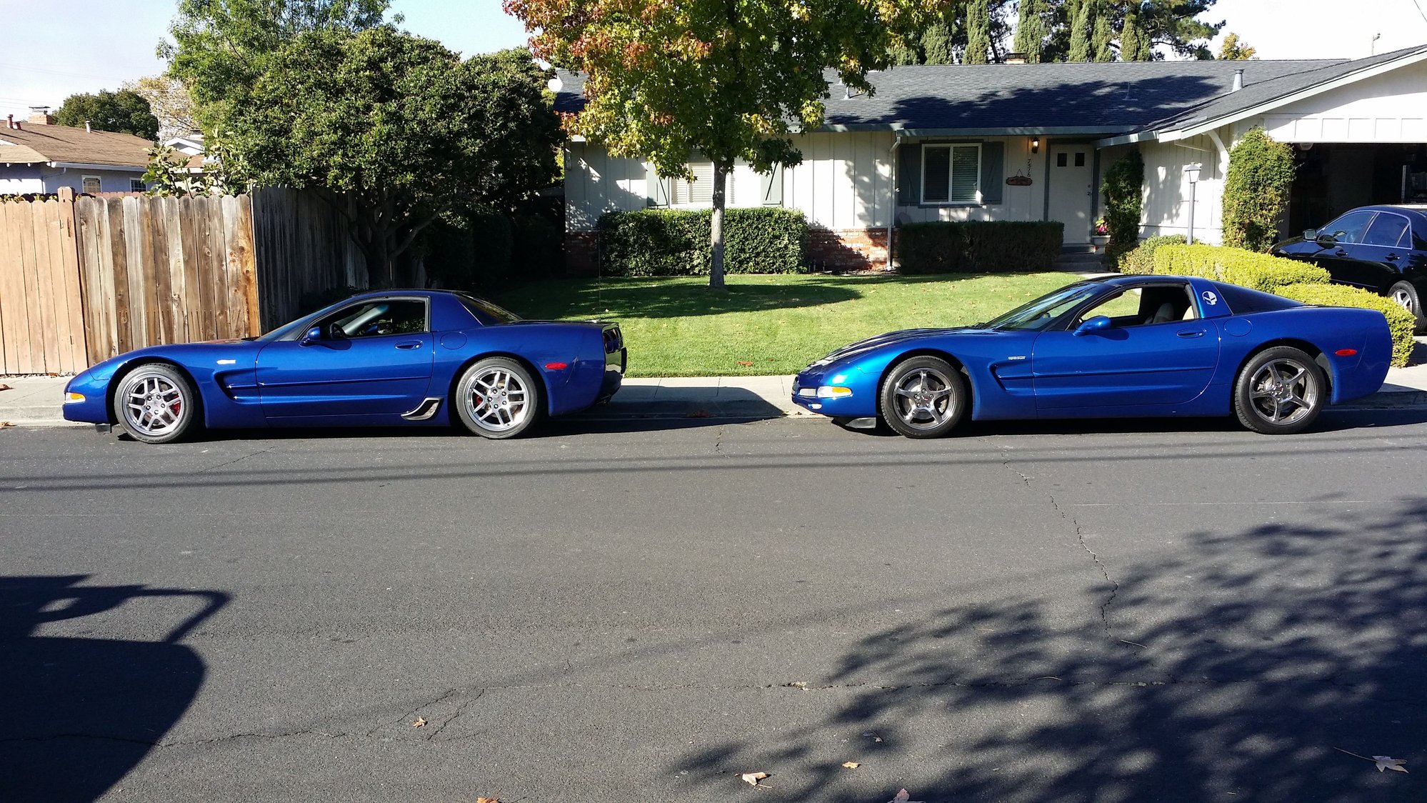

This is the coupe with the Z06 while I had the 2. Had to sell the coupe but needed this pic first, lol. Would have never thought I would have 2 beautiful Vettes at the same time!

AFAIK the coupe and vert had 51/49, the FRC/Z had 53/47 (the coupe and vert being heavier, I'm guessing apart from the glass and hood of the CE, the bigger reduced glass weight and Ti exhaust are both out back, and probably account for the majority).
The 10# reduced weight on the CE hood would unlikely calculate to a percentage point.
The 04 shocks were better, but aside from the 10# hood loss, the 04Z and CE had identical everything mechanical.
The valve spring failure rate on the 01 and 04 was very low, the 02 and 03 were the main problem years. I bought the gamut for my 04Z years ago... dusty box of goods.
Seeing your pic really confirms my preference for the FRC/Z body.

Your right, That FRC Body is just sexy and so unique. And your right, I forgot about lighter the glass. When I got mine, I asked someone "what's with the antenna in the back? My couple didn't have an antenna?" and apparently, the reason is, they couldn't put the antenna in the thinner glass. Anyway, Thanks
