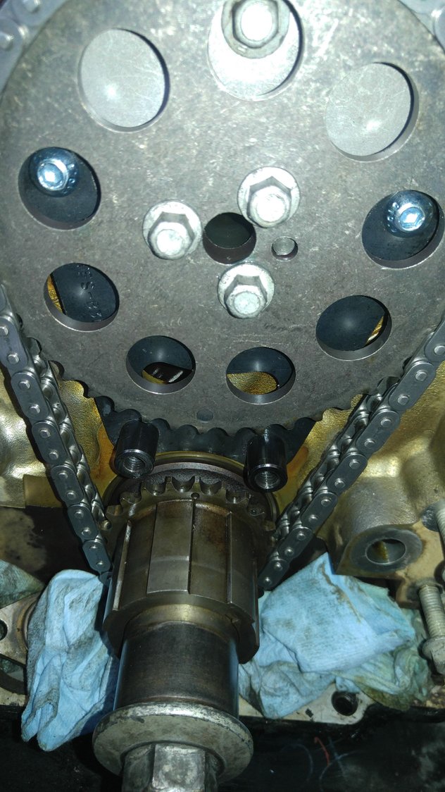

Okay I line the dots of the crank at 12 and the cam sprocket at 6 when I rotate 360 Degrees the crank is at 12 and the cam sprocket is at 12 when I rotate another 360 Degrees the cam sprocket is at 6 and the crank is at 12. This apprears to be correct but I'm not a 100% clear whether I'm on the compression stroke or not. Does this sound correct???

The camshaft position dictates that. You are good.

as long as those 2 dots match up (which they are in your pic) you are good to go
