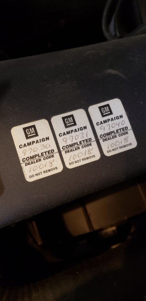

You will note that I have never had the steering column actually lock the wheel in my car in any way, shape or form. I do have recall stickers from GM mounted on the fan shroud, but have never had the ability to find a source for the "Recall Campaign Numbers" visible on the stickers. I have no decode for the numbers.
I am unclear if anyone has ever been at the steering column lock issue in the car; I thought they were because the wheel has never locked.

Here are my recall codes:
