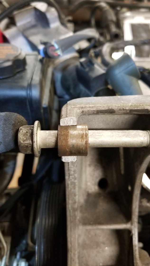

​​​​​​I'm in the process of installing XS power headers. These are version 3 and look to be nice pieces.
I started to follow the how to on LS1howto on an LG Motorsports header install. That worked well for taking the car apart, but getting the headers back in seems to be a struggle.
On the passenger side, I have unbolted the motor mount and jacked it up as much as possible. The header seems to get stuck.
On the driver side I did the same process, but couldn't get it all the way down. I tried from bottom and top. I removed the valve cover which made 0 difference. In the process I broke the oil temp sensor in the process.
In the process the headers ceramic coating is started to scratched up.
​​​​​Worst part is this piece broke in the process of me trying to flex the motor a little bit more. Is this fixable?

looks like you will need another alternator bracket

I just installed Speed Engineering headers. Went in from the bottom. I did take the starter off and did insulate. You need a new alternator bracket.

New alternator bracket, NOOOOOOOOOOOO. How big of a job is that?

I went through this a few years ago. XS headers are nice but they were a bit painful to install. Luckily did not break anything. As others stated, you will need new bracket.

I finally got the headers in. On the driver side I did need to cut that little nub off the oil pan. That made it so I could tryand get the header further up. Then from the top I had to pull really hard. I didn't bend anything. It will really help to have 2 people to do this job. One from the bottom pushing and another from the top to help guide and pull the header up.
Passenger side I went in from the top. That seemed to get in there, but I did have to bend the AC line a bit out of the way. The starter DID NOT have to be dropped.
