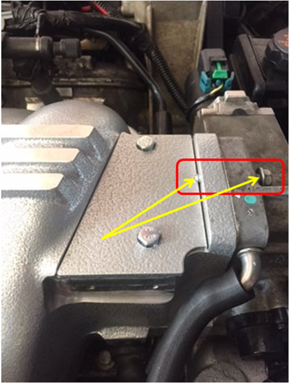

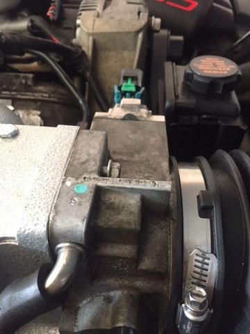

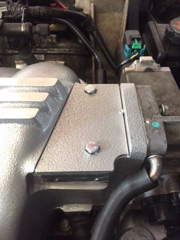

Thanks for the responses guys. Here are some pictures, note the missing bolts. I literally received nothing that could fit these holes. I was able to find at lowes a close match for the two topmost bolts and that extra piece I am referring to, but not the side bolts. Could the lack of the side bolts be causing me my issues? (Note, in one of the pictures it shows one of the intake manifold bolts missing, yes that bolt has been placed and fastened. This particular picture was taken prior to completing the task.) Also, the topmost bolt to connect the throttlebody cannot be secured entirely due to the height of the new plate at the end of the intake manifold, the end of the screw pushes it. Can be seen in pictures. I called BBK and they assured me they would send a new hardware kit, but I fear the worst in that it won't include the correct bolts. Seems really messed up to me they would refer to bolts that aren't actually included in the package.
It depends on if those holes are blind or not. If they're going clean through that intake, then it's possible that they're introducing enough of a vacuum leak to keep you from idling. Can you just plug them up and see if it'll crank up and idle? Also, can you keep it running by giving it a little pedal?

Update, I have retraced my steps and pulled codes and there are no codes with a C but plenty with an H. So nothing learned there. I plugged the two holes on the side of the throttlebody, and the engine will idle, but I get an odor that I can't really describe, and legitimate knocking/popping sound. I have checked my spark plug wires and all fuel injectors, coolant lines, and etc. It will idle, and crank when I give it a little gas, but it sounds extremely painful and I fear for my engines health. No more leaking coolant however. I believe I fixed that issue. Frustration level is rising so I'm thinking it's getting close to opening up the old checkbook and calling a tow truck and having it moved to a garage, and spending the $400 or however much it costs to redo everything I've done.

You need to find a shorter bolt for here (yellow arrows) or at least stack a few washers under the head of the bolt to be able to tighten it up one last time before removing everything.
If the throttle body is not tight, it could be one source of your problem.
Good luck... GUSTO
